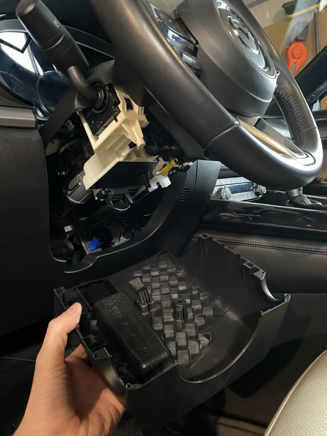

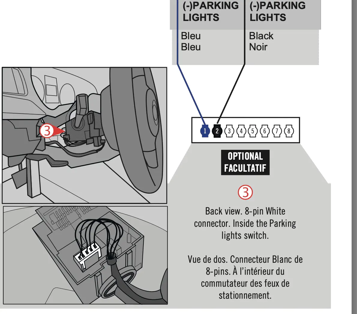

I noticed that the running lights no longer run on the car (during the day time - obviously the auto light setting still kicks the actual lights on during the night time). I get that running lights during the day isn't that big of a deal to some people, but I still like the idea of having them as an additional safety feature, plus I just like the car to be working as it was designed too from the factory and hate the idea of taking away factory designed a feature just to add an aftermarket one). Additionally I sometimes drive on stretches of highway/roads that require daytime driving lights on.
From looking at several different posts, I notice most people don't connect the additional parking light wires because its not plug and play (includes splicing) or because they just don't care if they have the feature or not.
I'm assuming to the get the daytime "running" lights working, I would need to install the wires that are indicated as needing to be installed for the "parking" lights? The instructions call them wires for parking lights but wanted to make sure these would be the same for the daytime running lights.
If so, is there anybody (who did install these additional wires) that can provide any additional detail/instructions, or a video they can link to? I'm always a little cautious when it comes to messing with a vehicle's electrical system such as by splicing wires (as compared to just plug and play) so was just wondering before I started cutting wires and messing something up. I looked at the instructions (page 4 from the fortin PDF linked above) and it looks pretty straight forward but then again the instructions overall kind of suck so just wondering if there is anything else out there I can check or if anybody who did install these parking light wires can chime in?
According to those instructions, the wire/harness that you splice into for the parking lights is just to the left and below of the light/blinker control stick, but when looking at a picture I look (Attached - IMG_7963.jpg), I am not seeing any harness in that area (the steering wheel column is now back together on my car so I am using the picture as reference). Is it there and I'm just not seeing it in the photo or is there more I need to do to access it?
Thank you in advance for any help anybody can provide!
Edit - I see above that @Candurin (in response to somebody else asking about the running lights not working either and having to splice) says the lights will work, but I have checked and the running lights do NOT work during the daytime. (again, auto setting turns on the lights at night but there are no running lights during the day). @Candurin if your running lights do still work during the day on the car w/o splicing, then why aren't mine? Does that mean something from the install didn't go right?

I have to eat some crow. My “DRL” lights come on because I have an aftermarket set installed in-line with my turn signals that effectively act as switchbacks. Those lights are on when I remote start the car, NOT the headlights/OEM DRLs.
Keep in mind the splicing has no affect on the DRL features of the lights. The splicing is only for diagnostic features of the EVO ONE itself (I.e lights will blink a specific number of times to indicate an error).
On the CX-5 and CX-9, the DRLs do not come on until you shift from park. Therefore the DRLs will not activate when you remote start as the car will be in park.
I did the light splicing on my CX-5 but did not do it on my wife’s CX-9 and both cars behave identically.
If you leave the light switch on auto, the lights will come on if it is darn enough for the sensor to warrant them (night time, garage, etc).
You could install switchback turn signal bulbs and those would be illuminated when you start the car, even in park.
Sorry for any confusion!
