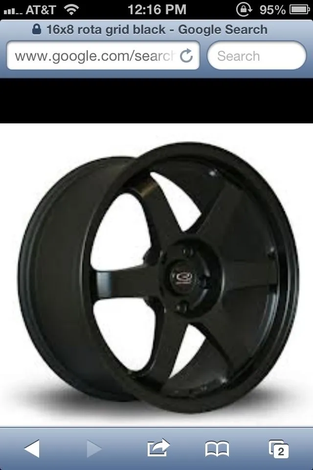

So do the Rota Grids, for 16x8, only come in +10? Or are there other options?
No they come in 0 10 20 and 40. But I want an concave wheel. So 40 is out. I think I'm gonna roll 20. Font is gonna hook me up.
When I'm finished this setup is gonna look good.

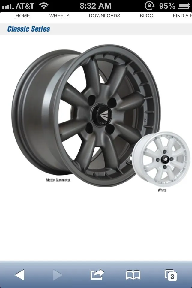

New candidate. It's one of these two. Grid is 16x8 20.
Enkei is 16x8 25.
