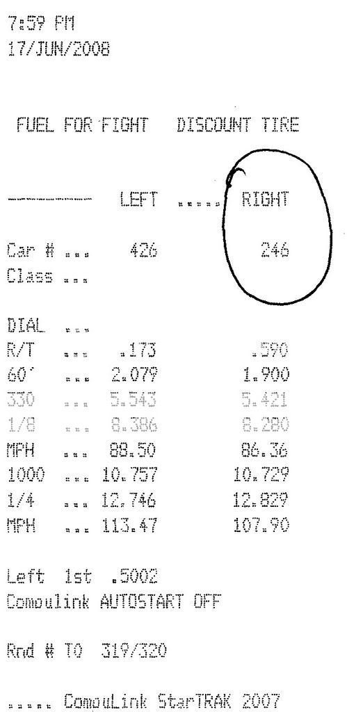

ok my man add me to the 12 second club !! i think there is more left in it too. i'm just working out the kinks on the slicks. ohh and this was only 18-19psi !! and i am also still on a stock IC !!
mods ....... I/TBE/manifold/T/CDFP/MM/
MBC 19psi/SL
this was my fastest pass. i did have a few with better 60ft times but the ET's were slightly slower.
MBC 19psi/SL

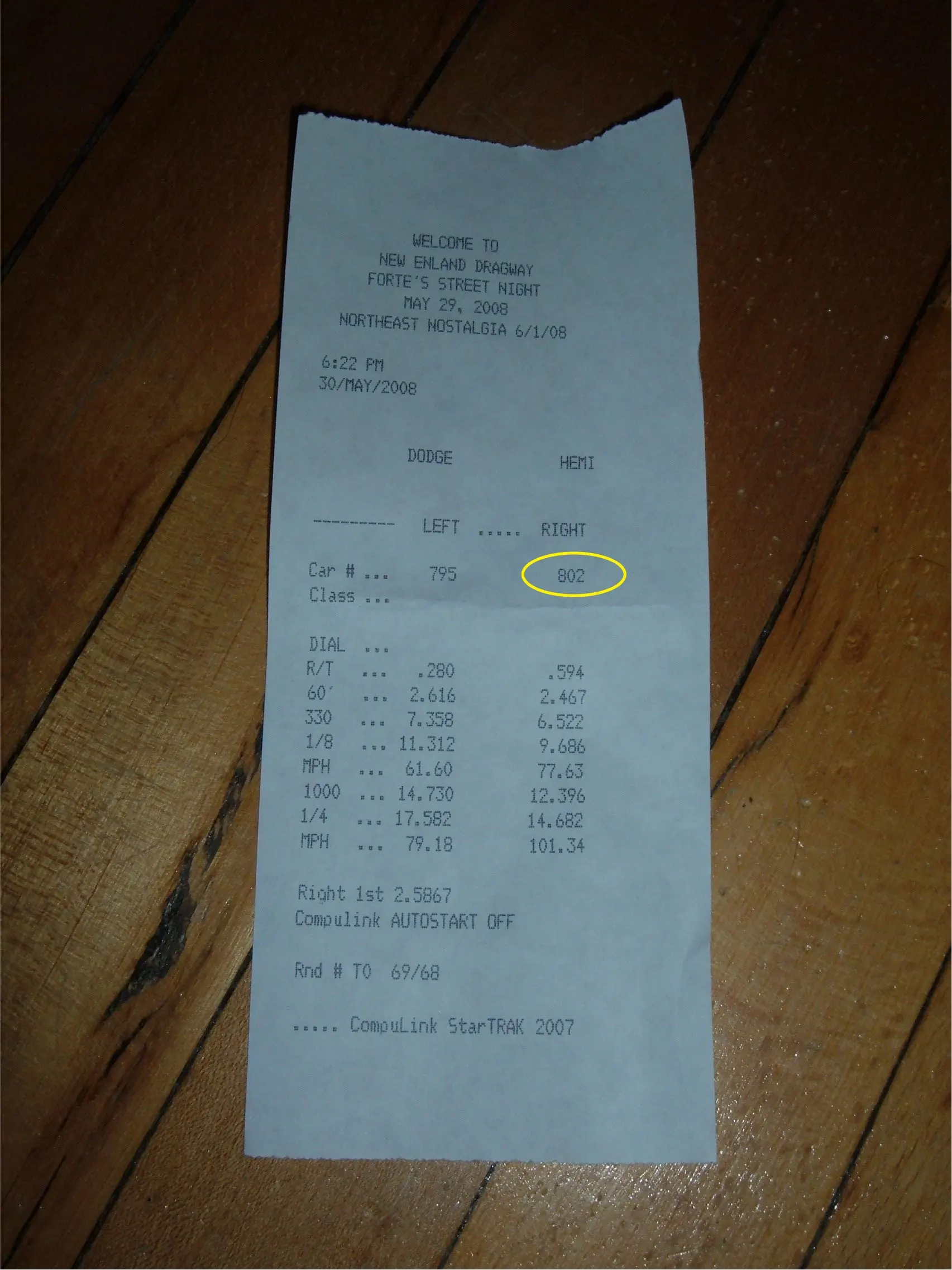

Slip Supplied!
Repeat with Verifications, hope you can read it.
08 MS3
MSCAI,MSCBE
Greatlaks Dragaway
2.15
8.89
83.41
13.63
105.48
ms3077 was banned for various reasons, not important anymore
as for this thread, I will gladly take it over and update the OP when new slips are added. happy racing everyone :)
