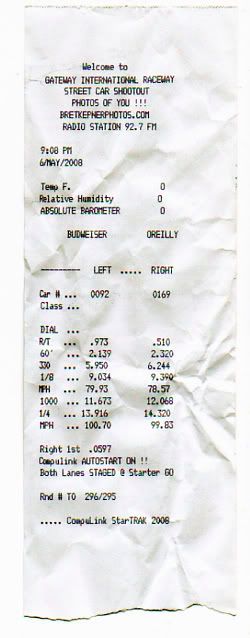

here is myn car is all stock
2.13 9.034@79.93 13.91@100.70

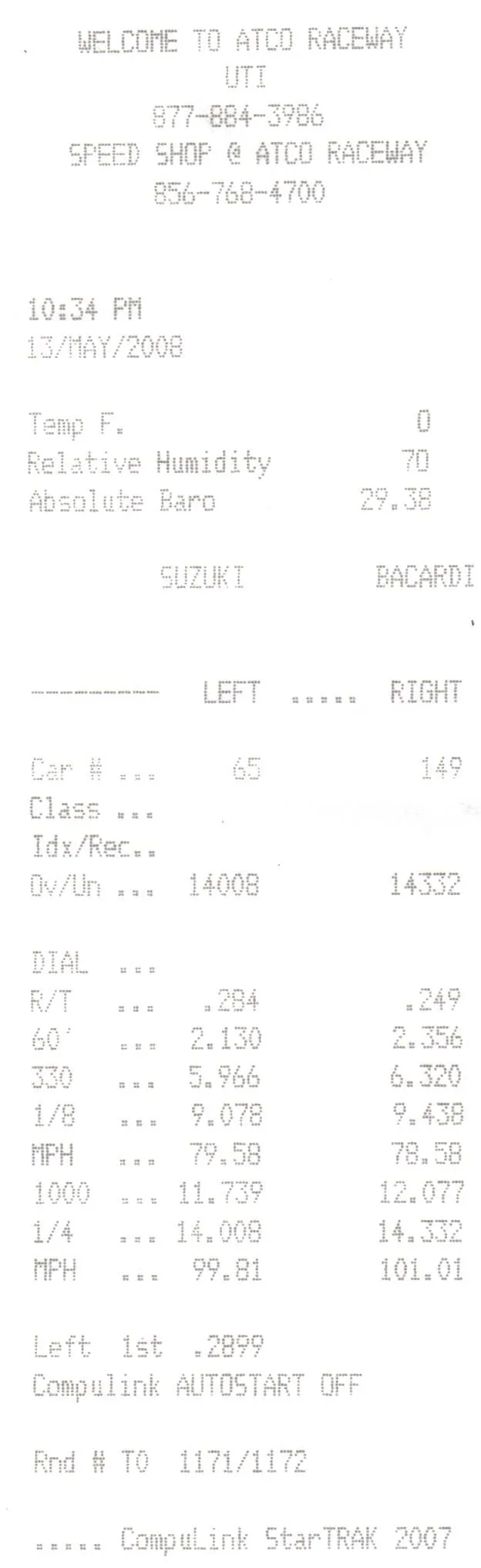

just got back from my first trip in this thing to the track...
2.356 60ft, 14.33@101, probably a only few feet above sea level.
mods are SRI, MM inserts and MP.
I'll attach the slip tomorrow.
traps are low surely because of my weight (330lbs), the 12" sub and the over 3/4 tank level...i stated before i can't worry about stuff like that because that is how the car is on the street every day.

you know what's really weird? right lane column on that slip is almost identical in every single aspect, sometimes to the hundredth, to my last run, except i trapped 101. weird....

on relatively low power cars like this, that doesn't matter as much compared to cars that truly are spinning wheels through several gears many times and are dancing down track.
what directly effects our traps is weight. all else equal, the heavier the car, the lower the trap, the lighter the car, the higher the trap. subwoofers, gas @ 8lbs a gallon, extra stuff, body weight- this stuff effects traps like it did with me. ET is directly related to 60ft. ideally, for every 10th at the light, you get over 2 10ths through the traps. it's pretty dead on with street cars.

car in the right lane on that slip was a mustang mach 1. In case you were wondering.

dyno'ed at RT Tuning in PA 251whp/282wtq corrected, 258/290 uncor....
and here's the slip for the above, car #149-
