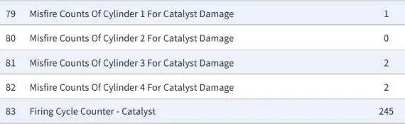

I have a 2014 CX-5 2.5L with 158k miles. All four of the cylinders appear to have a handful of misfires (live data in pic below).

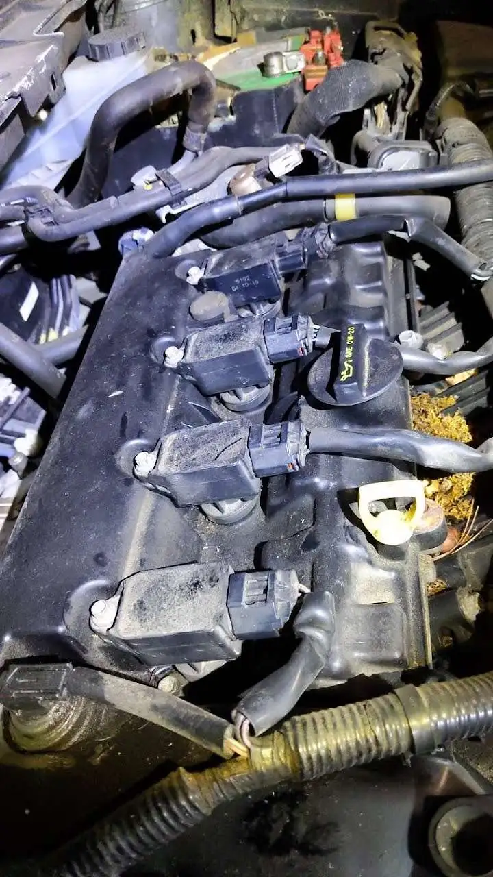

One of the coils is bad. There is a DTC: "P2311:00-2F Secondary Circuit Of Ignition Coil D". It also looks like it was a replacement coil, as it looks different than the other 3.
The misfires were present when I bought the car. I just replaced the spark plugs with Denso 3532 aka ZC20HPR11 today, and still get these minor misfires.
The defective coil I will replace but does anyone have experience with aftermarket coils? I would replace the other 3 coils as well, but NGK's are $85 each.
I assume the gas in the tank is regular unleaded, and the intake valves have never been cleaned. The condition of the fuel injectors is unknown. The engine appears to be healthy otherwise. Steady idle and decent acceleration with no hiccups. The onboard computer showed 24 mpg overall in mixed city/highway driving in suburban Connecticut when I bought the car.
Should I be concerned with just a handful of misfires that don't appear to increase as I'm driving?

Best off taking the coil packs from Cylinder three and four, and moving them to banks one and two. Move coil packs 1 & 2 and moving them to cylinder 3 & 4 (basically swapping them). This way you can see if the problem follows the coil pack or not. This will save you money on purchasing new coil packs if they’re not needed. Secondly, as others have mentioned, while you’re in there, it might be wise to pull the plugs, and at the very least check the gaps, making sure they’re gaped properly and look good.
Whatever you do, don’t cheap out on the coil packs. Stick with the NGK’s as that’s what this engine is designed for and using the cheaper ones may cause performance loss and or check engine lines/miss-fires/etc down the road.

Yes, that's exactly what I did. Swapped the coils. Used my scan tool and saw the error code move to the new cylinder. I settled on a single NGK coil, and it fixed the DTC code I was getting.
I don't think the OEM coils are NGKs (read this somewhere else - and CX5 coils seem to be problem as supplied by the factory). But the misfire problem still exists on all cylinders, even on the cylinder with the new NGK coil.

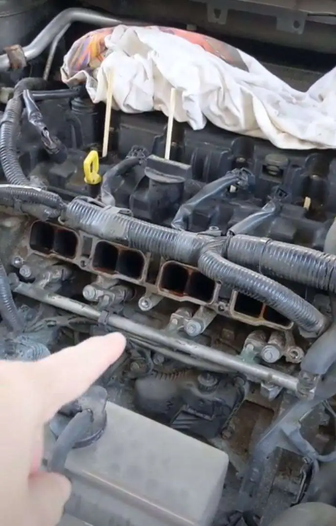

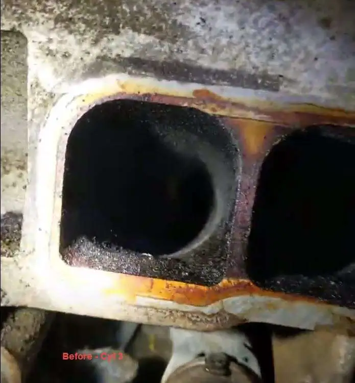

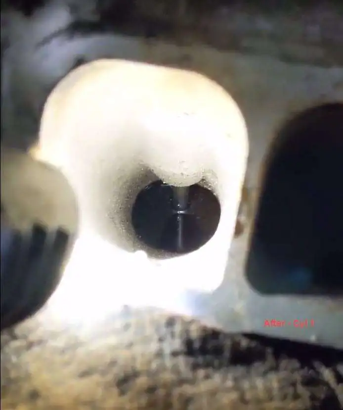

It was 76 degrees in NYC yesterday. It was do the carbon clean up today or wait until spring. Started at 2:30PM and finished at 2AM. Yeah, I'm crazy, but I'm working outside, and it was going to rain the next day.
There was a lot of carbon in the intake side of the head. Took 4 soaks/brush cycles with Berryman B-12 to get 90% of it off valves and 100% off the ports. I also cleaned the ports on the intake manifold. Cleaned the throttle body as well since I had it off.
The results were well worth it! The accelleration and noticeably quicker based on the butt-dyno. Gas mileage most likely better too. I have to wait until the next gas fill up to know whether it's my octane boost/gas treatment or the carbon cleanup that eliminated the misfires. Nevertheless I highly recommend a carbon cleanup, especially if you get a reputable shop to do it.
