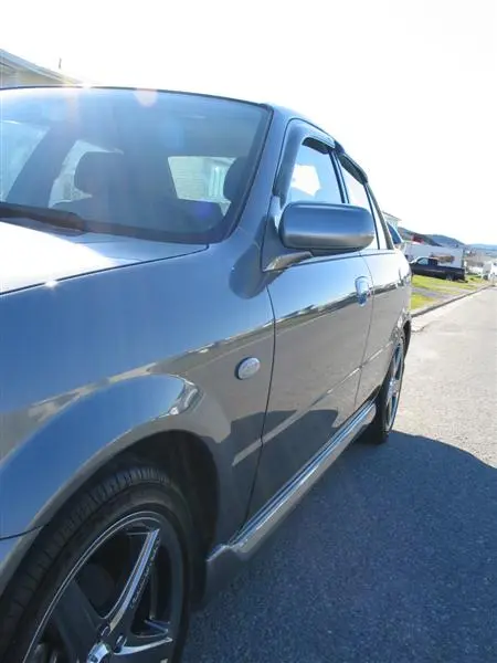

Give me a sec to get the pictures uploaded. I have to resize them and stuff. I had a hard time capturing the difference as the sun was heading behind the hills and wasn't great for pics. I'll get some more the week. Zaino is supposed to cure for a few days to get the best shine/feel anyways.
Here we go
This is Clay, then 3 coats of Z5, z5 detail spray between each coat. Meguiars tire gel for the tires.
Door shot.
Before
After
Metallic Shot BEFORE
After
Rear bumper scratch before
after
rear bumper damage from an $%%%^ in a parking lot.
after
two more after shots
I think you get the idea. I'm going to let this sit for about 2 weeks, and then I'm going to cover it using z2. And compare.
