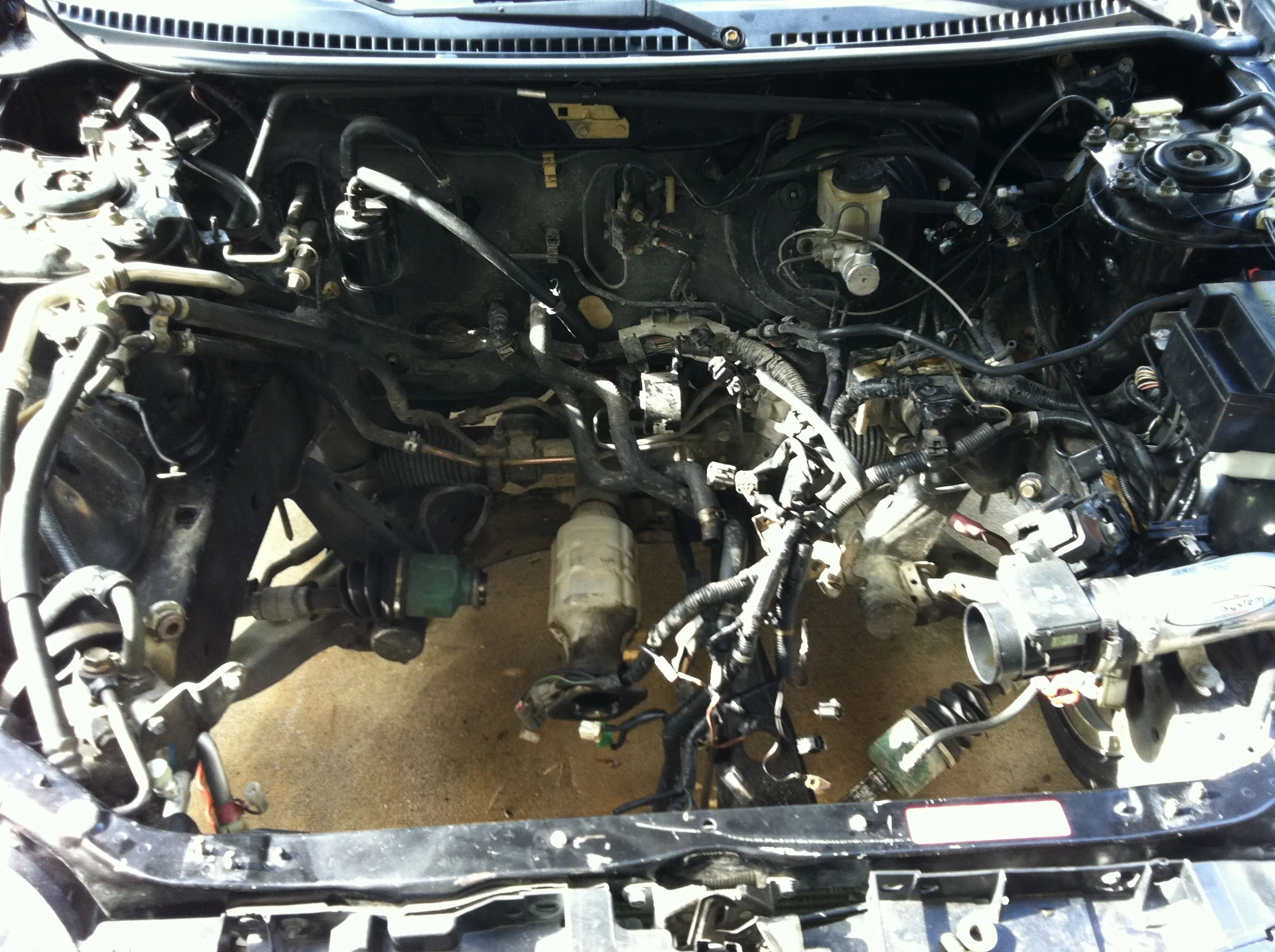

Well got me a black mica MSP bout a month ago. Bought it with a blown engine so in the process of rebuilding it now. Went with forged internals Wiseco pistons and K1 rods with an overbore of .020. Can't wait to get it back together also just picked up a SteedSpeed mani from another member so pretty excited about that as well. Gonna be a big difference from an 07 350Z im sure but just had a lil girl and the wifey says 2 seaters are a no go lol.... Still waiting on some more parts to come in so we can start puting it back together just hoping for minimal problems and no extra bolts. I'll include some pics of the MSP so wish me luck!! IMG_1318.webpIMG_1319.webpIMG_0951.webpIMG_0948.webp
Just a thought before you put it back together, buy some new bushings for your front sway bar and grease the crap out of them with white lithieum grease while it's easy to get to.
I wish I would have know about the clunk while I was puting my motor in.
