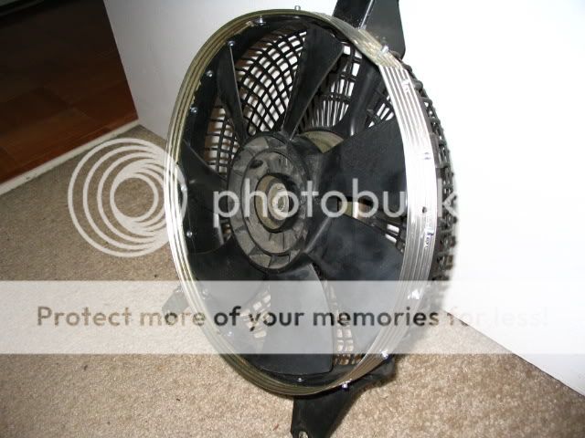

Got bored today waiting on parts to arrive so I modified my fan to work better. I'm using the stock BG aux. A/C fan as my main fan. The original setup for the fan was as a pusher style mounted in front of the radiator I wanted it to mount on the back of the radiator where the main cooling fan used to sit. It was fairly simple to flip it around, mount it, and reverse the wiring so the motor spun in the opposite direction. The main problem is that the fan sits about half an inch off the radiator surface and the blades of the fan are cut to be the most effecient when spinning as a pusher, not a puller. This means a less effective airflow movement for the fan and the air that it is pulling is mostly being sucked around the edges of the fan and not through the radiator. I simply riveted on a collar around the edge of the fan shroud that will take up the extra space. I'll put a piece of hose around the outer edge so that it is flush fit with the radiator face. This extra room also allowed me to take the fan blades off the motor and flip it upside down. Now the cut of the blades are facing in their most effective position with the motor reversed. Win, win for the air pull through the radiator.
Tomorrow the extended rear wheel studs should arrive. They will be a pretty simple install since I can switch them out without removing the rear spindles.
Remarkable what a "bored" person can do. Imagine what would have happened had you been motivated. :-)
