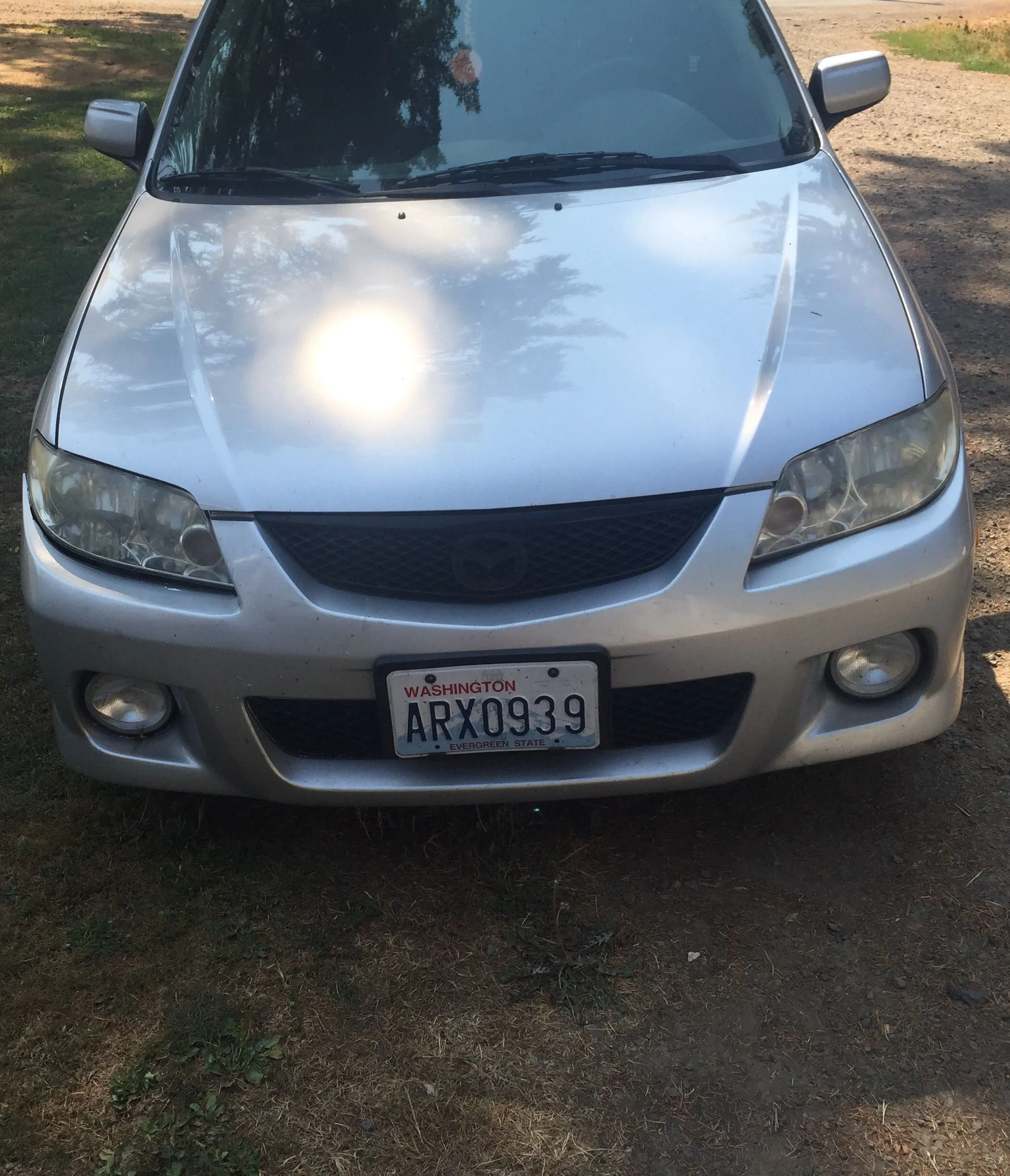

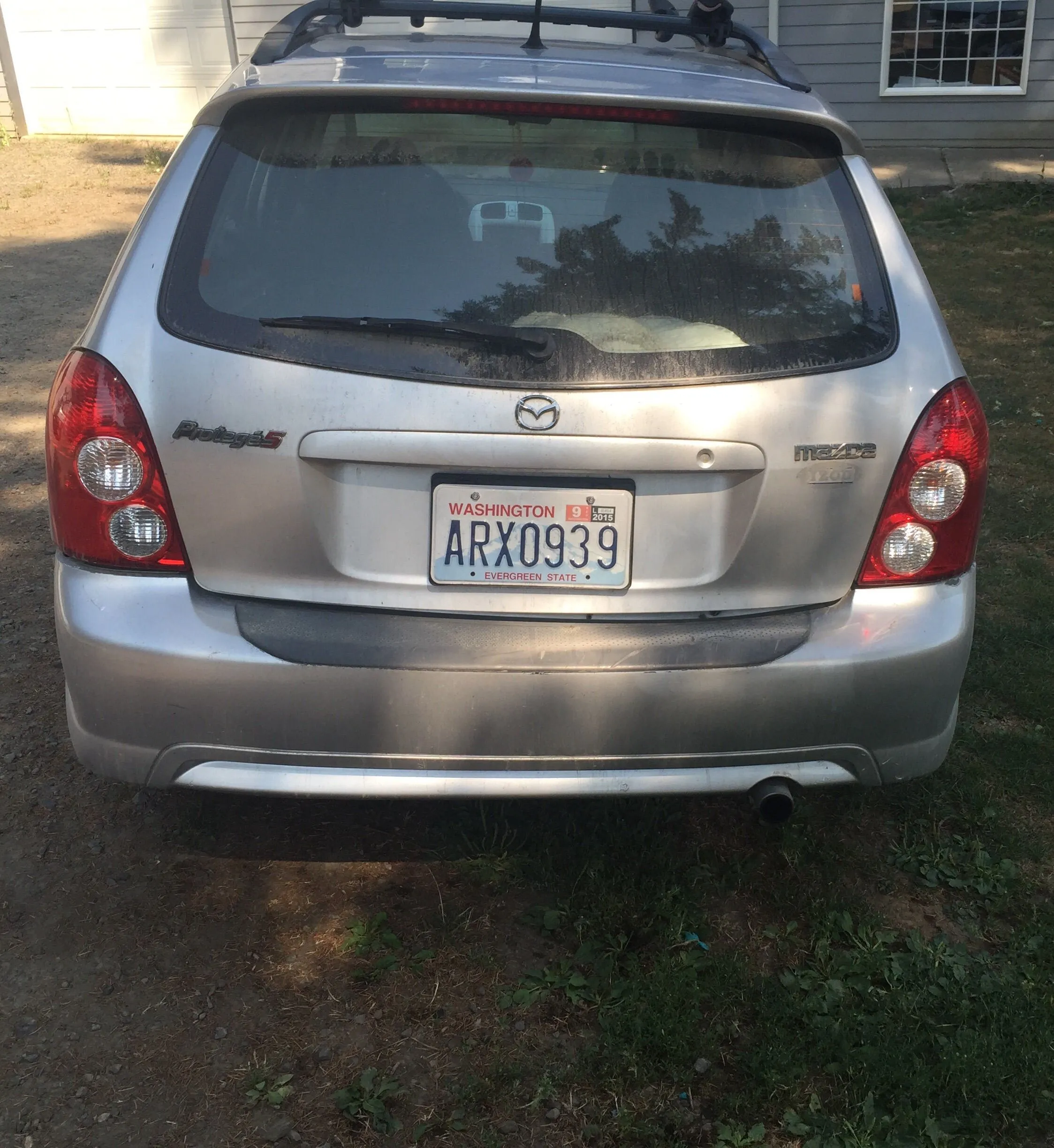

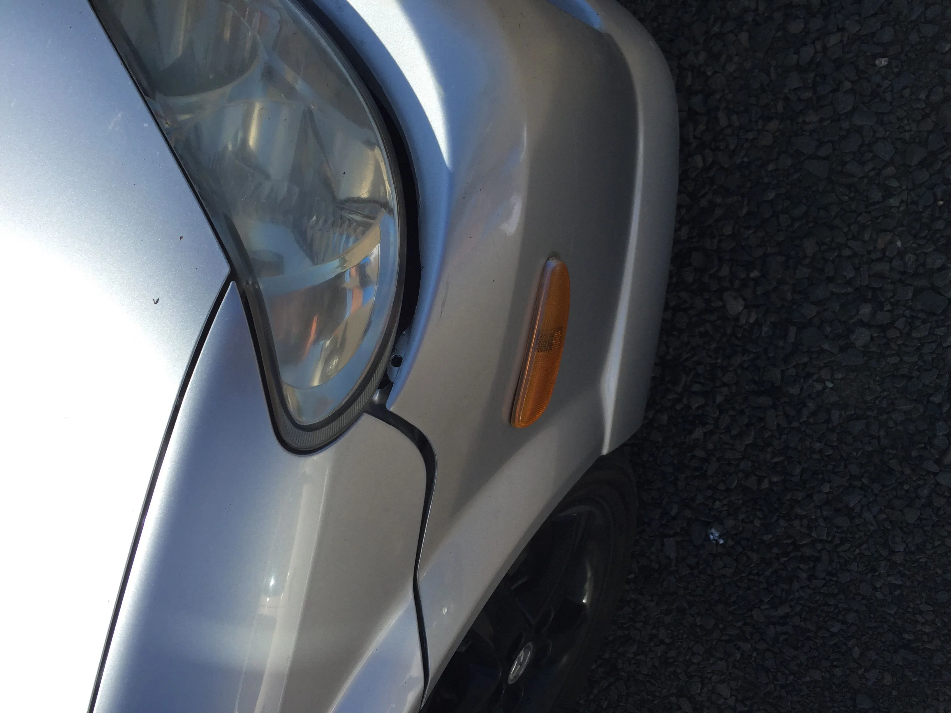

I just recently bought a p5. Looking to do some cheap mods. Cosmetic and engine. Also need some advice! My bumper is kinda coming off and I'm not sure how to attack it. And how can I make my car a little wider? How big of wheel spacers can I go on stock wheels?

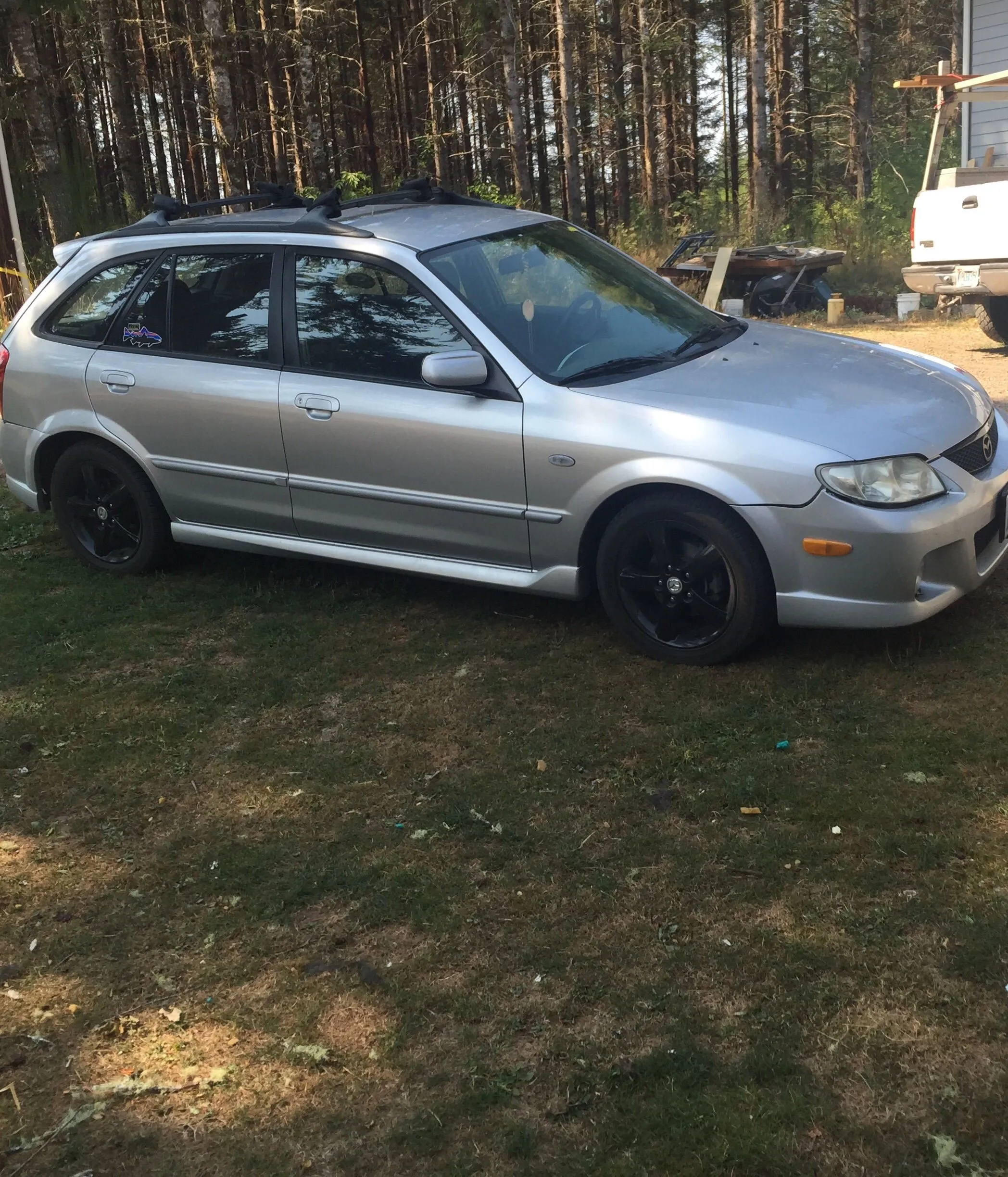

If I got new studs how far do you think I could go out without having to roll my fenders or anything like that? Thanks for the bumper help!
If youre not planning on dropping it, like 20mm. But in that case you wouldnt need longer studs, because you'd be using bolt on spacers.
I'm planning on dropping it..I just don't want to have to do anything to the fenders but still have that wide look. I just ordered an exhaust and mud flaps, ill post pics when they get here.
Are you wanting to run aftermarket wheels?
There is hardly any fender clearance on the rear, so that needs to be considered before lowering or installing spacers.
17x7, +45 offset, with a 205/45 or 215/45 tire usually fits pretty well. You will have to roll the rear fenders.

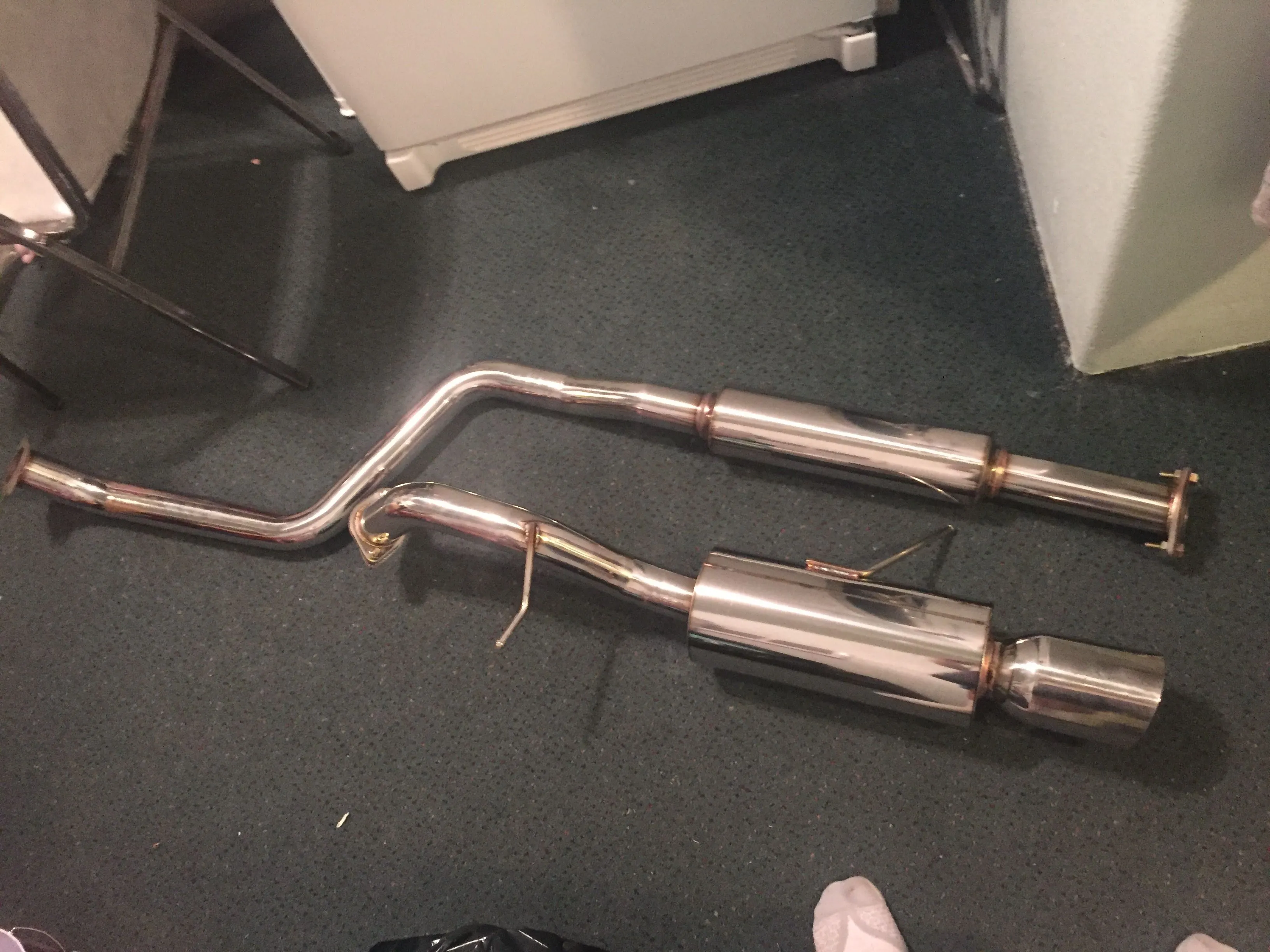

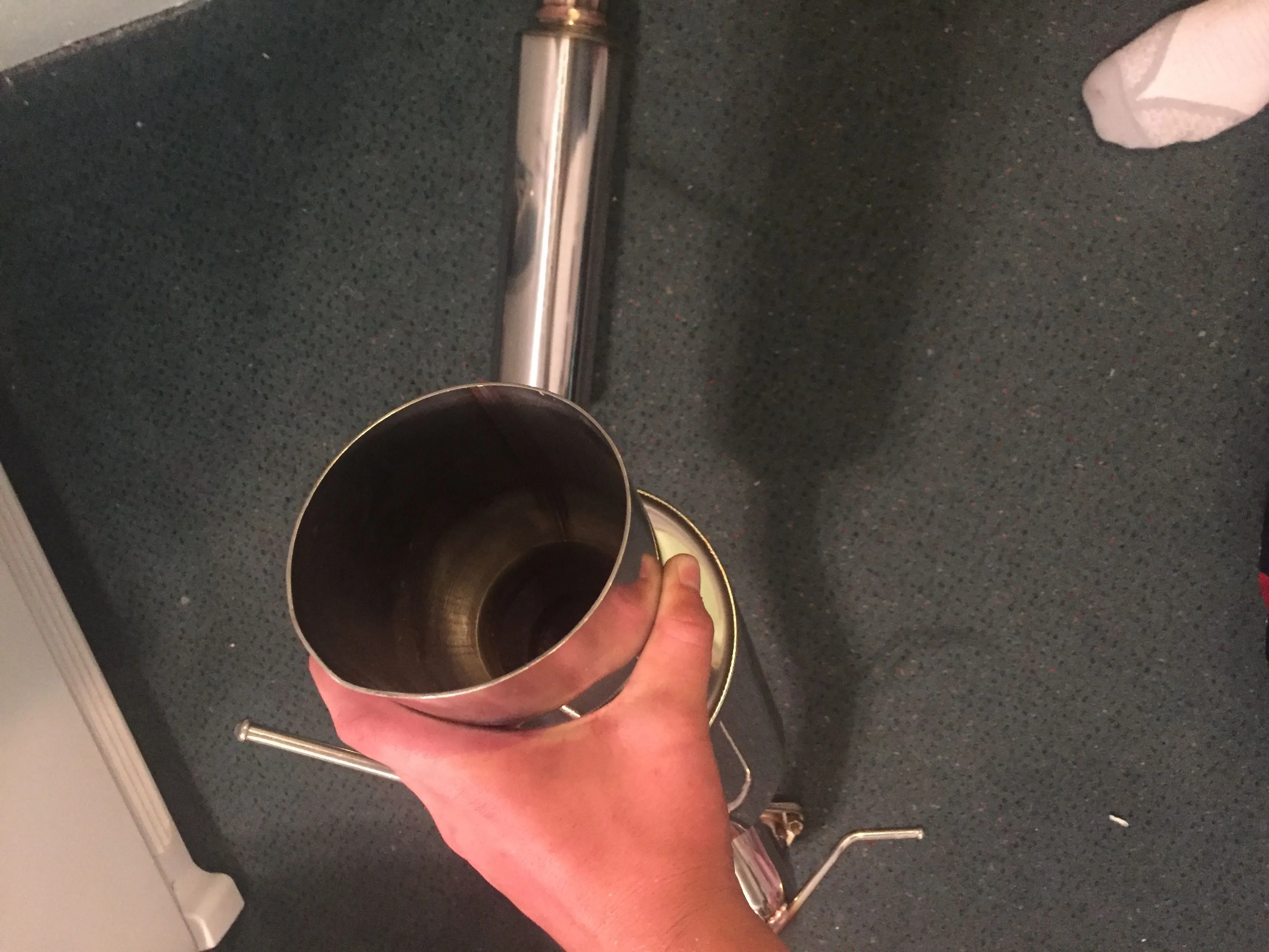

finally got my obx forza catback. Nice deep rumble. The only bad thing is the tip is so god damn big and is snugged against the bumper. So it melted part of the exhaust cut out. I also just ordered an innovative performance chip. Should add 35hp and 5mpg more!

Go on eBay and get some adjustable exhaust mounts then it won't touch your bumper
