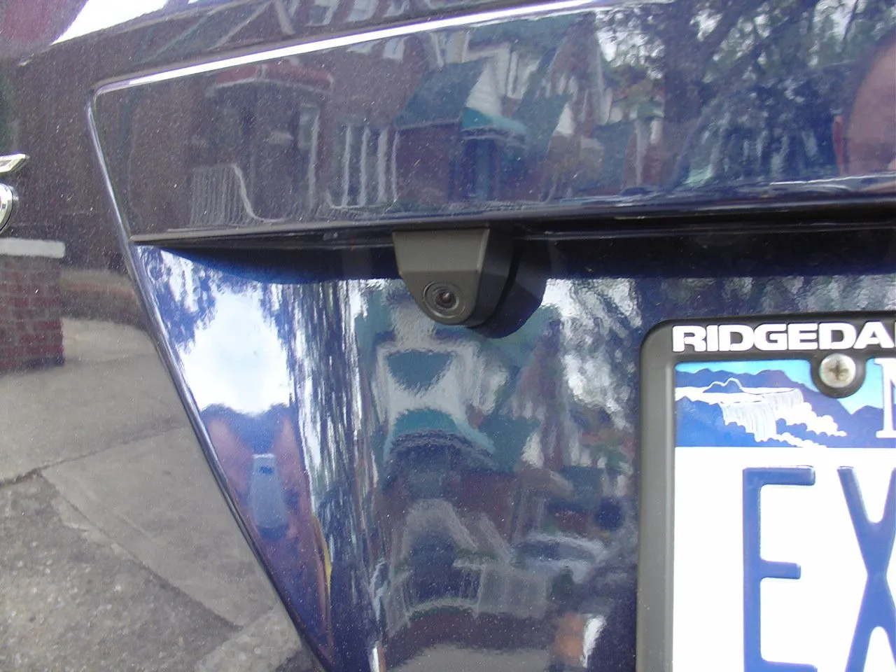

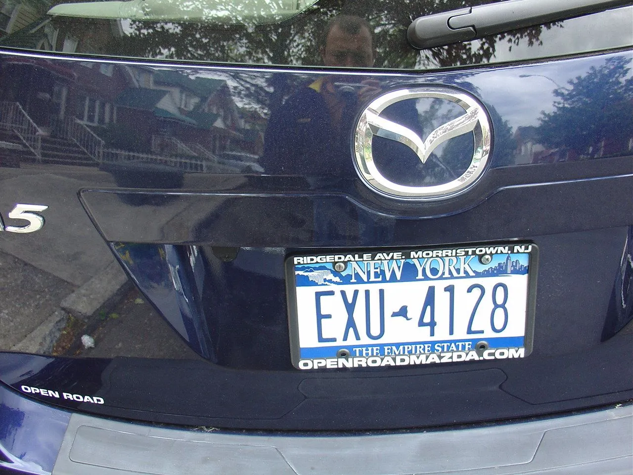

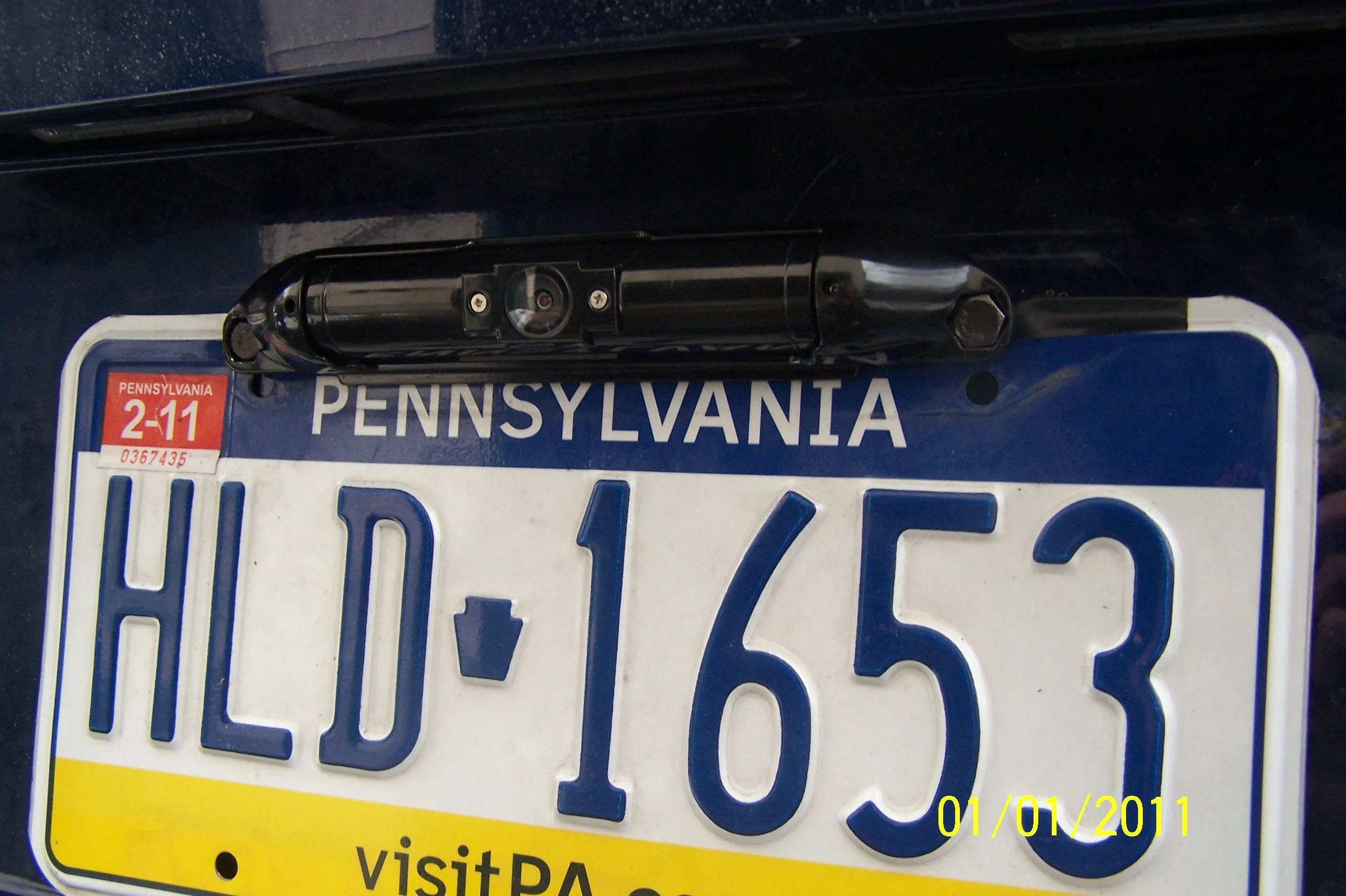

Outside view of the mounted camera, looks like it belongs there right?(yes) OEM look was my main objective and this one looks just like the other ones Ive seen. You really dont see it, but thats the whole point. I could have recessed it a little but that required more fabricating than I felt was worth the effort.

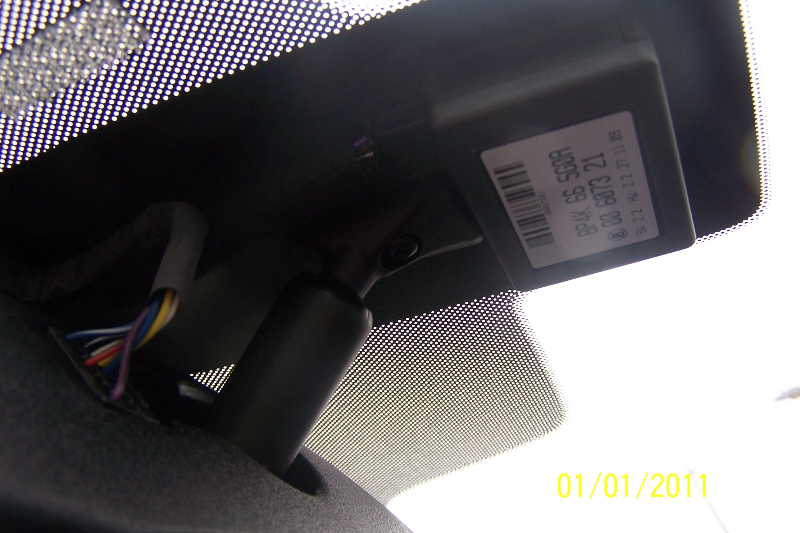

The problem is the plastic box (GT) around the mirror base. It looks like it is in two halves that should come apart. When it is in place you can't slide the mirror base up to remove the mirror assembly. I don't want to mangle it - I would like to know the correct way to pry it off.

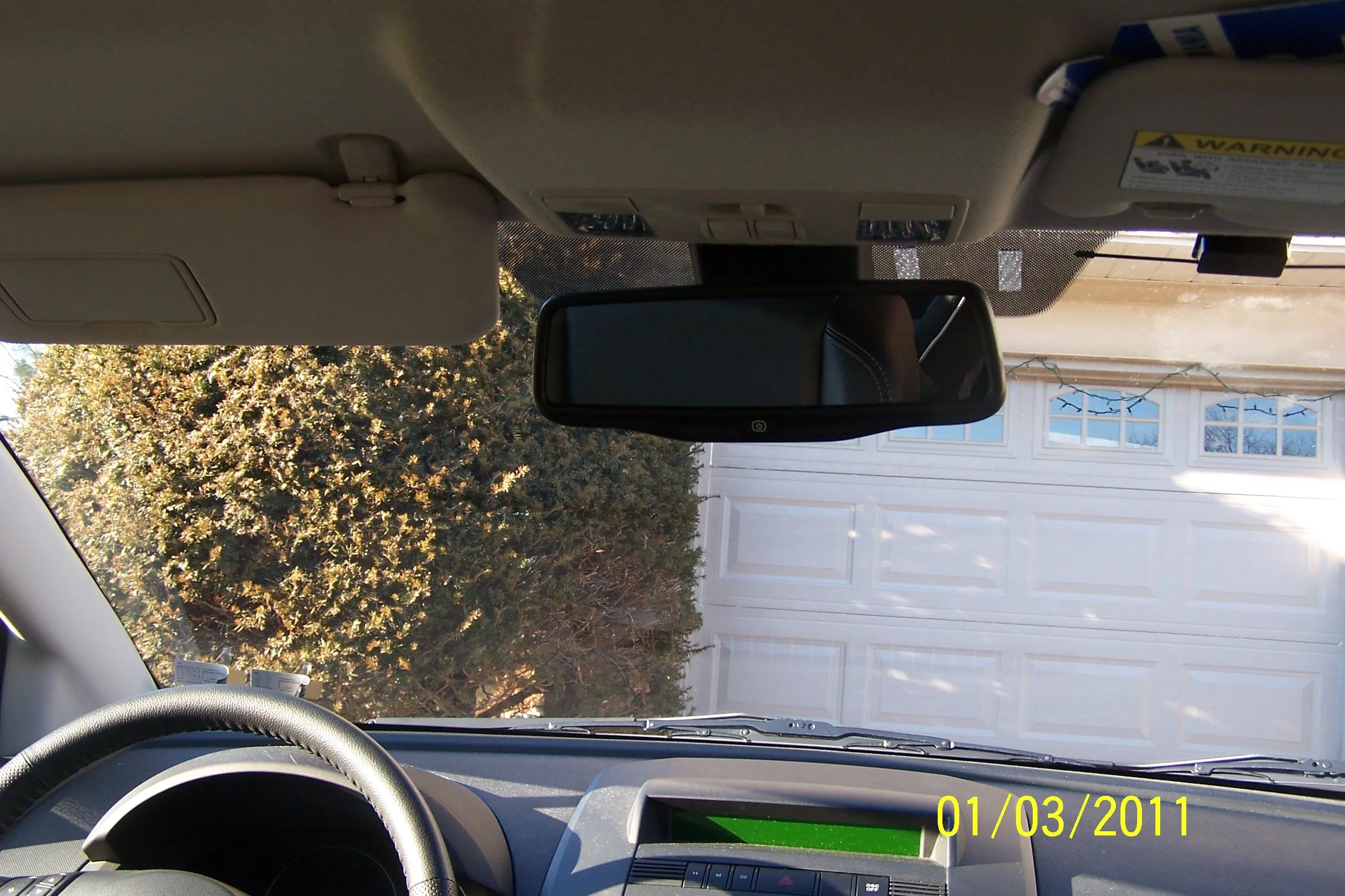

I just completed the installation of a Gentex 3.5" mirror and a Boyo license plate camera. Twintrbo had the right idea using the separate mount camera. The license plate camera is not any easier for two reasons. One the wire does not come out high enough. You either have to let it show or lower the plate by redrilling it. To use the hex bolts that come with the camera you have to cut off the plastic nubs inside the hatch and drill out the existing license plate metal mounts. This makes it theft proof, but you now have a potential water entry spot and you have to open the inside panel when you change plates. The Boyo wire harness has a unique connector so I ended up having to use most of it (two segments), and the last mirror plug segment from the Gentex. On the last (mirror) segment of the Boyo is a little push button. They don't explain what it is for. I thought I had to remove it and attach one of the wires to the Gentex trigger wire. Not required, apparently the mirror triggers the camera and you only need the video, 12v power and ground connected to the camera.

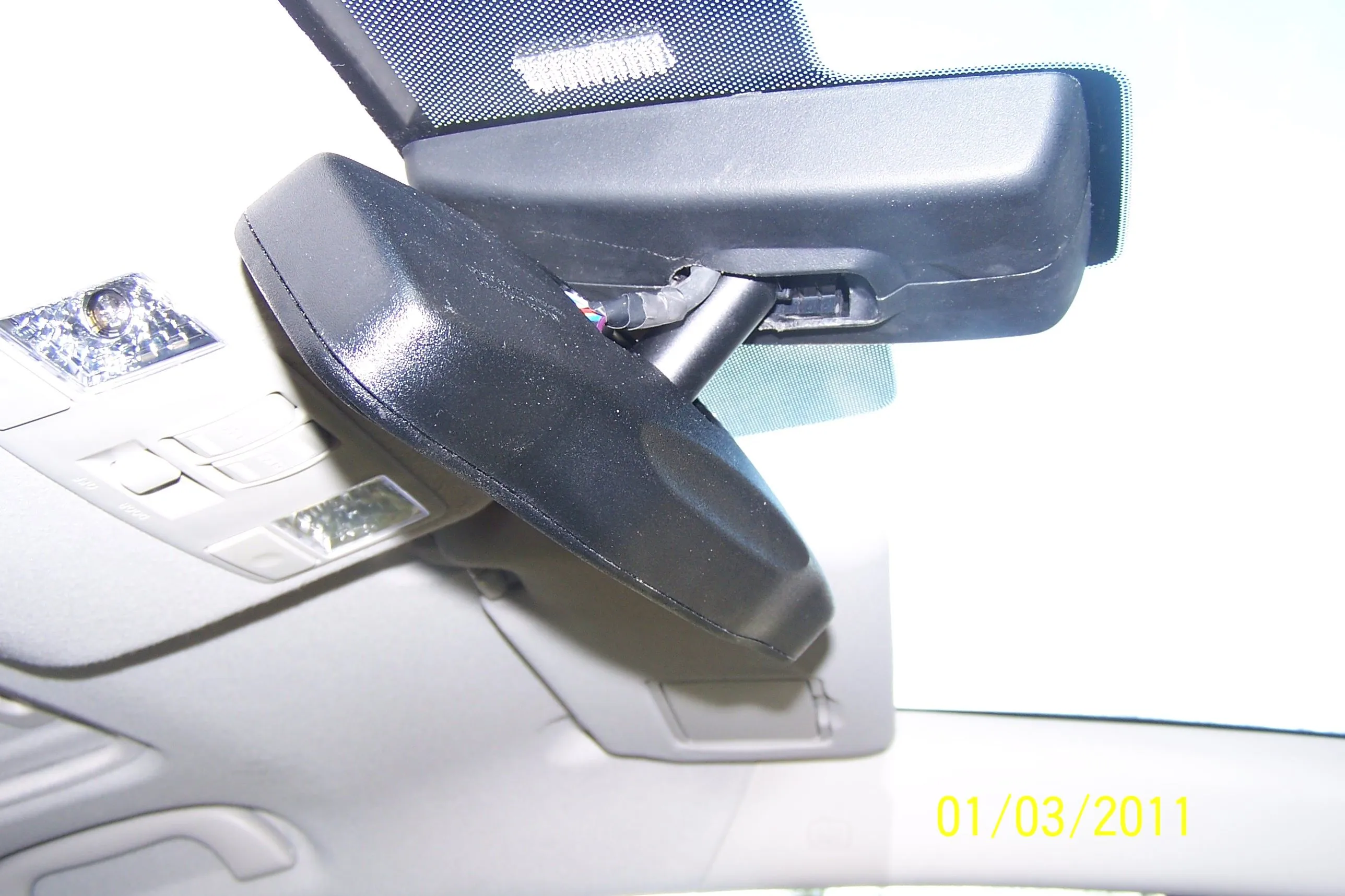

The plastic box around the mirror base is removed by putting a screwdriver between the mirror base and one side of the plastic housing and prying toward the side window. It pops right off in two pieces. You will notice now your new mirror is not made for the GT and will mount at least an inch higher because it does not have the vertical segment that holds up the rain sensor enclosure. The old mirror comes off by tapping up gently.
I just re-used the plastic box by cutting a notch in the back end for the extra wire and elongating the hole since the shaft of the new mirror passes through at an oblique angle. It does not show very much; you could close up the front of the hole if it bothers you with a piece of black plastic. I put some double sided foam tape on the sensing unit to hold the box in place.
I followed Twintrbo wiring routing exactly except I went from back to front. The toughest problem I encountered was snaking the wire around the hatch window. I drilled a new hole instead of using existing holes in the hatch, but had trouble getting the other end out by the rubber boot. The Boyo connector is very small in diameter, but is over 2" long and got hung up in the bend. You worry about damaging it when pulling.
I had the misfortune to tapping into the wrong trigger wire initially. There are at least two with that R/Y silver dot coding, but only one works.
The infamous white pin in the front pillar cover was a pain. I ended up prying the whole thing out and pressing it back while attached to the cover. Otherwise all the panels came off easy and went back with no problem. I have several not so good pictures which I will post separately.

Gentex 3.5" Back-up video install in GT

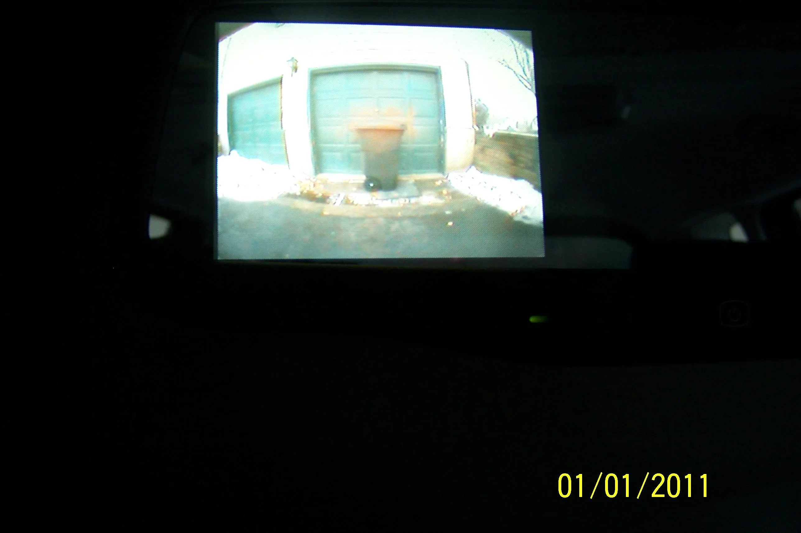

HERE ARE SOME PIX THAT GO WITH MY LAST POST. The video is better than it appears in the picture. The trash can is only 6" away so it does make things appear much further away.
halve1

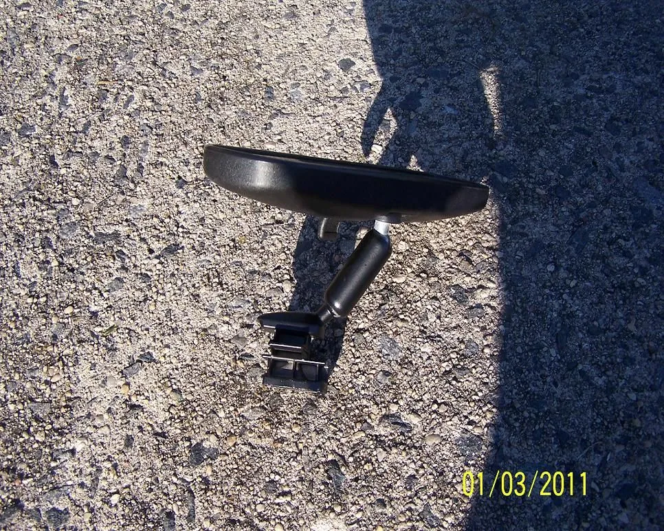

MORE PIX ON Gentex 3.5 video mirror
These photos show the finished mirror installed. The original Mazda GT mirror is also shown. On the Mazda mirror, note the vertical portion that lowers the mirror assy the thickness of the rain detector housing. The flange on this supports the housing. With the Gentex you need to support the housing another way.
I chose the separate camera only because I wanted an OEM look. I figured there is a reason they build them into the cars the way they do, I guess this identifies the reason. It was really a leap of faith buying the camera part though, I had no idea what I was really getting. I hear stories of poor performance with lots of these rear cam installs. My neighbor bought a wireless setup that gave up after 6 months but you get what you pay for I guess.
