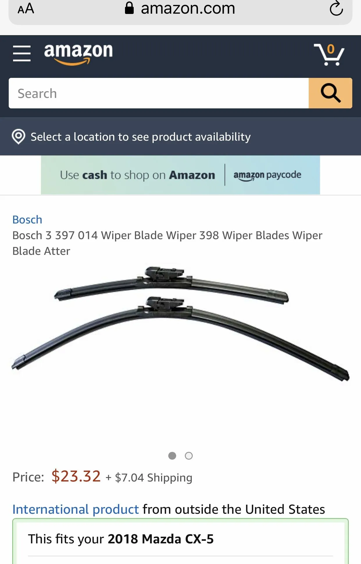

UPDATE: Here I did a quick search for you:

Yes gen-2 CX-5 uses proprietary hook which is a little difficult to find right now. If you’re satisfied about the performance of these OEM “beam” wiper blades, you can try cheaper rubber inserts. Since there’re so many complaints on gen-2 OEM wiper blades, you can also try Bosch AeroTwin part # 3397014398 which comes with 24/18 pair. Bosch AeroTwin series are designed to exactly meet OEM specs, hence no special hook adapter is needed.

For $16 EACH on Rain-X, I’d definitely get cheaper OEM style Bosch AeroTwin blades part # 3397014398 which offers no-hassle installation.
