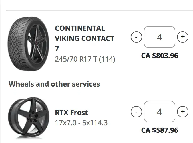

I just bought a 2017 CX-9 GS-L and I'm in the market for winter tires. After reading this and other forums for hours I've found these that might work for me at a decent price.
Anyone know if they will fit, and if so, whether it's a good choice?

You want the Bridgestone Blizzak winter tires. There is nothing better on the market. Period. They even grip on ice, better than any tire. Mazda uses Bridgestone Blizzak tires when they do their AWD testing on their winter track. They are amazing winter tires!
I ended up getting the Blizzaks. Haven’t really been able to test them as the only day we had a lot of snow, I didn’t leave the house. So far no issues.

Not sure if anyone replied to you, but not a good idea to go with 245 width winter tires, or to put them on a 7" wide rim. I'd go with 225 width tires max on a 7" rim, or get a wider rim if you can. I got 225 tires on a 8" and they are perfect.
The tire choice is great, I have the same tires.
