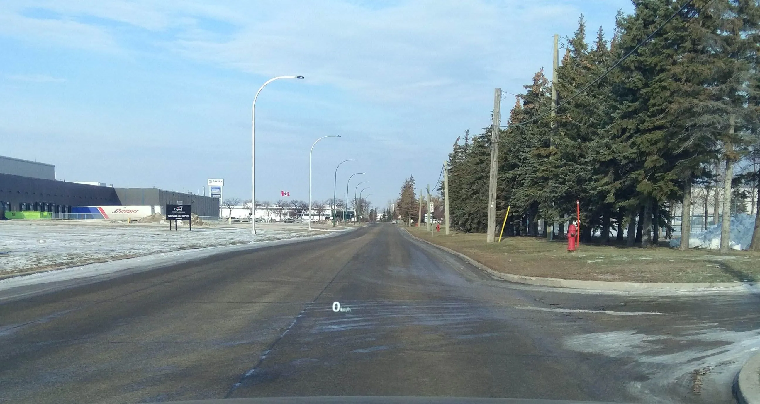

2018 CX-9 AWD, outside temps at 2c (36F). TCS off, engine cold.
Here's a general idea of what the road looked like.
attachment.php
Not dry, but not really wet either.
attachment.php
So is this good or bad?
