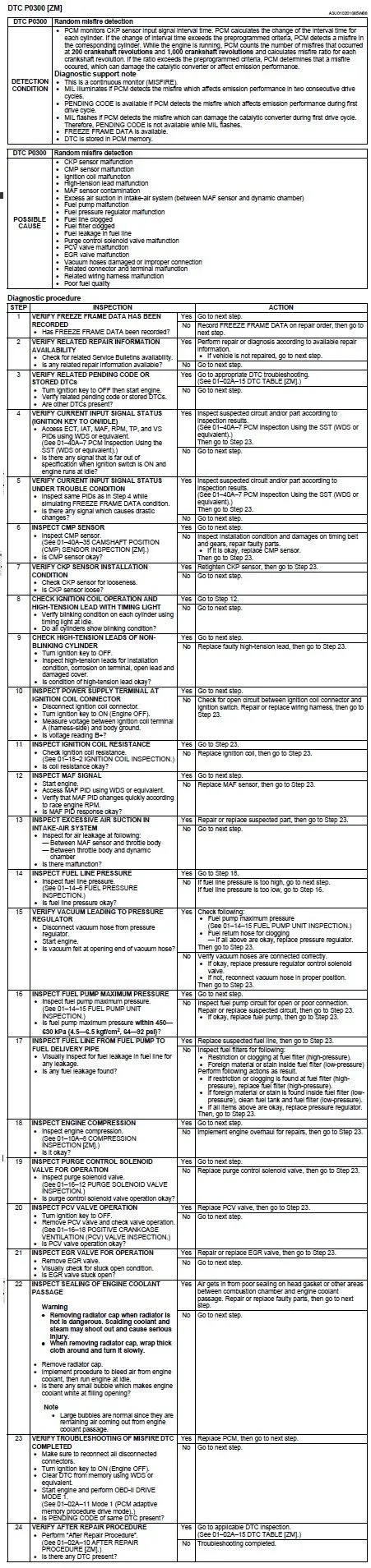

Here ya go:
[/IMG]

Thanks for the charts but i cannot read the PO300 photobucket post.

did you download it and zoom in?
I did that and it make it ultra blurry and extremly hard on the eyes to even attempt to read it even on a 47 inch "monitor"! lol
Anyways I have uploaded the file as an attachment!
Thats readable but not very pleasant. I just took it from the downloaded manual on the sticky.
