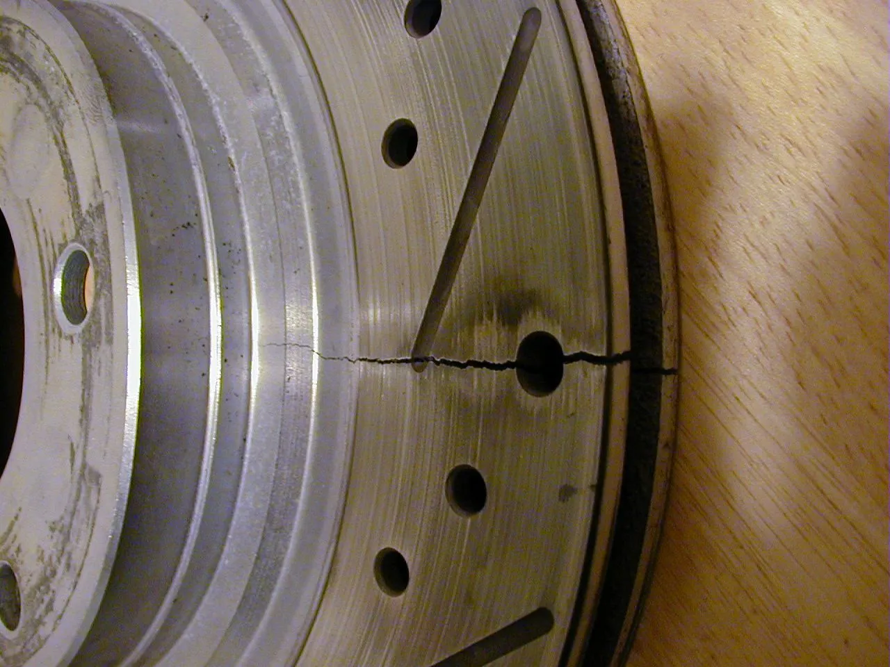

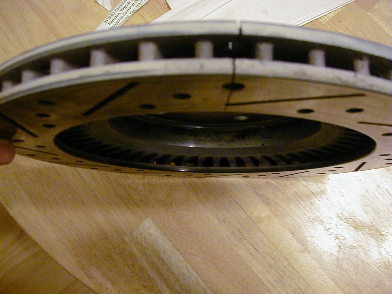

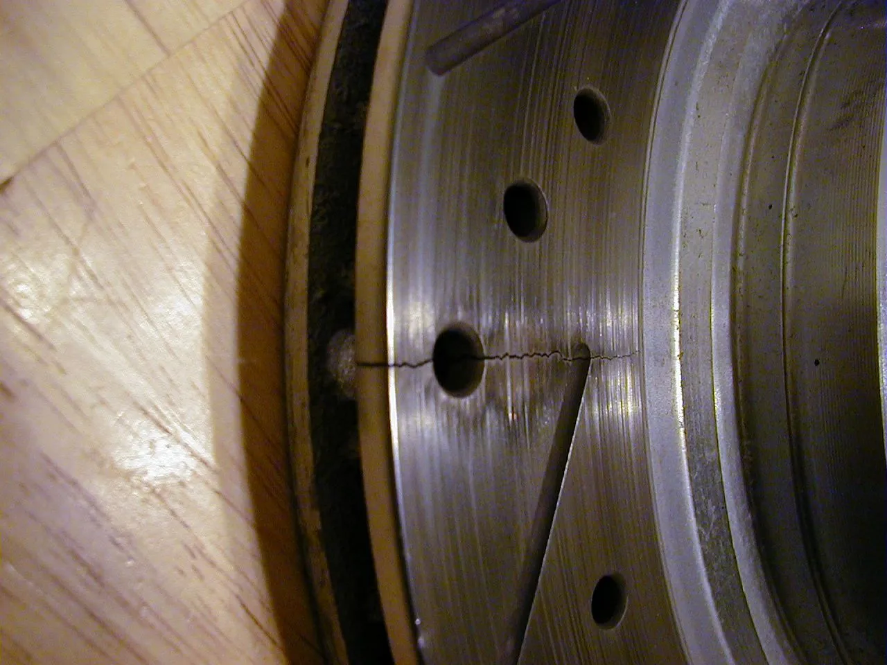

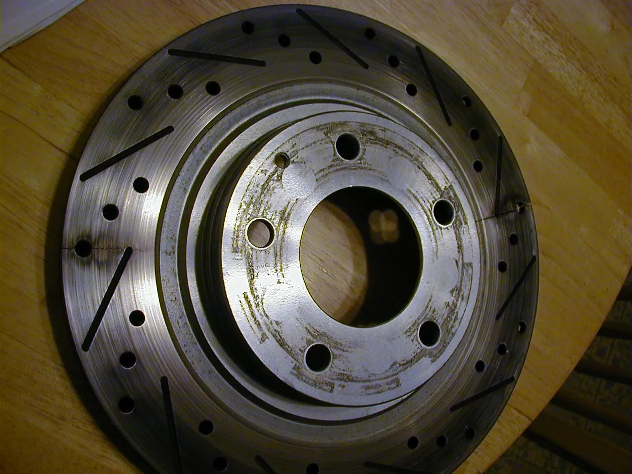

i also need to get some new replacement rotors and you can't cross reference the part numbers on the "valu maxx" rotors that came with the kit...of course 3 emails to e-racer's sales and tech line have gone unanswered...does anyone have a phone number for them or know anything about what rotors we can use to replace them (i.e. what car they are for...these have to be oem rotors for some auto mfgr b/c of how cheap the kit is)
Warning...the stock rotors from this Valu Maxx cannot withstand track events...they are drilled and slotted from blanks and not cast so they are much weaker
