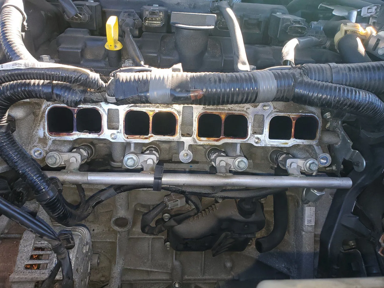

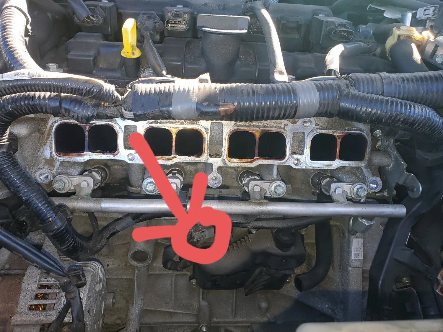

Finally got around to doing it. It's definitely under the intake. You have to pull the throttle body, intake, and I would recommend the radiator overflow (makes getting the intake out a ton easier).
Attached is a picture just because I never could find a picture.
There is an actual knock sensor. Mine is throwing a P0327 code. Everything I found shows a faulty sensor, local parts store carries it for the same price as rockauto, I just don't know where it is. Based off other cars I suspect it's under the intake but would prefer to know before tearing into it.

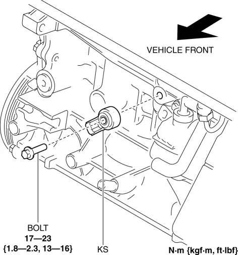

yes, usually they are on the engine block at the front.
see if this helps. its from the gen1 manual but probably same on all.

... Based off other cars I suspect it's under the intake but would prefer to know before tearing into it.
Yep, the intake manifold needs to be removed in order to gain access to the sensor. I recommend examining the connector/wiring and testing with a multimeter before hanging on the new part and reinstalling the manifold.

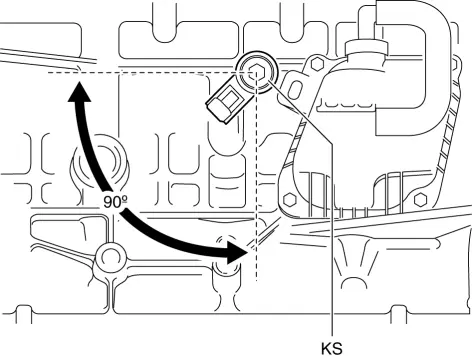

Pay attention to the degree it is mounted. You will need to install it the same orientation. The pic above from cz5gt shows it somewhere between that 90° swing arc but just take note of where it was and install the same angle
