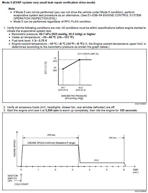

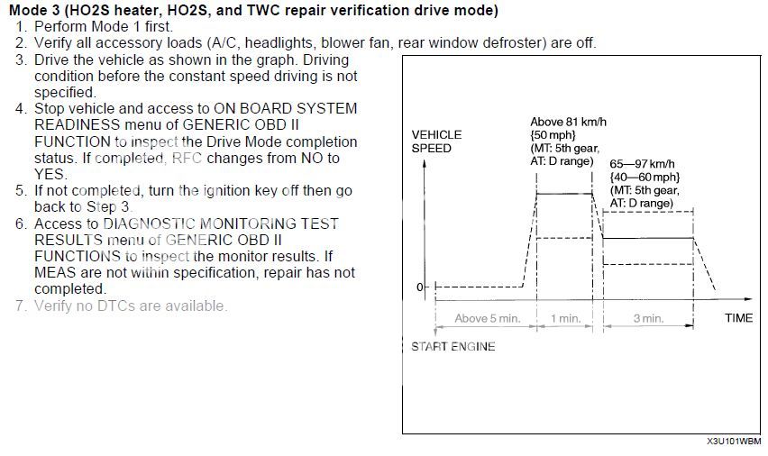

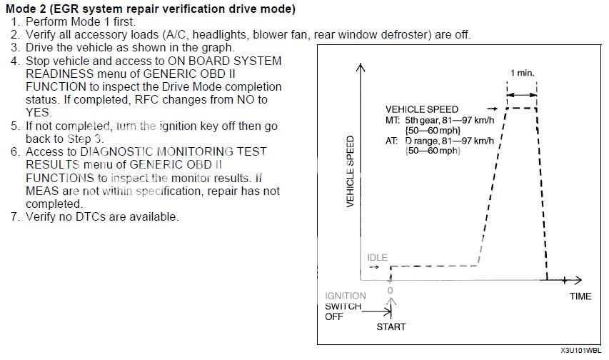

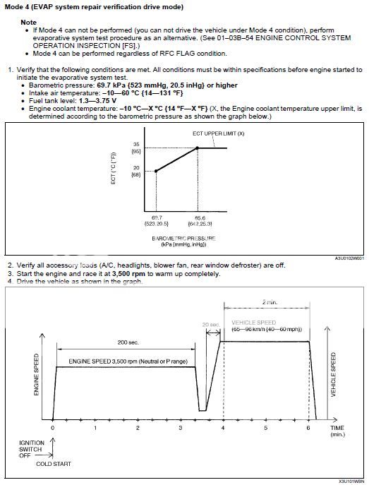

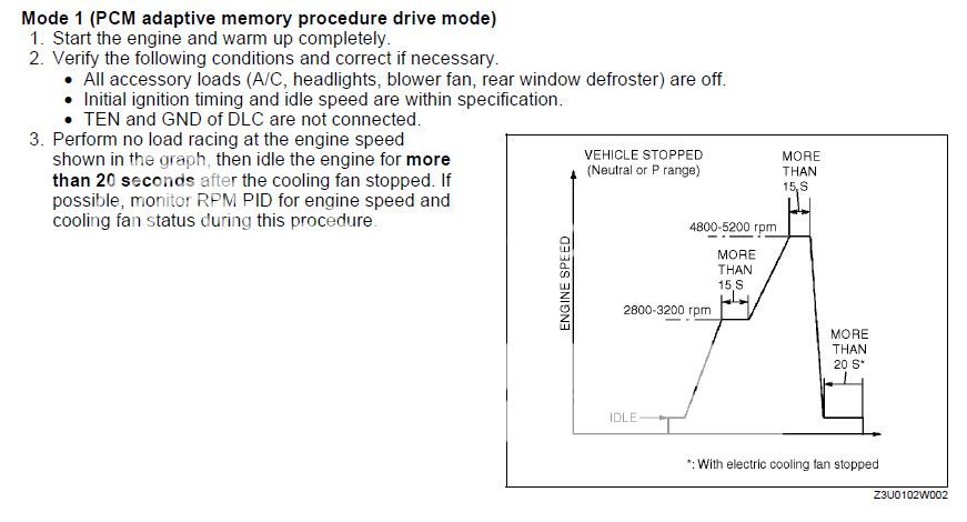

Anyway, history aside, you have to drive the car at slow speeds, you have to drive it at interstate speeds. For some systems, you have to change your speed a certain amount (not more, not less) over a very specific period of time. Basically, it more complicated than just driving to the store. With the 2.0L that I have, some readiness tests would not pass until I hit interstate speeds for at least 5 minutes. The O2 heater readiness test checks out within a couple of minutes (especially if the car's already hot), the EGR test requires your car to drive under certain conditions to where your EGR valve would open a prescribed amount a prescribed number of times. The evaporative test actually requires you to either leave the car sitting for an hour or so and/or else fill the tank up.

To be fair, these procedures are for my 2003 2.0L, but the logic should be similar or identical, so I posted them anyway. Ididn't use a dealer scan tool. Autozone's scan tool works just fine. I ended up buying one, and took it with me. It allows to check readiness codes. Cost $120 in 2008. Dunno what it goes for now. Ask a mazda dealer for the test procedures for your 1.8. Thhey should just print it out for you free of charge. I drove the patterns on the interstate at 2am with emergency flashers on so I didn't have to deal with stop lights and turns.
Wow. So long story short my mazda dealer is completely useless and I wasted an hour there trying to get info to no avail. Rather than calling or going to a different dealer and risking the same results; i did manage to obtain just enough info to perform better googling and came up with this insanely convoluted version of that you provided me:
http://www.obdclearinghouse.com/documents/newdocuments/mazda/OBDII_single_drive_cycle_96-03.pdf
They decided to combine every vehicle into one graph. It's nuts - but most important i found the drive cycle procedure for my engine and sure enough it varies slightly. Hopefully I can wade through all this s*** and perform the drive cycle.
