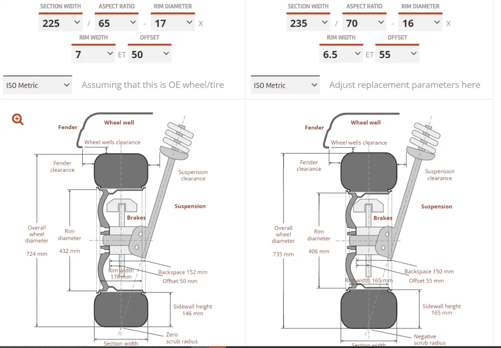

So these 16 inch ones i'm looking at here apparently came off of a Mazda5 (not sure of the year), and have a +55mm offset. Earlier on in the thread here you mentioned that Subaru wheels might not work since they also have a 55mm offset.
From what I can tell from the site you linked earlier, my factory wheel offset is 50mm. So we're looking at a 5mm difference in offset here. Is that 5mm difference really a deal breaker, or can there be a slight variation in offset?
I acknowledge you also stated that the only way to find out for sure is to test fit, but wondered if you happen to know off-hand if a 5mm variation in offset would be acceptable? I kind of hate to buy these, get them home, test fit them, and only then find out they don't work. I suppose I could always re-sell them, but i'd prefer to just avoid them altogether if I know they won't work.

Being that the rim width is only 6.5 and that your original offset is 50(mine was 45) then they might work.

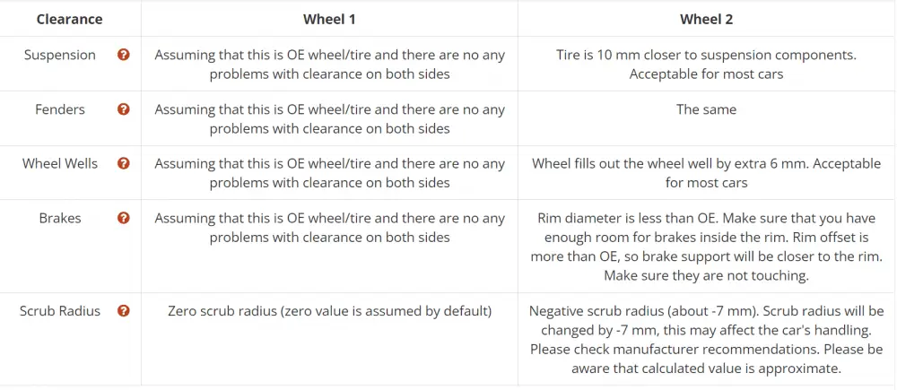

Going from 7" to 6.5 " means you'll lose .25 inches(or approx 6mm) from inner side. Which should in theory negate the 5 mm higher offset(50 mm to 55 mm) so technically it should be a wash/ even steven. They should work... But always best to try test fit first.
Wait you might have a problem with rim hitting brakes...gonna be very close.
Also gonna pull your wheel further in(approx. 10 mm in) the wheel well if you don't mind that look.
These are on Craigslist. The guy has a set of 4 of them, and wants $10 each. I assume he wants to sell as a set, otherwise he'd probably have a real tough go getting rid of the remaining 3 if I only bought 1. For $40, maybe I just buy them. I'm thinking that's a real fair price. Again, I just hate to buy them and then have them not work. Then I have to get rid of them and also still find ones that work.
For only $40 you could snag them and always resell if don't work.
Or take a chance they won't be sold, go to junkyard and get one to try first.
You risk losing the four though.
You should call your local junkyard and see if they have any 16" Mazda 3 /Mazda 6 rims with 50 offset.
Here's diagram.. look at picture 2 and how close rim is to brake caliper, and read brake summary... you really should test fit first

Also.. you sure they're 55 mm and not 50 mm ? Double-check the websites.
If need be you could always throw a spacer in...you can buy 3 mm aluminum spacers for Mazda @ about $50 for four(4). That was my first option.
Or if handy make your own... I was going to buy some 6" diameter aluminum or stainless steel discs of 2.6 mm thick and drill lug holes in them. If you can't find discs then a little more work to buy sheet aluminum from home store and cut out yourself.
That should get you away from the brakes.
Would paint the spacer regardless of which type metal you use.
