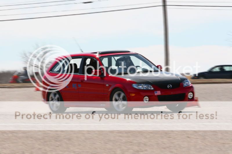

yep, it sure can on street tires. this was from an auto-x this past sunday. my mods are in my sig, and im still running the stock p5 dunflops. definately depends on driving style. this particular course was covered with loose rocks. i was sliding all over the place, but looks like i was able to get some grip.
seems its also possible to bring the front off the ground too. got pretty close here:
