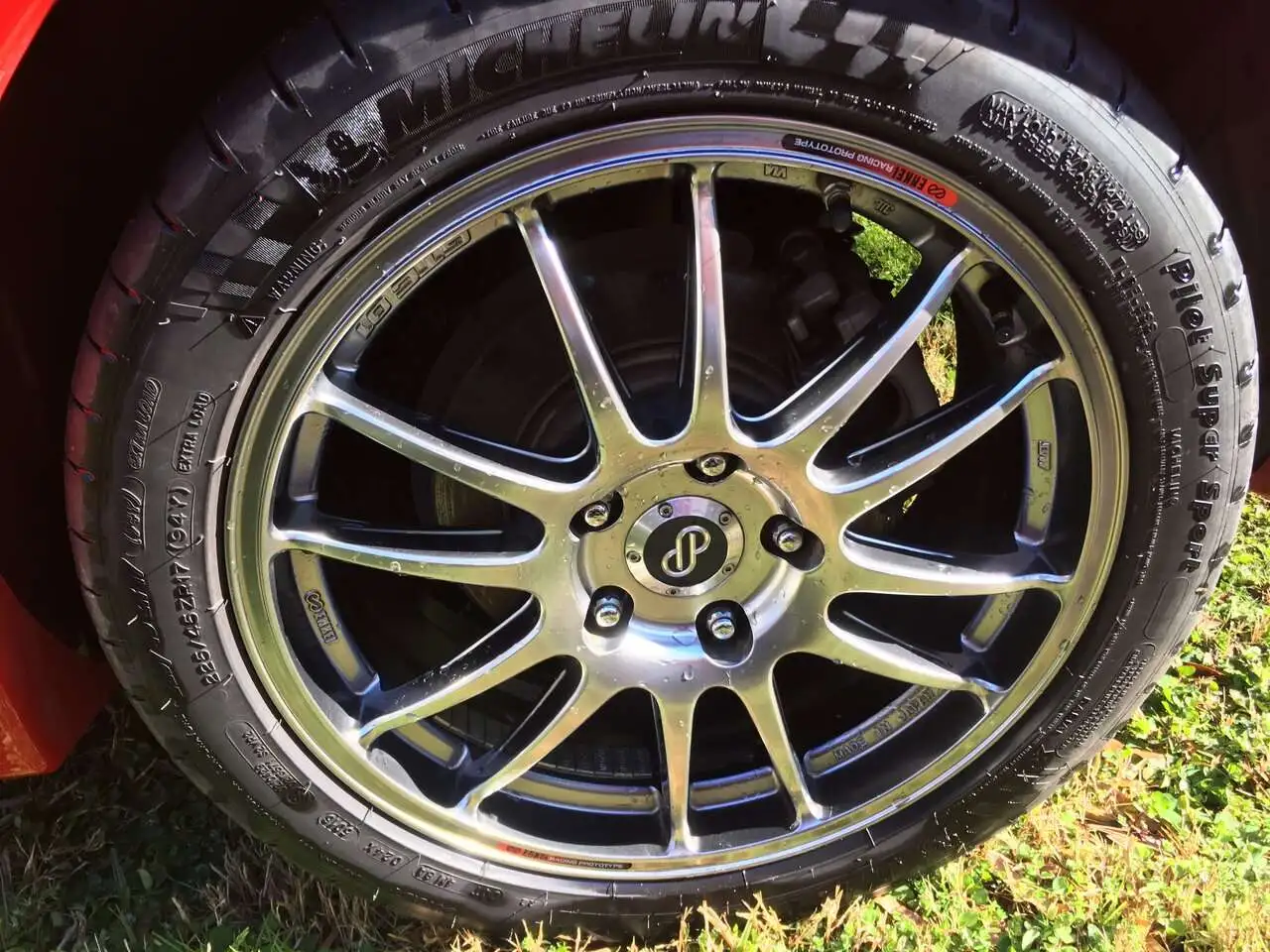

Wow, I guess 60 lbs was a big effect? I had Enkei’s on my last Mazda and I think they weighed 18 lbs plus tire.
Yes. The stock 19" rim weighs roughly 30 lbs..the stock Toyo tires were another 29-30 lbs. each for 60 lb per corner.
My 16 inch rims only weigh 18 lbs. with a 29 lb All-terrain tire for 47 lb. per corner.
Total weight drop of approx. 52 lbs. more or less.
Acceleration improved.
It actually now feels as though the car is in sport mode during normal mode driving without putting it into sport mode.
