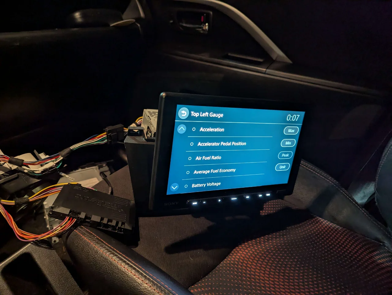

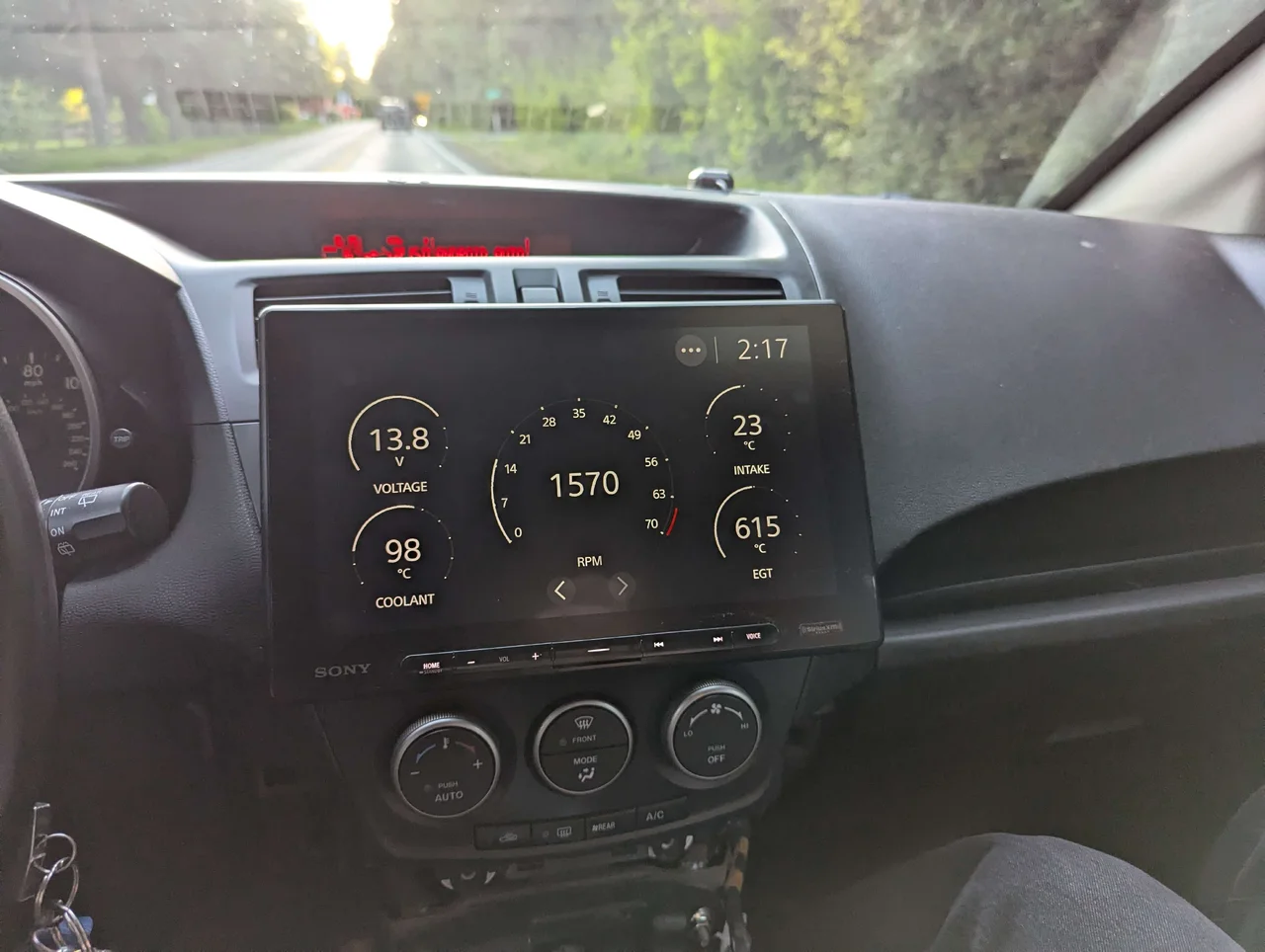

Here's a little update on the stereo!
Bought a Sony XAV-AX8500 as a parts unit for $150 and was able to revive it (borked screen connector and a little SMD fuse).
Unit is installed but I need some more parts before all plastics go back in place (microphone, USB-C etc). There's also a iDatalink Maestro box behind it with OBD2 connection and the gauges and info on the screen are really neat to have.

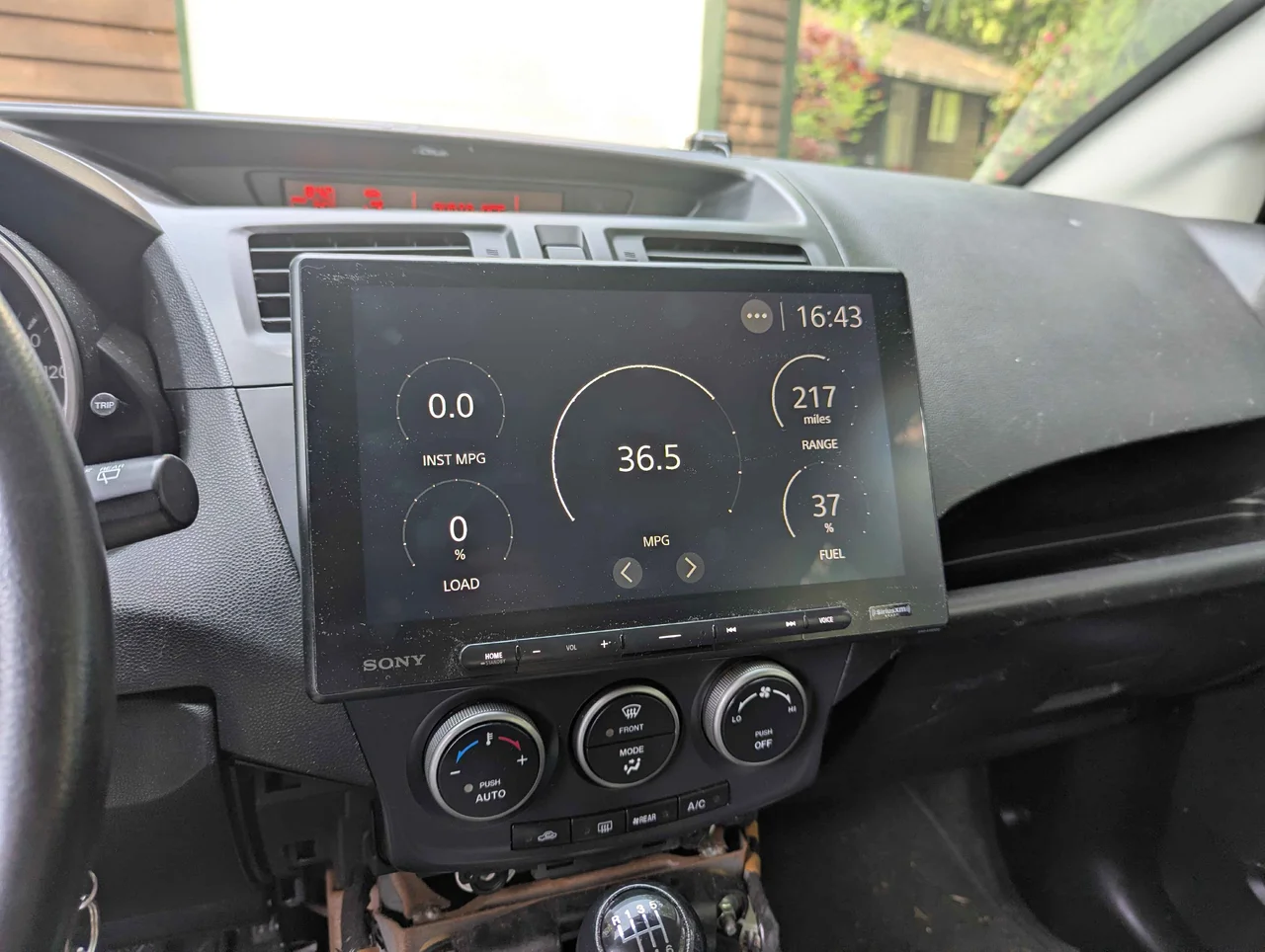

Driving with fuel stats present, I was able to get an average of over 36mpg (according to the OBD2 readouts). Next fuel-up will tell... I had gotten 29-30mpg otherwise.
View attachment 382999 View attachment 383000 View attachment 383001
Nice!!! I've been thinking about a nice big screen ugrade from by broke Pio HU. I've calcaulated 36mpg too, unloaded and all highway.
2007 4-speed AT 2.3 I calculated 36.4mpg on miles and pump data for a long steady speed highway drive. That seemed incredible, so pragmaticaly fudging the data downward I couldn't get below 34mpg.
