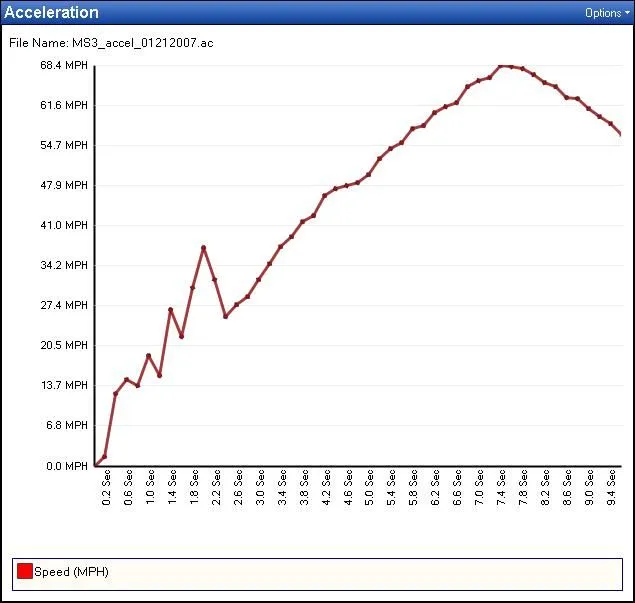

Het Rotus8, it also does power/torque measurements (per Gear) and acceleration times. Look at this thread to see my power/torque runs:
http://www.mazdas247.com/forum/showthread.php?t=123653857
Also, here is my latest acceleration run (0-60: 6.1 seconds):
The jagged curve up to about 40 MPH was tire slippage. I didn't flat-shift on this run; just traditional shifting. I should be able to pull 5.5-6 seconds with flat-shifting. Also, the SW will calculate your 1/8 mile time/speed and 1/4 mile time/speed, but i didn't go olong enough to give it the data to do the calculations.
Very nice times for not flat-shifting. Kinda looks like you know what you're doing. C&D shoulda let you run their 0-60 and 1/4 mile!

Thanks! I have been practicing quite a bit. I think the cold weather helps by increasing the intake air density and giving a little extra umph. It has been in the 30's here and I believe the C&D test was a bit warmer. The article doesn't give the environmental conditions during their test, but it looks sunny, with a California landscape. For 0-60, The flat shifting will only help the Speed 3 from 2nd to 3rd because it will hit 60 just after shifting.
