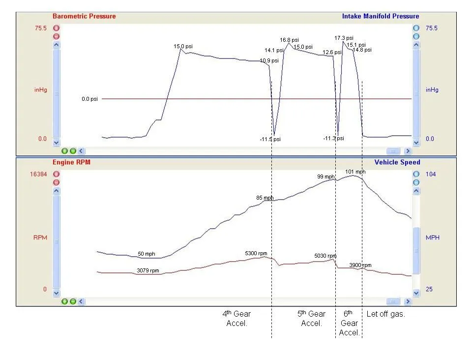

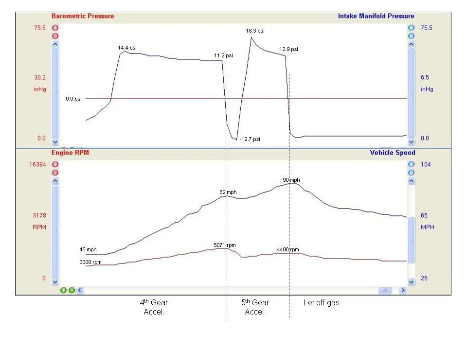

Ok, I did 2 runs today.
Run #1:
Roll on boost in 4th gear at 46 MPH and 3k RPM, then shifting to 5th gear at 5500 RPM and letting off the gas at 4400 RPM @90 MPH.
Ambient Temp: 44 deg F
Intake Temp: 41 deg F (dropped to 39 halfway through 4th gear boost)
4th gear: 14.4 psi initial peak boost, dropped steadily to 11.2 psi.
During shift: Dropped to -12.7 psi
5th gear: 18.3 psi initial peak boost, dropped quickly to 14.4 psi, then dropped slowly to 12.9 psi until I let off the gas.
Run #2:
Roll on boost in 4th gear at 50 MPH and 3k RPM, then shifting to 5th gear at 5500 RPM, then shifting to 6th gear at 5100 RPM and letting off the gas at 3900 RPM @101 MPH.
Intake Temp: 41 deg F (throughout entire run)
4th gear: 15.0 psi initial peak boost, dropped steadily to 10.9 psi.
During shift: Dropped to -11.5 psi
5th gear: Rapidly hit 14.1 psi then at a slower rate climbed to 16.8 psi initial peak boost, dropped quickly to 15.0 psi, then dropped slowly to 12.6
During shift: Dropped to -11.3 psi
6th gear: 17.3 psi initial boost, dropped quickly to 15.1 psi, then dropped slowly to 14.8 psi until I let off the gas.
I uploaded the graphs, but don't know how to put them into a message here.

Those numbers look good to me and show that it is running 16 psi and more when the load is there. I'm now thinking that what people refer as a initial spike is really a peak that decreases as the load the decreases. The higher your gear, the higher the peak and the longer it takes to come down from the peak. Add an incline like I did and it will hold the higher psi for even longer.

Ok, here are the graphs of Run 1 and Run 2. I added labels to the peaks and valleys.
I'll do more runs, but actually shift at 5500. Some of my shifts were lower RPM cause of traffic.
You were hauling butsky, bo. Thanks for putting those up. Good stuff. I got to look at them some when I get some more time.

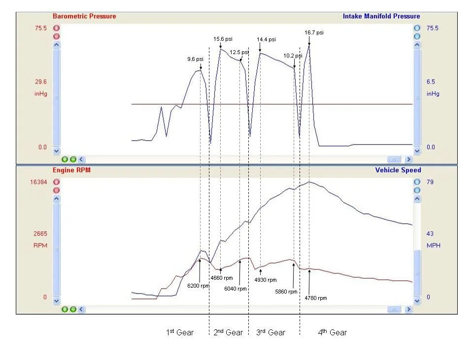

I have this data from a drag run on Jan 15th. I didn't do a good job shifting, so I'm gonna do another run soon, shifting at 5500 rpms per gear. Notice how the boost dramatically starts to drop off in second gear when It hit 6040 RPMs. Not sure if this was me or the PCM.

Pcm cut th% to 80% at 6k. Anyone know where the factory sensor is located or exactly how accurate it is. There is no way I ever get close to 15psi spike in second but measuring at the BOV might be the issue.

Anyhow, I think it's interesting that the decreases in slope of the boost line mirror the slope of the RPM increases. Maybe this the closing down of the throttle plate in gears 1-4 that AMS and others have talked about?
Also on the boost being lower in 4th, it got up to 16.7 on this graph before Speedy3 pulled the plug. And in the earlier graphs it had a lower peak than in 5th/6th, but they all settled down to the same level of right around 15. I'll do another run up an incline in 4th to check, but I think it will hold 16 under load.
