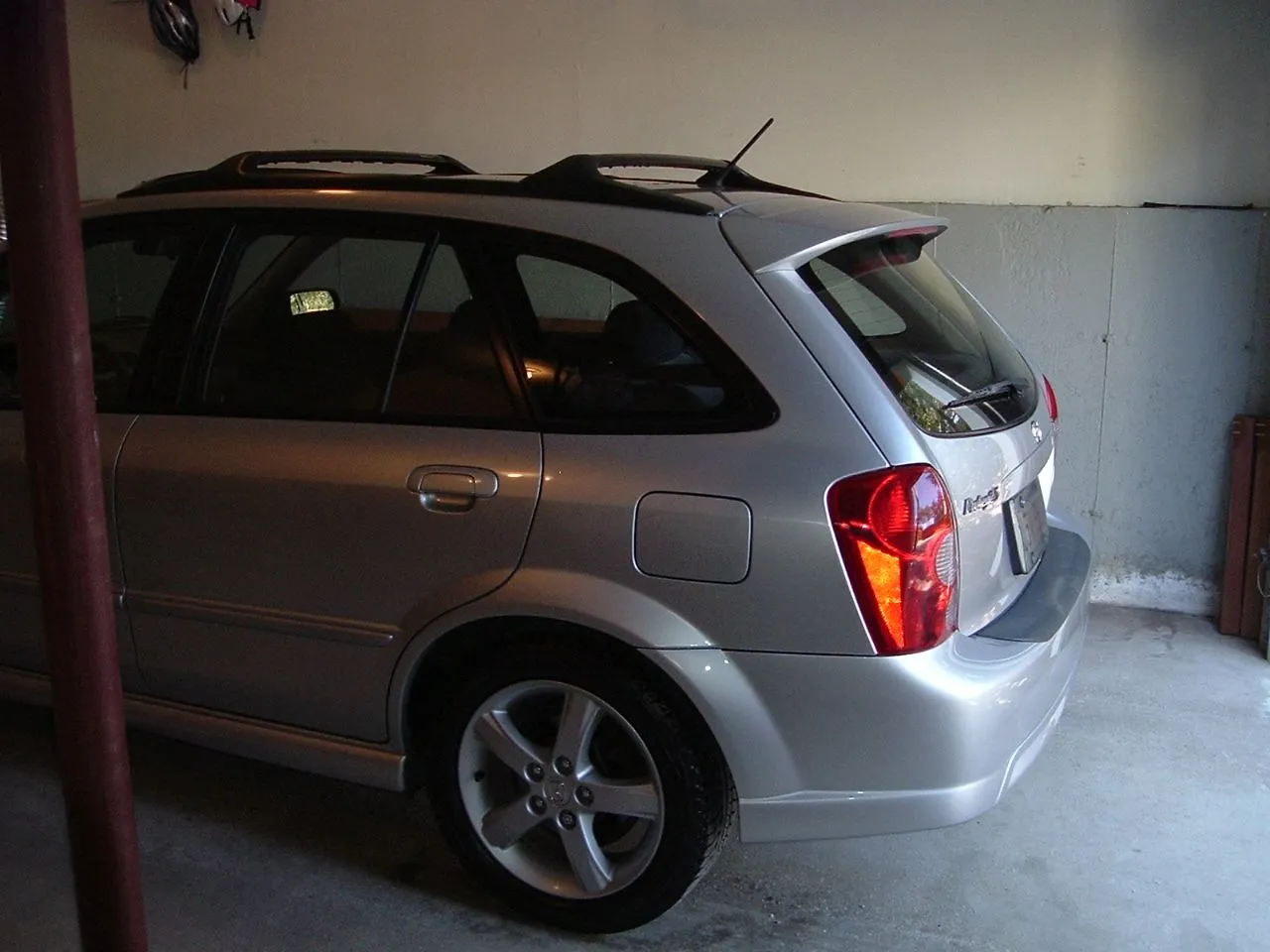

'Oh, and also installed an Acura RDX antenna...Only $6 from my local Acura dealer and it fits beautifully.'
Here you go...
Also, finally cleaned and waxed the P5 before the next snowstorm here in MA...What an effin long winter!
