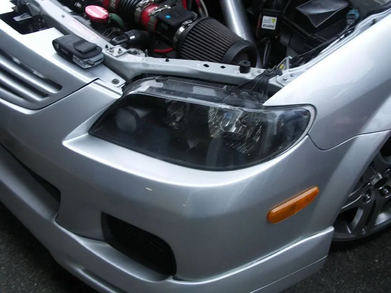

P5 sat yet again today, but the new headlights - black housing from factory :p - are getting VHT Nite Shades eyelids as we speak. Hopefully Monday evening I do the swap and then ship out the old headlights to an MSP owner in Seattle. :)

What my plan is - come spring when the P5 comes out of hibernation - is to get them covered. It's not Rockblocker, and it's not the 3M stuff either... I forget the name, but it's optically clear (much clearer than the 3M) and a lot thinner, but it protects from chipping just as well as a lot of the thicker stuff. With these pretty new headlights, I don't want them all chipped and pitted to hell. Pics of the new, eyelid-tinted headlights, below - they go on the car tomorrow evening hopefully.
I taped the headlights, but unfortunately it didn't quite seal in a couple places, and I got a little leakage from the VHT. Anyone have any suggestions on how to remove it without damaging the headlight lense?
