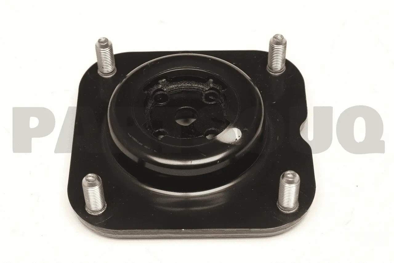

Amazon has the KYB rear right strut mount for sale for only $12, so I ordered one to troubleshoot my clunks on that corner. The other ones (rear left and fronts) seem to be regular price, and I'll order them if this one helps. https://www.amazon.com (commissions earned)
Rock Auto lists this part (KYB SM5457) as only being compatible with the sedan. I don't know if that's a fitment or firmness issue or if they're just wrong. Amazon seems to think the KYB part will fit a P5, forum member @Inside posted that he ordered this part number, and Rock Auto's page for KYB SM5457 (the one that *doesn't* show compatibility with the P5) lists "BJ3D28380" as the OEM/alternate part number... which is the part number for the actual P5 rear right mount per the parts catalog. :p
Anyone else used KYB strut mounts in a P5, and if so, did it work out? I replaced the original struts with KYB ones about six years ago.

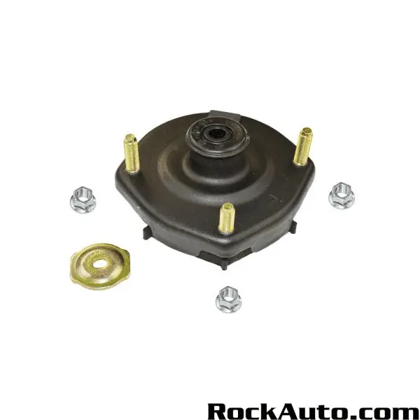

Yep, it looks like two of the three bolts on the OEM P5 rear strut mounts are longer, and it is to accommodate two double decker nuts for the retractor brackets (left: B25H-57-99XE, right: B25H-57-92XE) that are perched on top of the strut mounts as seen in two pics here: https://mazdas247.com/forum/t/boring-daily-build.123870720/page-28#post-6693313
Gabriel mount example:
Looking at my KYB part that just arrived, there's not nearly as much difference in length between the two longer bolts and the shorter one; certainly not as much difference as in the pic above or the OEM part shown in the linked pics. I do think there will be enough threading available on the bolts to fully tighten the two upper nuts, though.

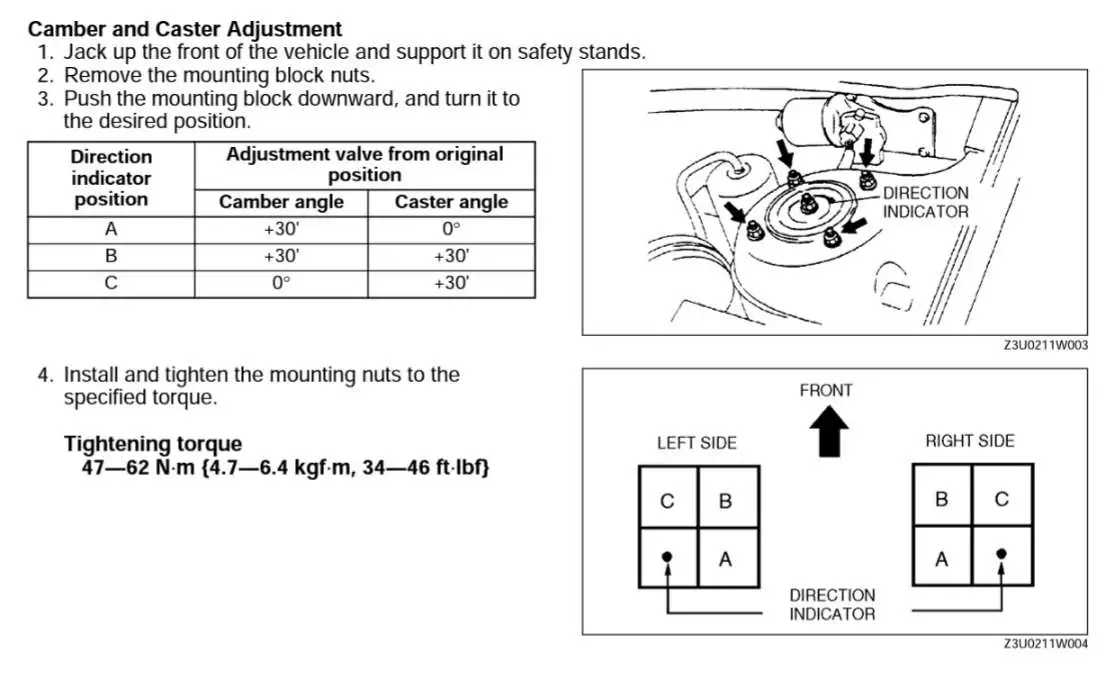

As for the *front* strut mounts, does anyone know if the lack of the "white dot" used for caster/camber on aftermarket mounts causes a problem? I'm guessing not, since you'd just use the notch in one of the sides to align the mount instead of that white dot as shown below.
EDIT: Now not sure if that notch can be used for orienting the mount.
It's the white dot that you use for orientation.
You can adjust your caster and camber by rotating your strut mount.
If you look straight down at the strut mount on your OEM struts, you'll see that the center of the mount where the strut goes though, isn't exactly in the middle of the mount.
Some aftermarket front strut mounts are centered so you have no caster/camber adjustment.
One guy bought aftermarket complete struts and the stut mount was centered and the shop couldn't get the proper caster/camber, so they had to oval out the 4 holes where the strut mount goes through, to get the proper caster/camber.

Hi PCB, I replaced the original rear-right mount with the KYB one today. The amount of threading on the new part's bolts was definitely less than the original. But it was sufficient even though Rock Auto didn't approve fitment of KYB SM5457 for the P5, only for the sedan. The original part still looked good, so I don't know how much the new mount will help. I replaced my bump stops alongs with the struts six years ago and now the bump stops are busted again on both rear wheels which may indicate another problem. (Springs? Shocks?) Our roads aren't that bad and I drive "spiritedly" at best/worst. Like an idiot, I didn't test the strut with it removed from the car, but really the car doesn't bounce hardly at all.
I'll wait to see if this one mount helps on the rear-right. If not, I'll give up chasing these clunks, but I'll be content because at least I know I tried. As for front mounts, I'm surprised to hear that some aftermarket ones are not adjustable. As good as the one old rear mount looks, it doesn't make sense to replace an adjustable mount that's in decent shape with an aftermarket, non-adjustable one. Wonder if I should just try and replace the bearings in the front mounts...

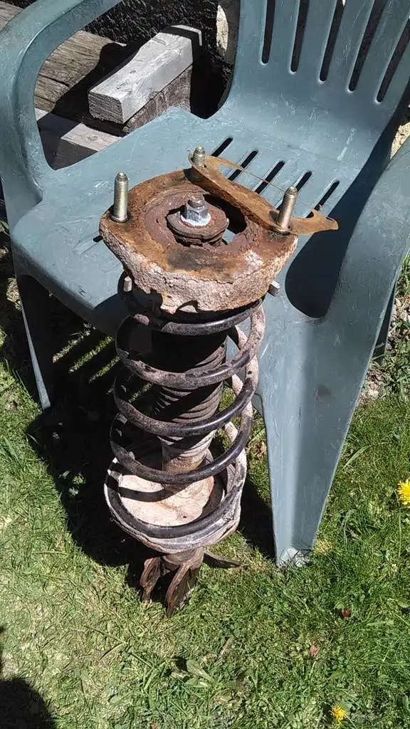

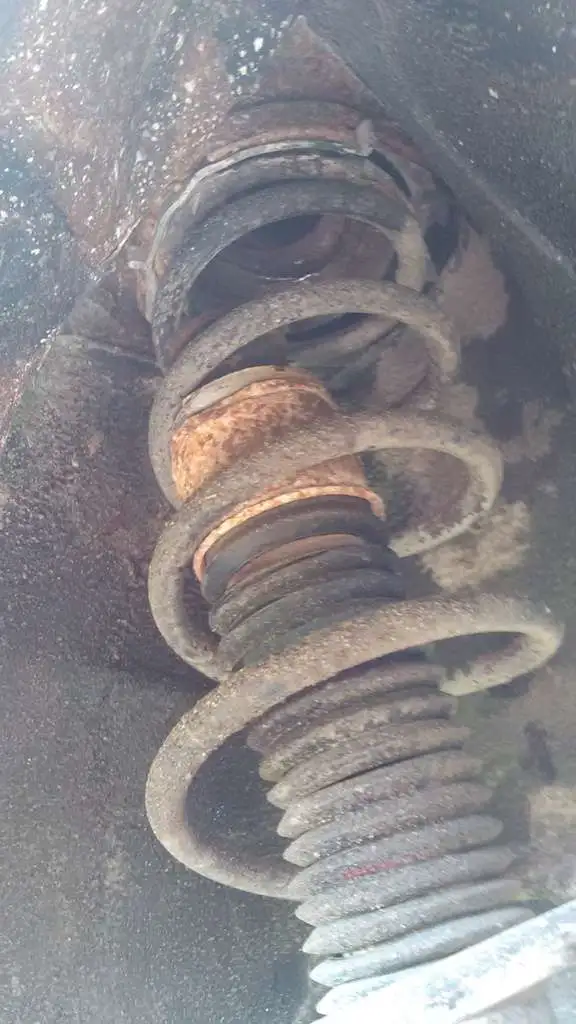

... I replaced my bump stops alongs with the struts six years ago and now the bump stops are busted again on both rear wheels which may indicate another problem.
I think it just means that you were using your bump stops A LOT and you just wore them out.
It's not just bumps in the road that compress your struts, hard cornering REALLY squashes them hard.
If your car isn't bouncing then maybe your struts are ok, but they may have lost some damping ability.

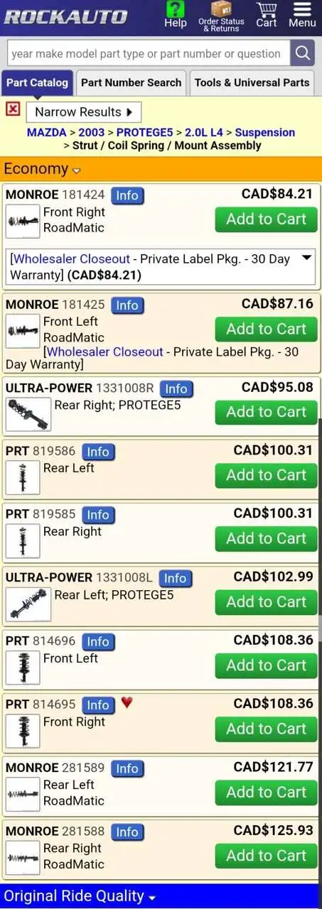

Anybody know what happened to the KYB QuickStruts (I think that's what they were called) on RockAuto? I can only find the base struts without springs or mounts. I don't mind putting everything together myself if I have to though. But if I'm having to buy springs anyways, I'd love to drop the car a tad bit. Man, if I only I could get my hands on some MSP springs...that would be sweet.
Having seen the recent conversations about strut mounts, I'm a little hesitant to replace with aftermarket ones though. I would really hate to mess up my ability to align properly. Thoughts?

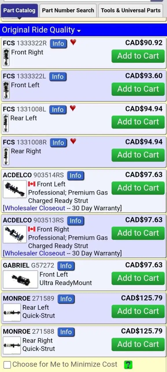

There are plenty of complete quick struts available from Rockauto...
Get yourself a set of OEM quality struts that can take a 's*** kicking' and some adjustable Camber bolts to straighten up your alignment.
(They don't do Caster bolts though.
I wonder what's up with that ?)

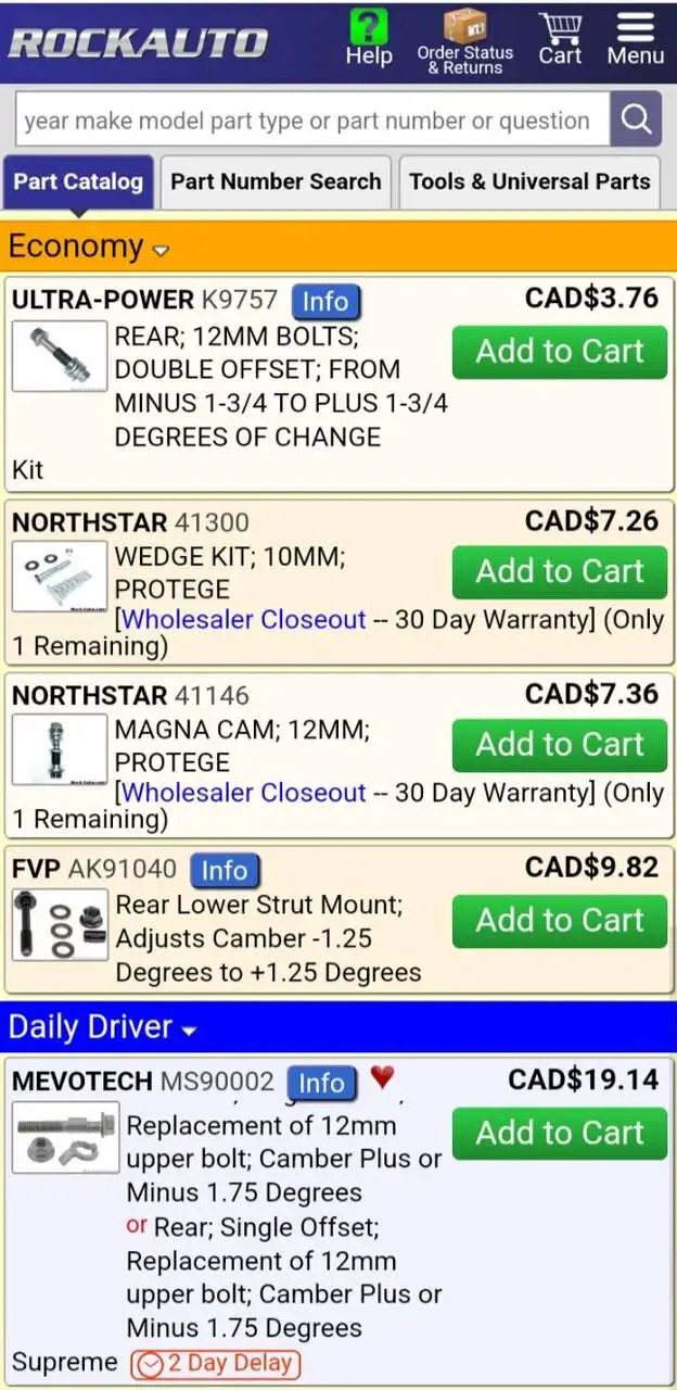

I see. I think I was getting the KYBs mixed up with Monroe. I will take a look at the Monroes. I do hope that the Monroes hold up as well as the OEM struts have. I'm pretty hard on my car and the OEM struts are still good at 180k (unless someone replaced them with new OEM ones, which seems unlikely to me). I'm just fighting with a clunking/creaking noise up front which I'd like to eliminate.
I'm not really planning to lower the car at all, so I'd rather not *have* to do camber bolts. But are they just one of those things that is always better to have than not? They don't seem terribly expensive. I may pick some up just to have them, and if I need to install, I will do so.
I'm only seeing Monroe QuickStruts for the rear, and I'm doing the front's. Am I just blind or do they not make QuickStruts for the front's? The only Monroe branded ones are the "Roadmatic."
