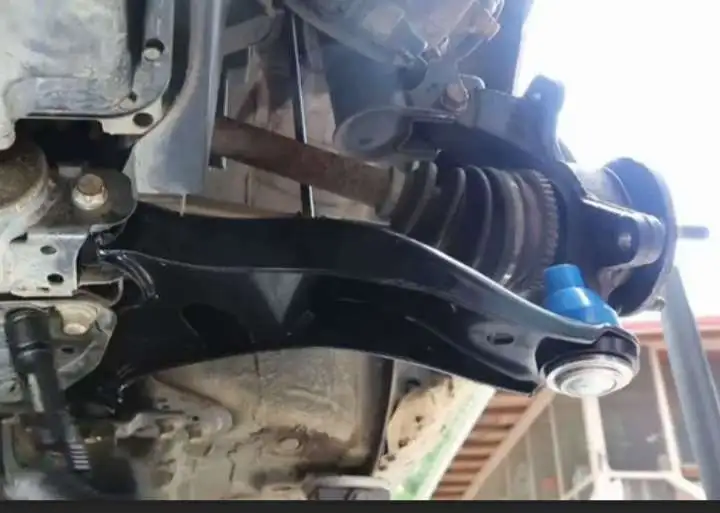

Watching that video, I have two comments - 1) I can't see a valid reason to remove the caliper from the hub. I didn't do it on mine and it doesn't allow you any more room to work.
I didn't do it on mine either.
I had to lift the knuckle up so far that the car lifted off the T-Stand on that side.
Then you crawl under your car with the car precariously perched above you.
Removing the brake caliper wouldn't give us more room to work, but it gives the LCA enough room to raise up horizontal without hitting anything while the car is still resting on the T-Stands.
