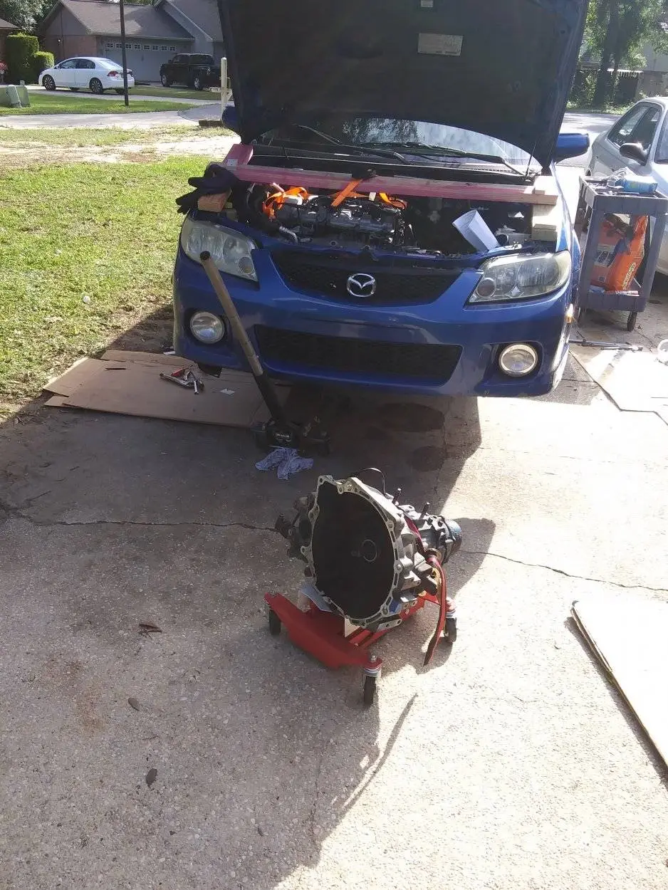

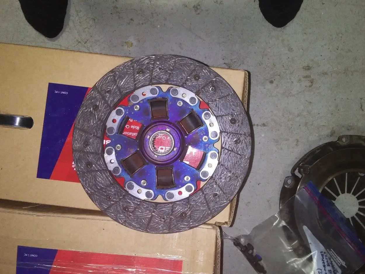

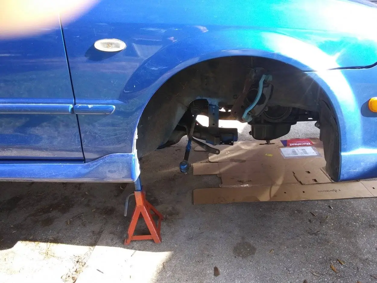

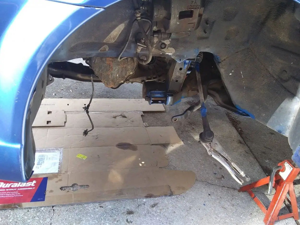

Pulled the transmission to replace...well... now turns out it will be "just about everything" once I got looking around.:confused:
Really thought the clutch was bad but turns out the throw-out bearing is trashed and probably the hydraulics.
Initially the clutch and pressure plate looked great when I removed them but then I noticed something odd about the clutch disc.
Is it me or am I missing something? Picture of disc below...
(Also pics of car prep before and after I removed the transmission)
Looks fun. I have no clue what an OEM or aftermarket clutch looks like, but that one on first glance does not look like what I think a stock one would. Did your flywheel have any noticeable warping (shuddering while slipping the clutch a lot)? Seems like a common Protege issue.

Here are a couple of pictures of my son's $750- P5 that I'm working on.

Clutch pedal would engage right at firewall so there was some judder there when releasing the clutch pedal and then judder again when backing off the gas in gear.
I adjusted the clutch pedal so the MC pushrod would engage higher away from firewall but then got metal noises (likely throw out bearing).
Reverse would be tough to get into so I figured the hydraulics might be weak (going to replace the Clutch MC and Slave piston as well).
No apparent warping or damage notices on flywheel and fingers look good on the pressure plate. only real damage is the worn out throw-out bearing that appears it would have fallen apart real soon.
What gets me about the clutch disc, it looks newer than OEM (different friction material) and it doesn't have 6 springs to fill all 6 spaces on the clutch disc face like my replacement disc has.
I also don't know what those 4 solid things are that are replacing normal springs.
