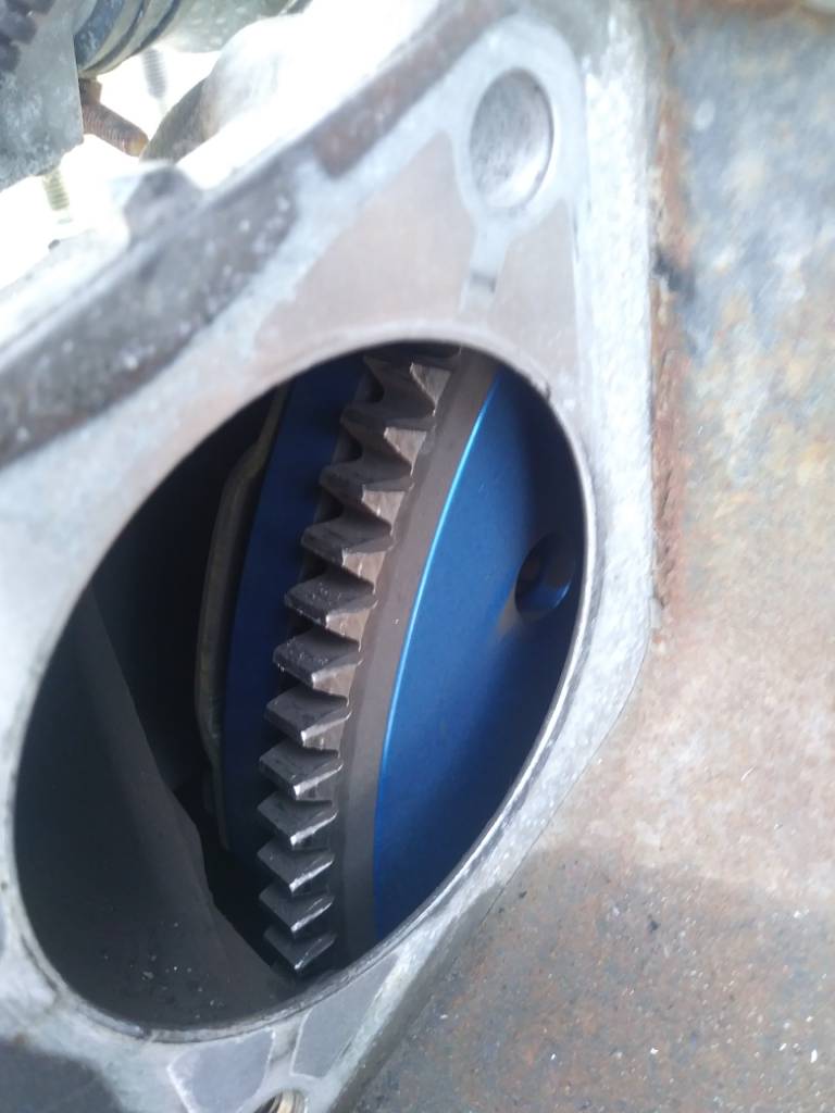

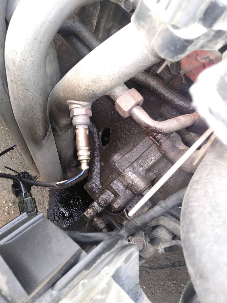

Holy moly, is that the transaxle? Top or bottom?
Front of the block. It evacuated my oil all over my headers, engine bay and road.
From 120 km to dead in 200metres.
Already pulling donor, upgrading to LSD and lightweight fly wheel, may as well do some other swaps while in there ( stainless brake & clutch lines, short shifter ).

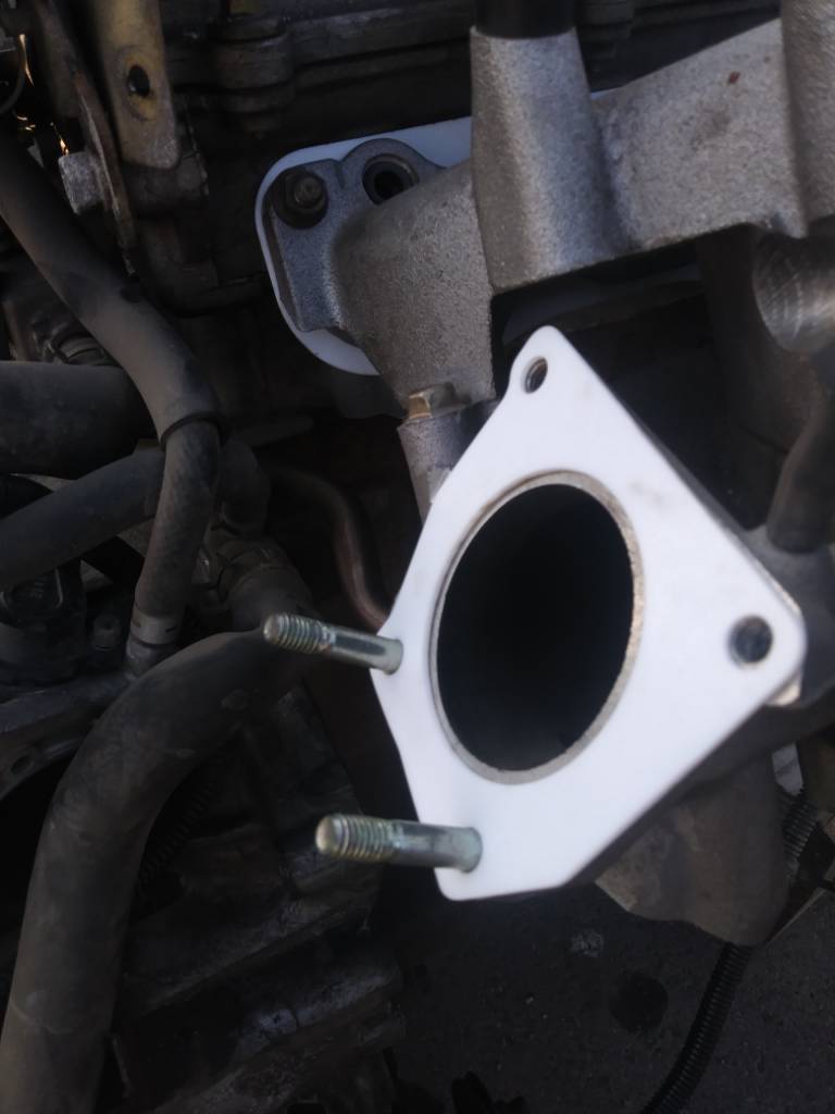

Prepped donor engine with hydramotor sports thermal gaskets and 626 intake. Confirmed lightweight flywheel. And hopefully is actually an LSD, not ripping it apart to check. ( There is a limit lol ).
Minor upgrades but stoked to get it put in !

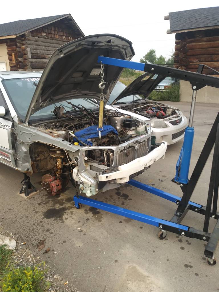

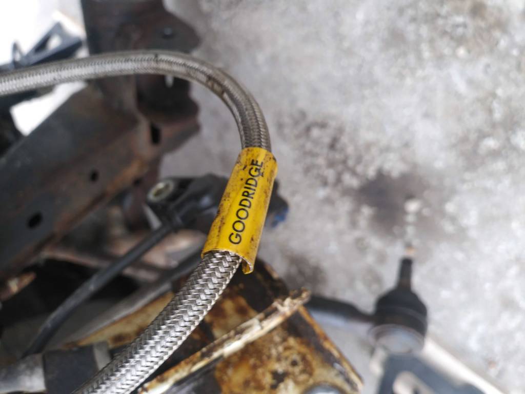

Its just motivation to get on with things
Let me know where you get that clutch line from. Looking into upgrading as well.
..Let me know where you get that clutch line from. Looking into upgrading as well.
Okay, will do. I have pulled it from a parts car. The brake lines ( yet to pull ) are branded "Goodridge". They appear the same as clutch line. As for the exact part numbers I have messaged the original owner ( who built it for solo2 a few months from new ) however he is up north working for a few weeks, but has all the original packaging etc for the upgrades. He also has a virgin stock transmission ( less than 2k kms ) and stock suspension in same condition I mean to pick up as backup.
I have put 2500 kms on this since I swapped engine & transmission. I am blown away by the flywheel and LSD. It revs SO quickly and applies torque wickedly through corners. The act clutch has taken some getting used to ( very quick engagement ).
Thoughts on upgrading, it's funny you bring one system up and notice all the other bits that need attention. So, the clutch line is nice & solid, however I can't help but notice my slave cylinder now likely needs replacing. And if I am to do the slave, may as well upgrade the master ( 929 master ). As this is the path I seem to have chosen, I may as well do it properly.

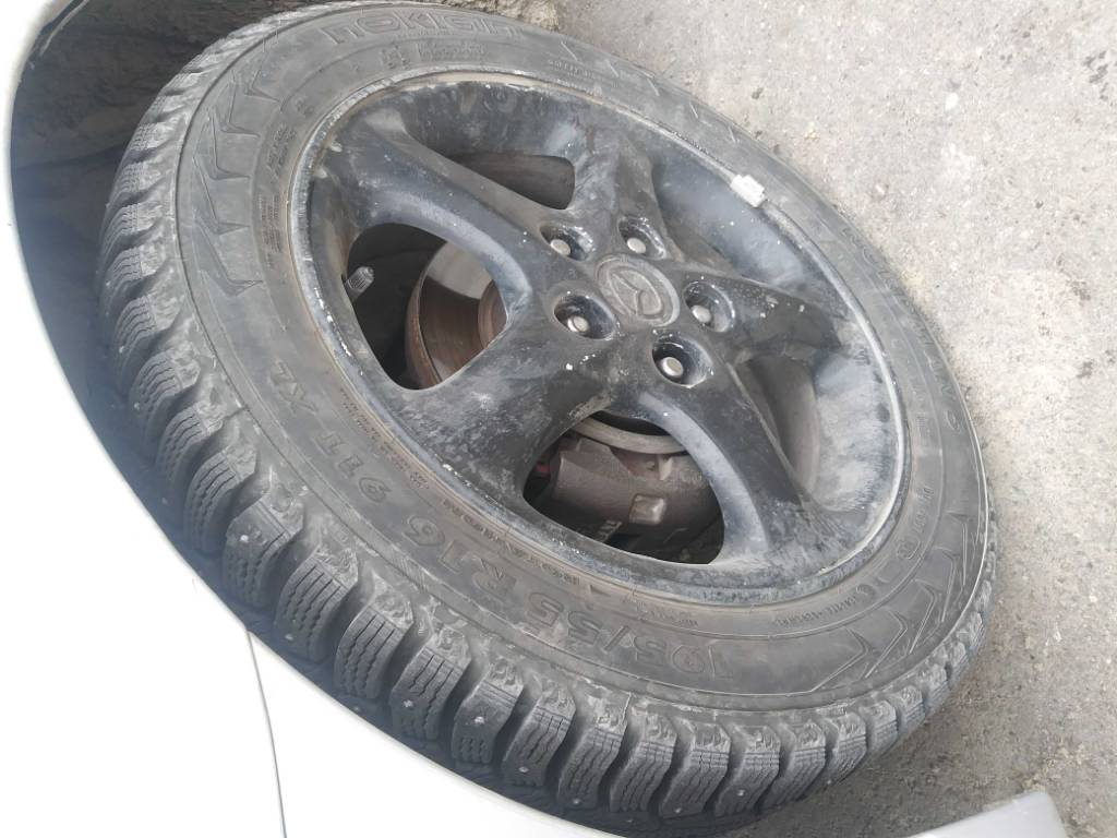

Oh, and like PCB I put on winters ( had to find toque and gloves today, snow isn't far off... ) I got a deal on four mounted on stocker rims ( Nokian nordman 5 195/55/r16 studded ). And no, I didn't paint them, came that way.
Actually the temperature is going up to 29 C (84 F) so I put my summers back on for a while.

( Nokian nordman 5 195/55/r16 studded )...
I was thinking snow tires might not be available in the stock size. (not that I looked into it)
We're not allowed to have studded tires in Ontario. Apparently they tear up the roadways.
