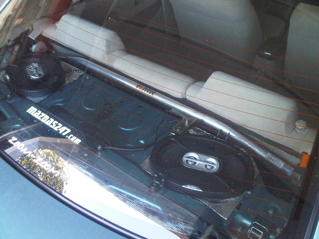

how did you mount that rear bar? interested in seeing since it was designed for a sedan.
I fitted it to the forward most strut tower bolt. If that's not right, uh oh
