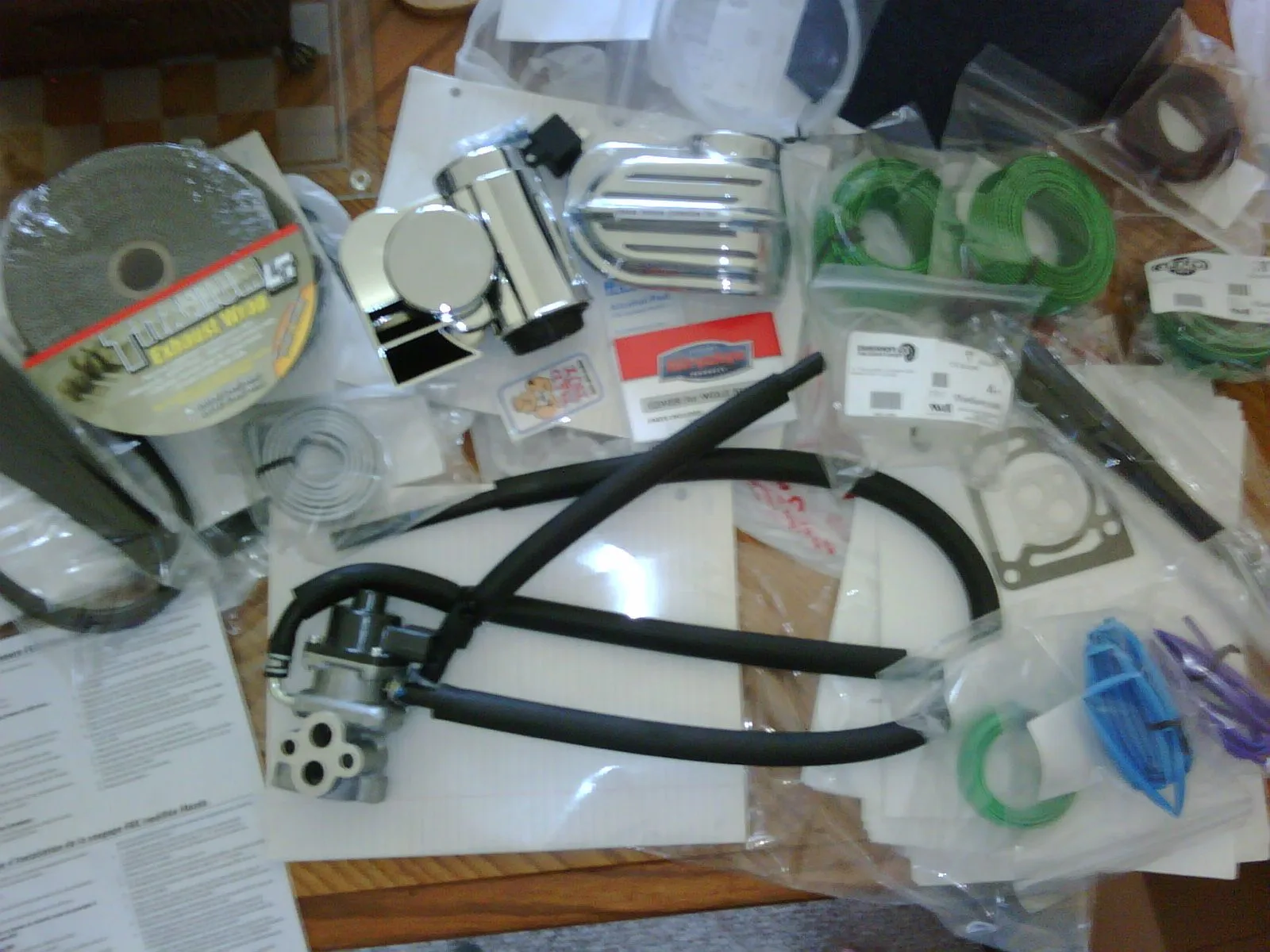

got some new parts yesterday!

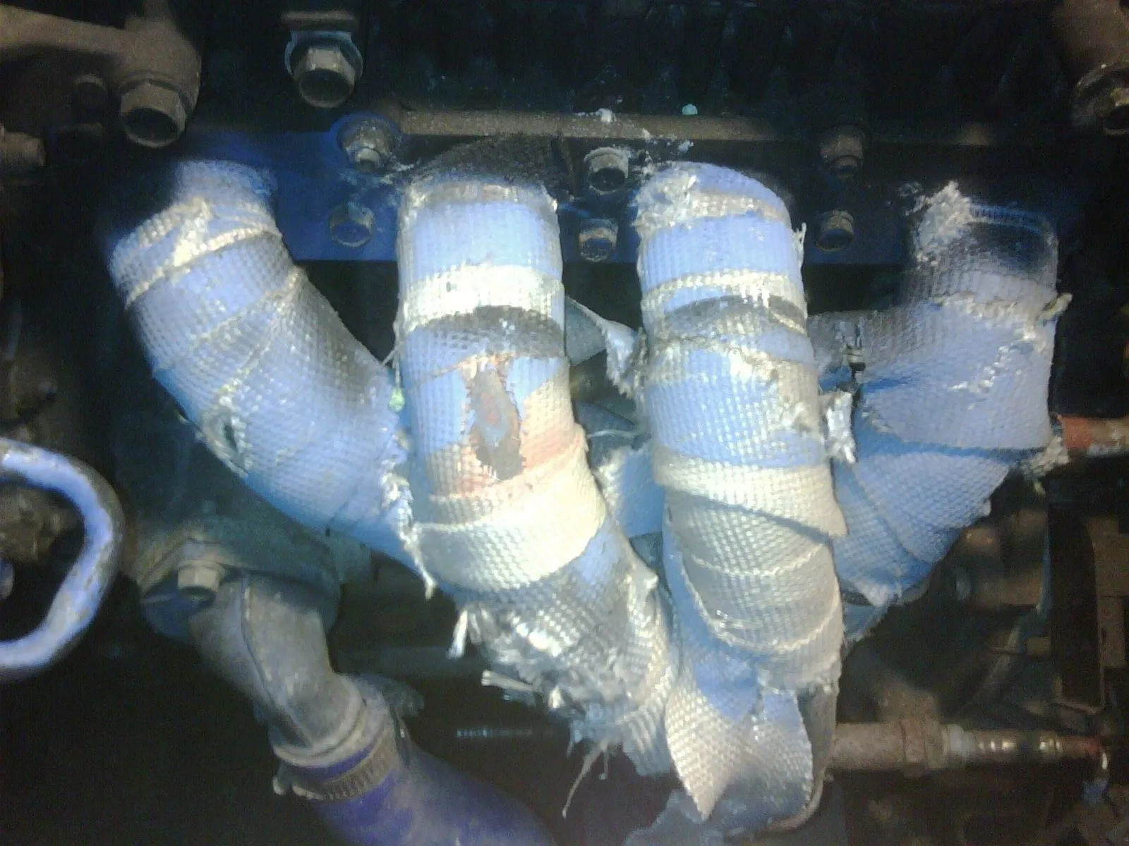

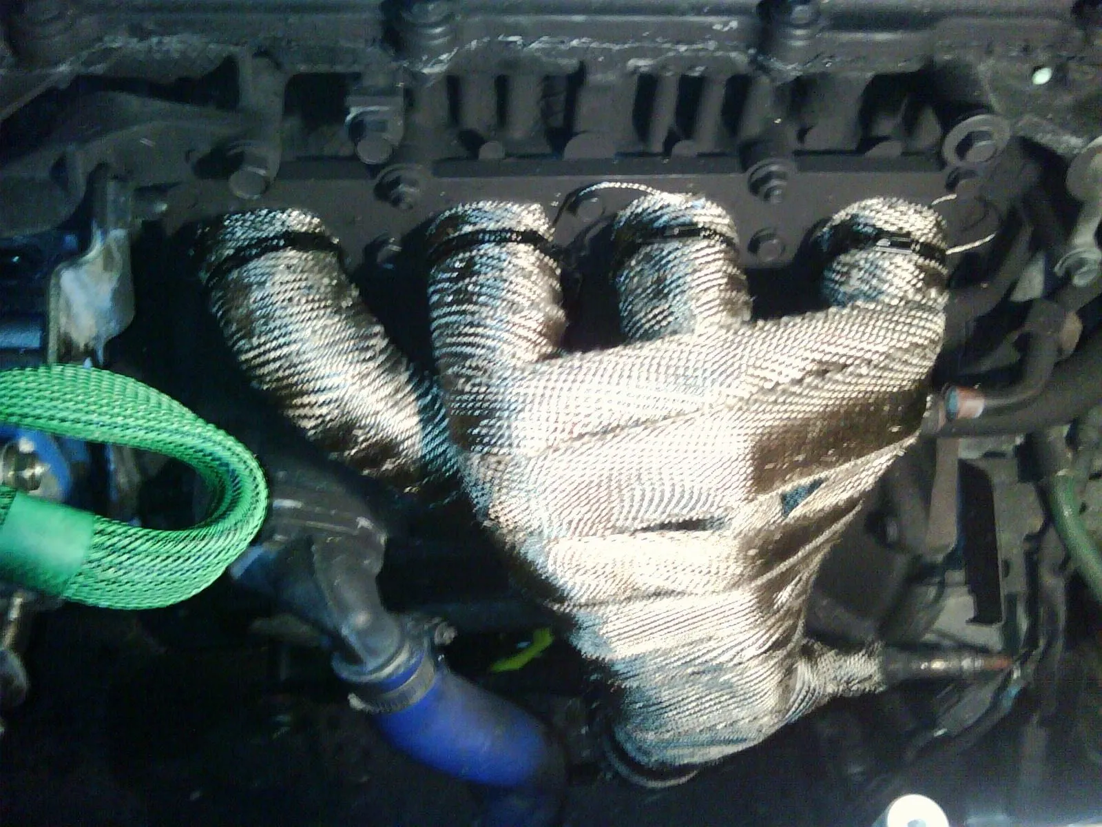

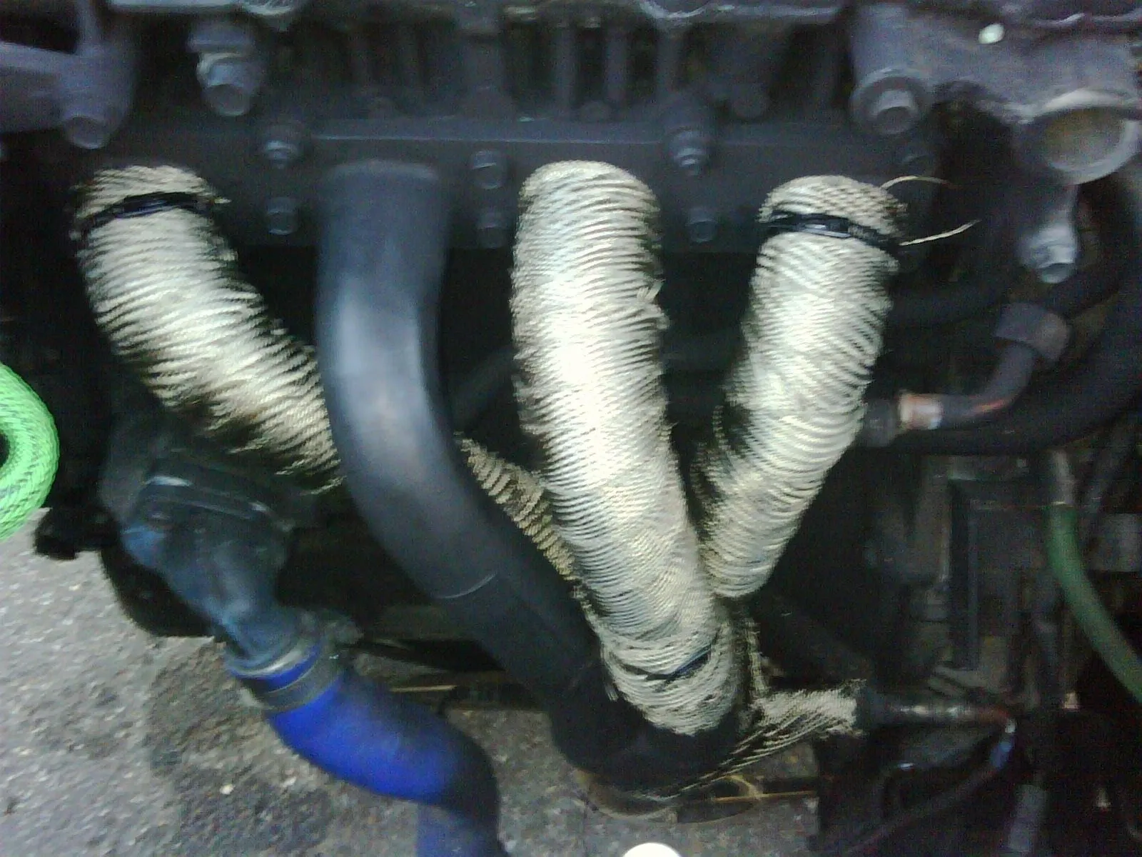

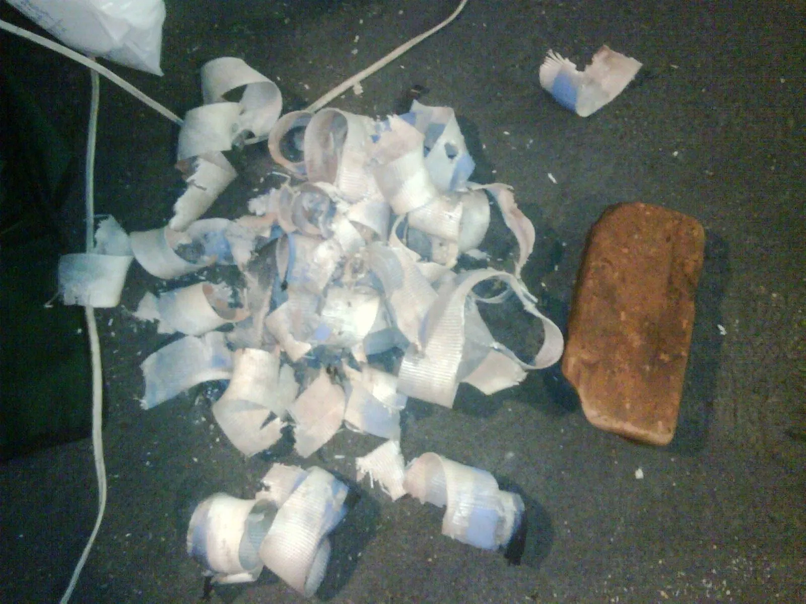

Wrapped Headers today. used DEI Titanium "lava" wrap. The previous was black fiberglass, soaked in water and wrapped, it crumbled like crackers when I pulled it off. The lava wrap is thin, I could see through it. Overlapped alot. used metal lock-ties, the locking type. pics are of old to new wrap.

^ i have that same horn!
i did have to make a bracket to lower it so it wouldnt be in the way of the grill.
if you need an idea how to do it just lemme know

That is an interesting EGR. My stock one sure didn't look like that....?
It's the "Canadian" EGR, two of those tubes are for coolant and the other is a vent. The body of it is also made of aluminum to prevent oxidation, it's a nice part :)
I installed one of those on my car when my old EGR was on its last legs, those bloody tubes make it even more of a b**** to install...
Ohh! That explains. Coolant? Weird? The only purpose and function is to recirculate exhaust gas into the cylinders for a complete burning of the fuel. I don't see why it would need a coolant line? Does it tap into the reservoir? My EGR is also aluminum with a plastic female plug. If you're boosted, why not just delete it and block it off? Wouldn't it be cheaper? Isn't it true that the EGR only really serves a purpose with NA engines? I might be wrong.
The way I understood how this new one works is that the coolant is there to keep the EGR warm in an effort to get all the condensation inside of it to evaporate out of the vent hose. It's a preventative measure to keep the valve from prematurely failing.
I think an EGR system can be useful on FI engines because the inert exhaust gas helps to prevent detonation. How it helps, I'm not sure ... perhaps someone can fill us in =/
