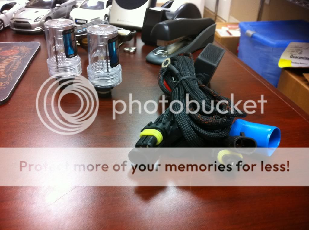

ordered some new bulbs (the ones in the car are dimming-going on 5 years old)
Also a harness (i know the connectors are wrong, but for $5, i cant complain)
Now hopefully i can get both sides working with the harness
Installed an hid wiring harness Amd have both lights working again, but no high beam on the passenger side, I think the solenoid crapped out on the projector
What kind of projectors do you have and how long you have them, because I have some Morimoto Mini H1 to install and you are scaring me here.
i've got Acura TL's, and i've had them for about 5 years
And i did it myself, i was running a 55 watt HID kit without a wiring harness, so eventually, my stock wiring harness took the hit
But if you run a proper HID wiring harness, you've got nothing to worry about.
And i've done 2 retros now with mini's and no problems with the projectors yet
HID's are a scary thing. I have DDM tuning 35W 8k iceburg blue now which runs great. They were $65 before tax from DDM, however, they don't have the additional wiring with the fuse that runs to your battery. This seems fine since they don't seem to pull too many amps. However, the first set I bought off Ebay was a little cheaper and I payed for it. The ballast was bad and after two days of working, blew something in my fuse box so only my driver side lights worked. The headlights on the P5 are wired in series so I figured something went bad from the driver's side to the passenger's side and wasn't getting power. Strangely enough, when I switched to high beams my passengers would come on and everything got a little dimmer. Turns out that a circuit path in the bottom of my fuse box broke. I fixed it myself which was great compared to Mazdas price of $405 for a new fuse box (the only wrecked P5 in my area has half the fuse box gone from the collision). I realized the high beams were pulling power through the driver's side lights in order to turn on. Crazy stuff, could of caused an electrical fire and I would be toast. Anyways, the safest HID is one that your car can handle, and go for one with the power harness just to be safe.
