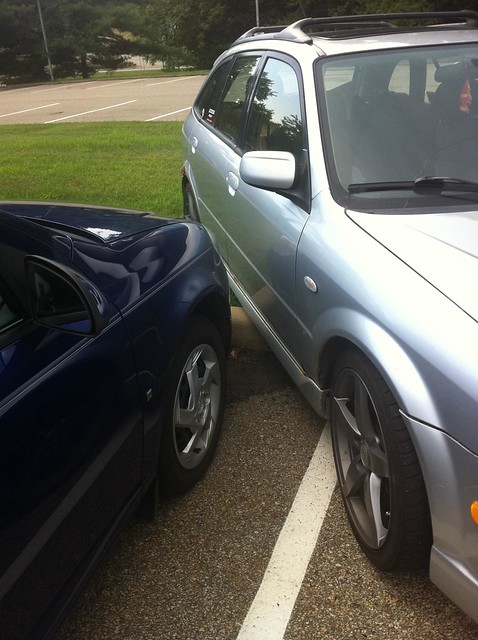

Well... not what I did, but what happened to my sister who is driving my P5. Ebrake failed. Car rolled down a hill and almost took out another car....
