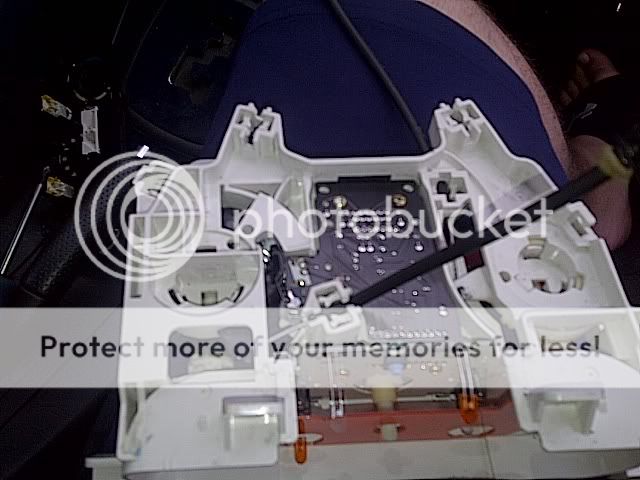

I fixed my Bluetooth this weekend (new hands free law) and modded the AC to be controlled by me and not where i put the fan control.

..............and modded the AC to be controlled by me and not where i put the fan control.
What do you mean by this? I noticed on my p5, that the A/C doesn't seem to work on fan speeds 2 and 3, just 1 and 4. The fan is still blowing, but the A/C light goes off and you can hear the compressor kick off. Sometimes the light will flicker on those settings though, so I didn't know if this was factory, or if there's a malfunction somewhere...
Ah HA! So it's not just mine...lol
Thanks!
i fixed it that way as well as this how to
http://www.mazdas247.com/forum/showthread.php?55382-How-To-Disabling-Automatic-A-C-Defrost-modes
