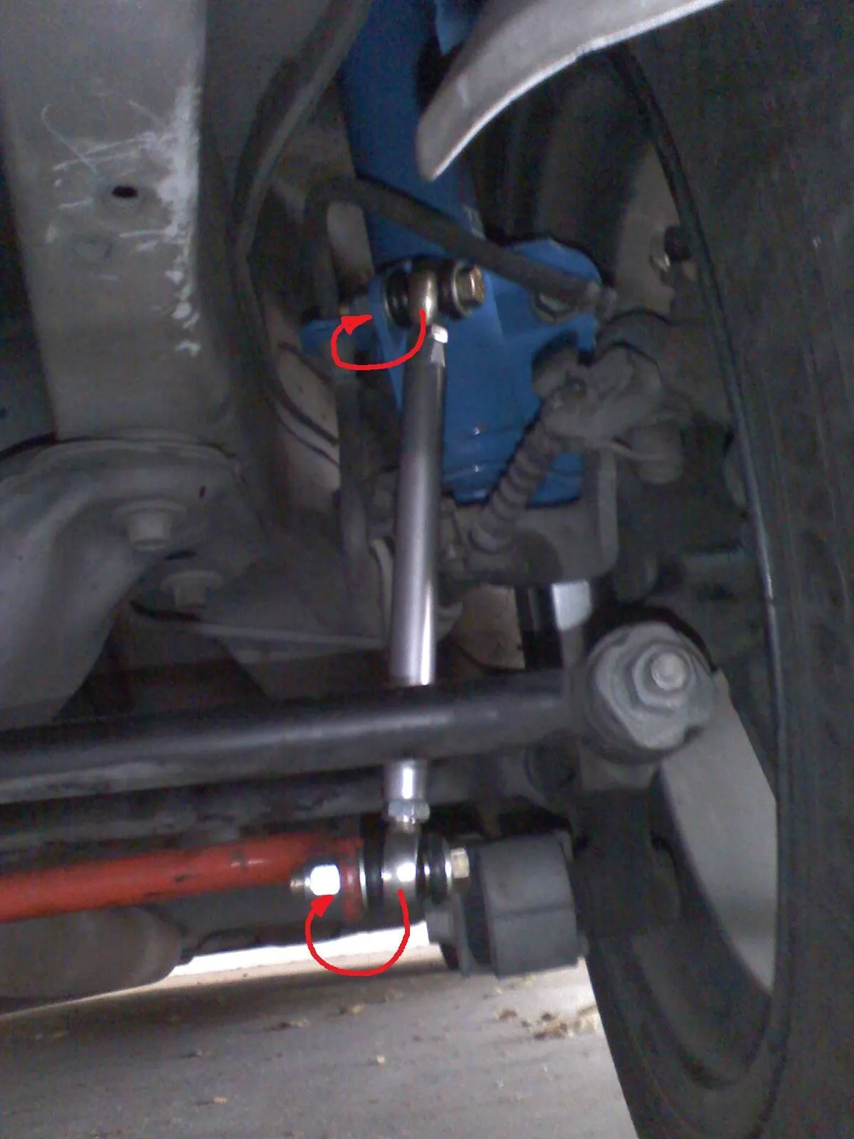

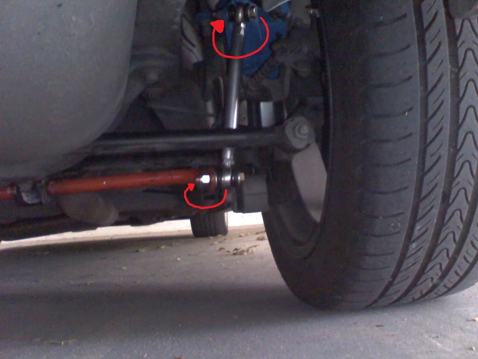

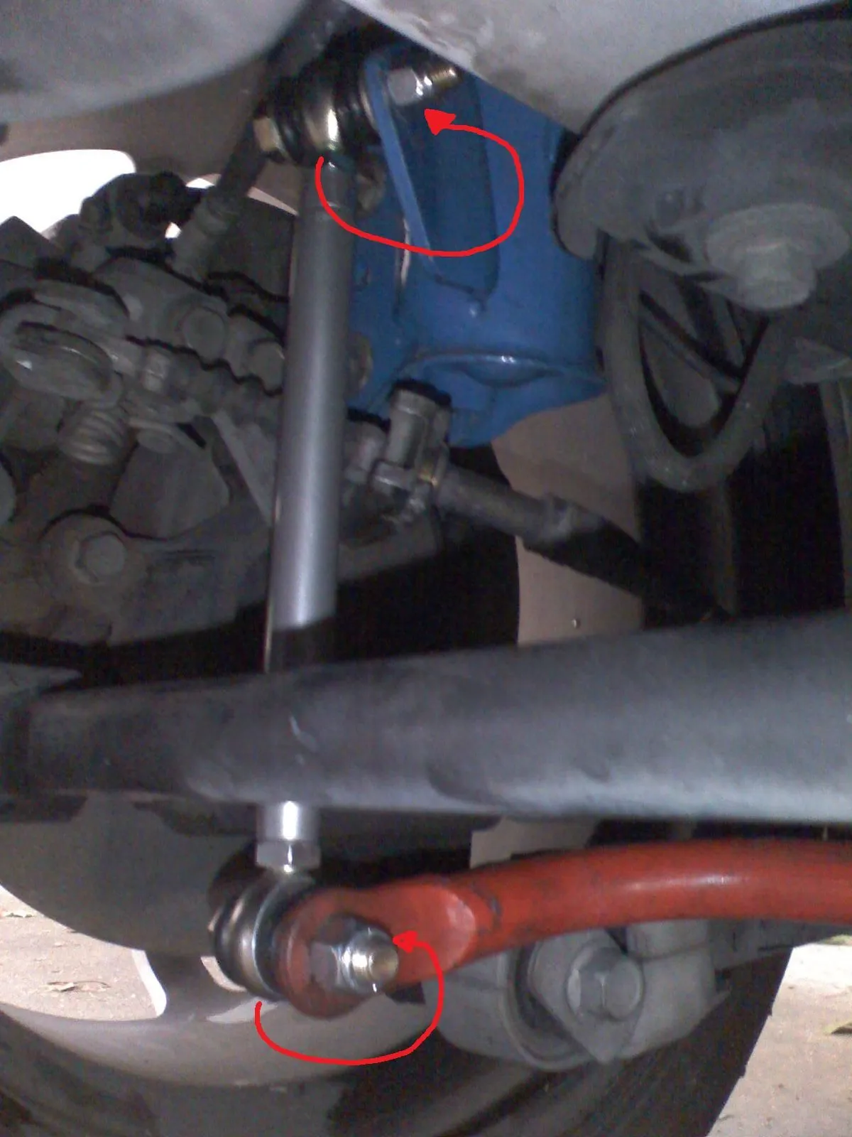

Can anyone tell me if my new rear awr end links are well installed on my P5? I got a doubt about which was the right side of the strut tab and sway bar?
HERE ARE SOME PICS ATTACH:

yea the tops should be on the other side of how you have it. Shane is right
According to the Mazda P5 manual, the nuts for the endlinks should both be on the outside of the sway bar and shock tab. The nuts should be facing you with the bolts coming from the back pointing towards you.
