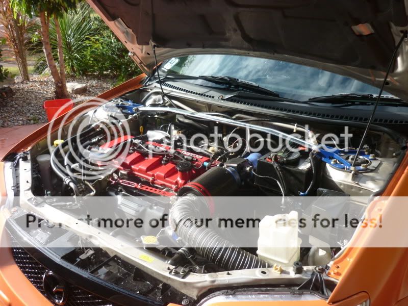

recieved and installed my corksport front strut brace.
makes a big difference.
