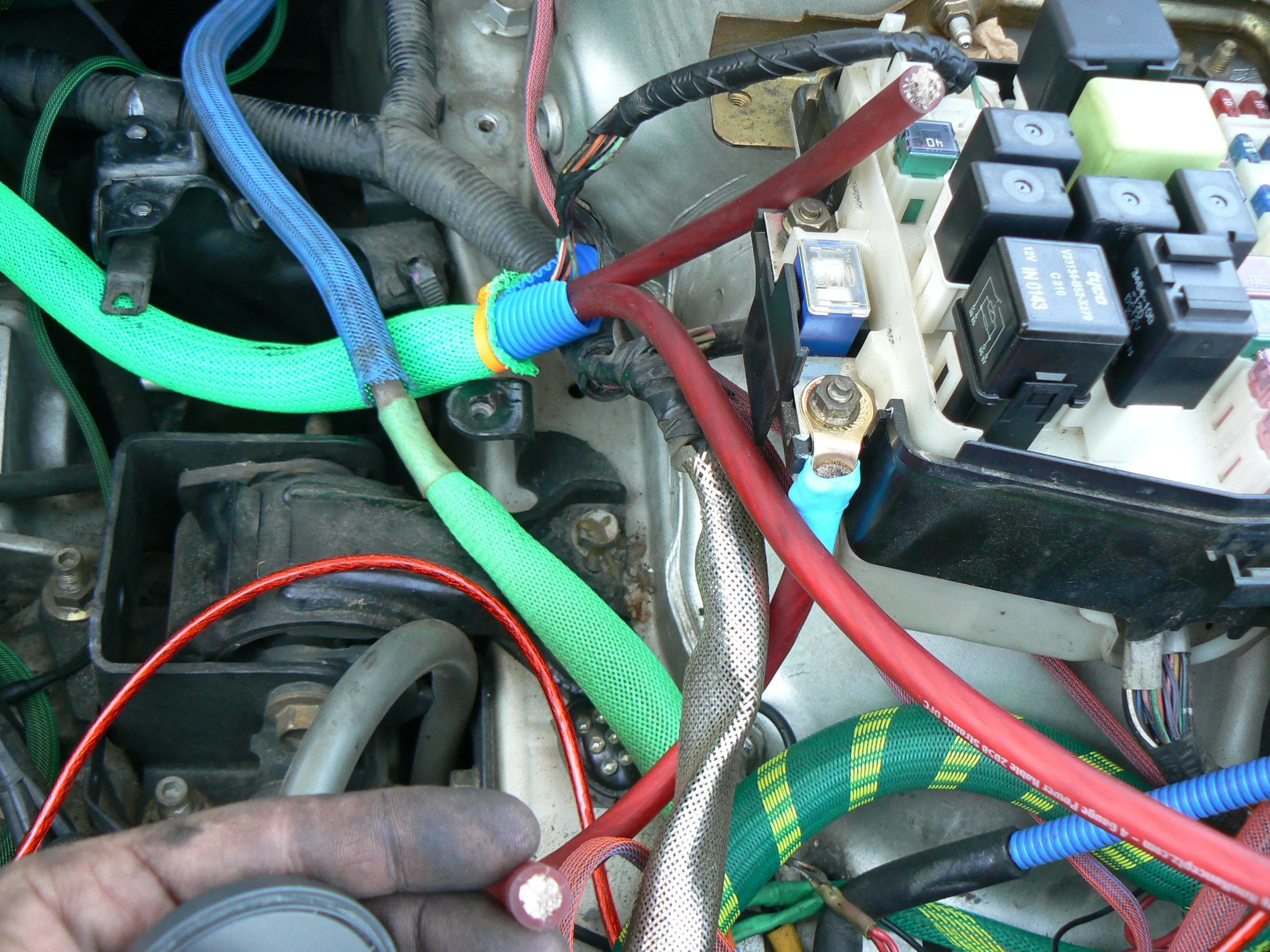

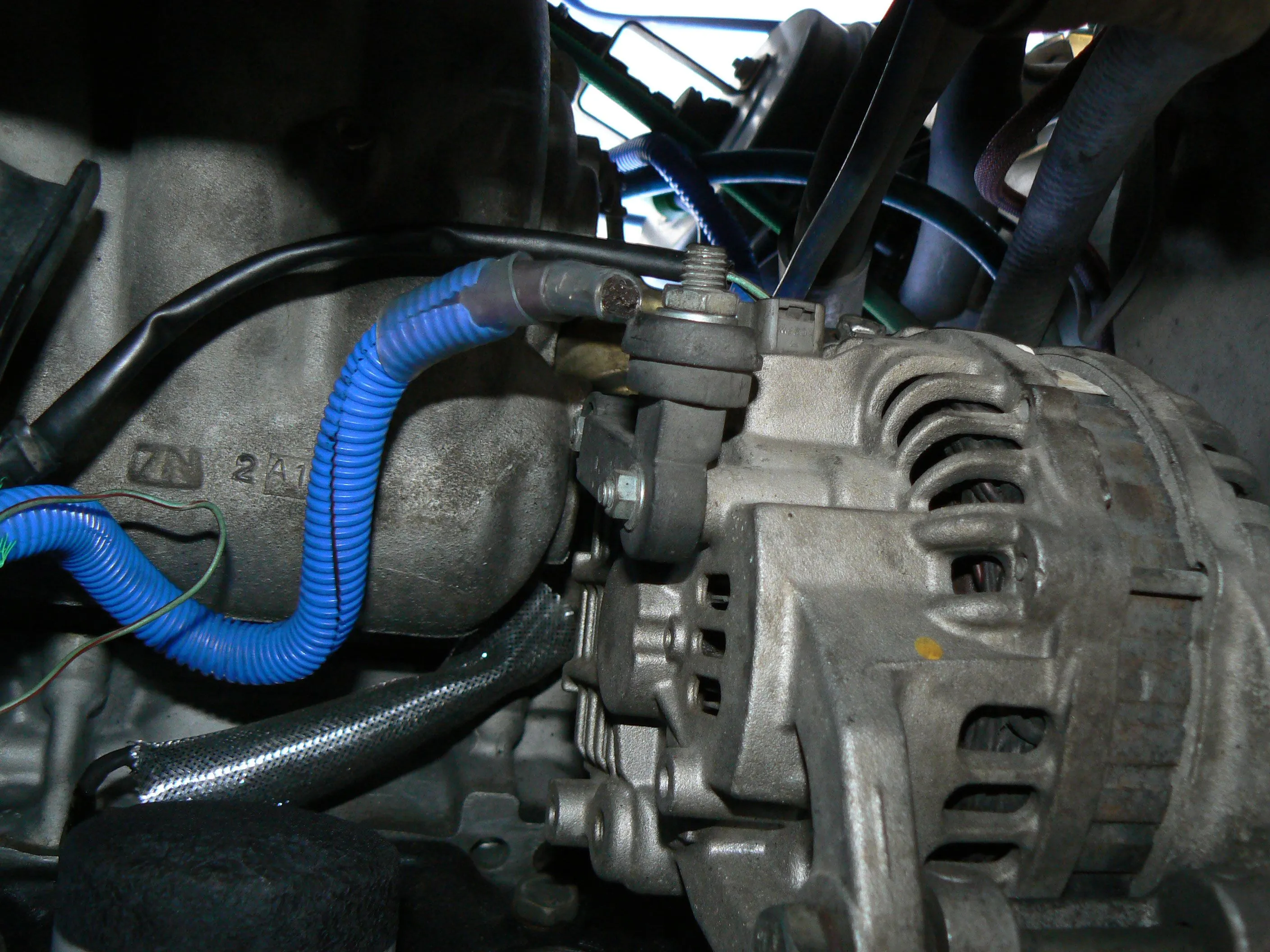

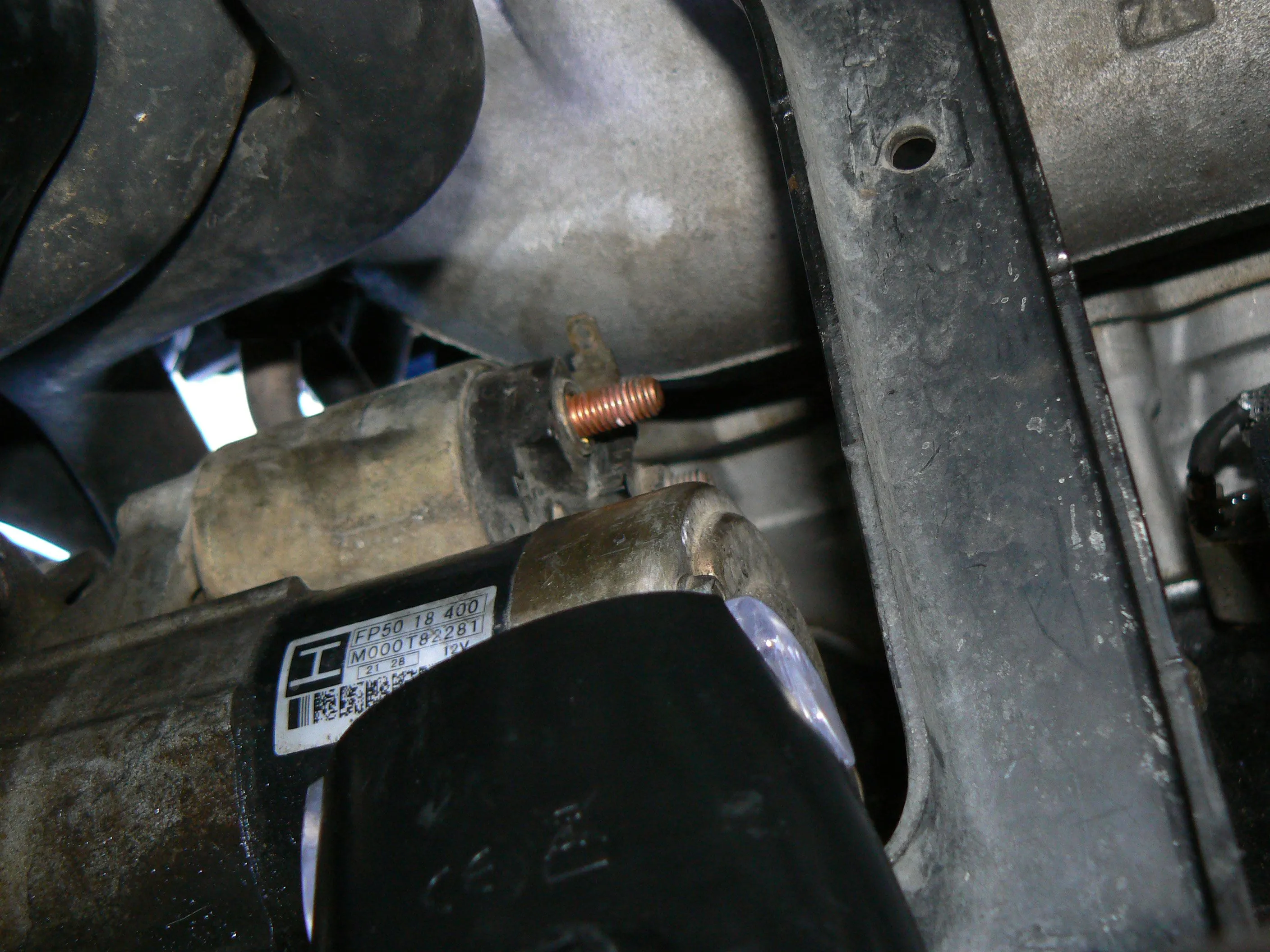

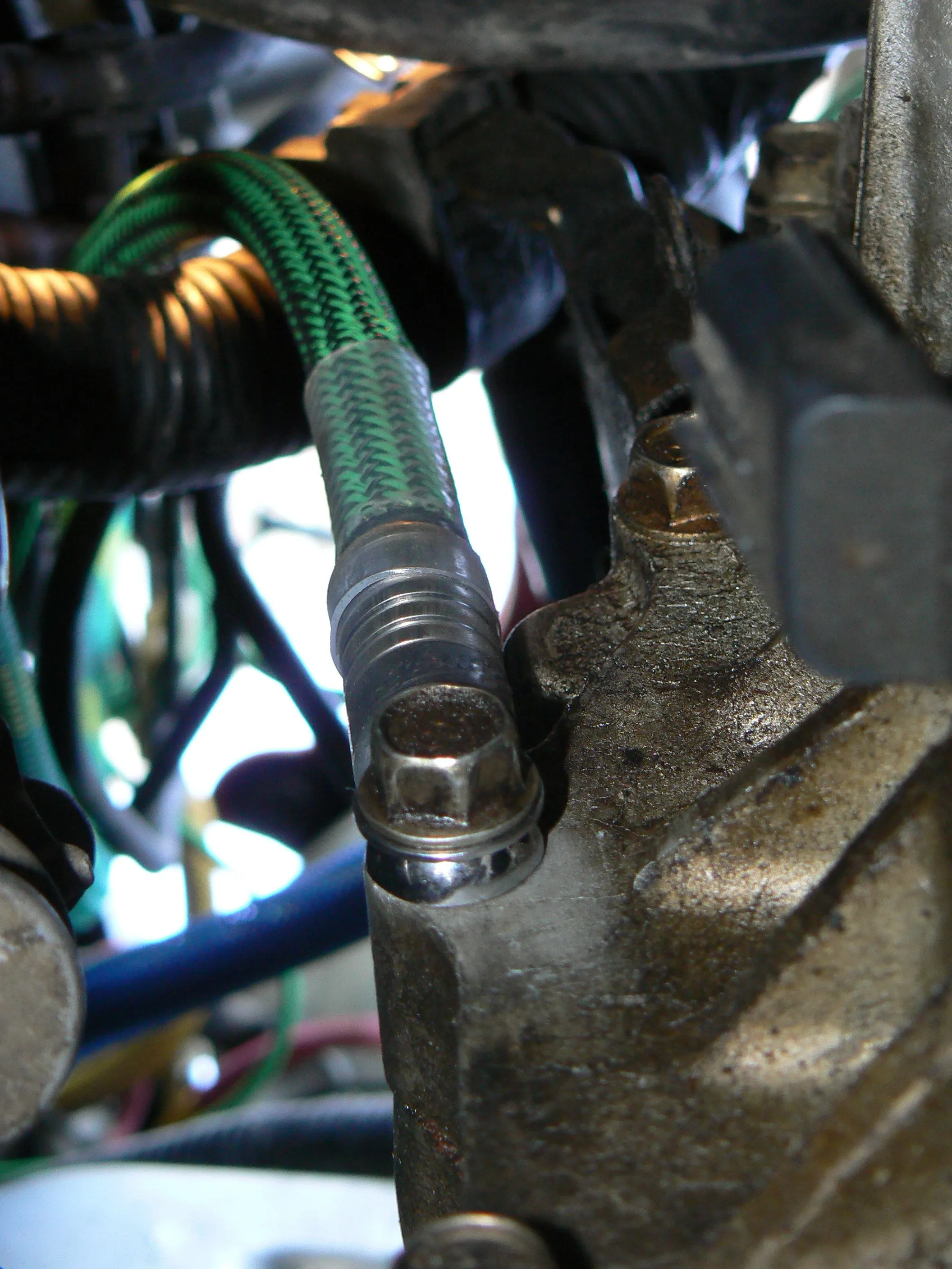

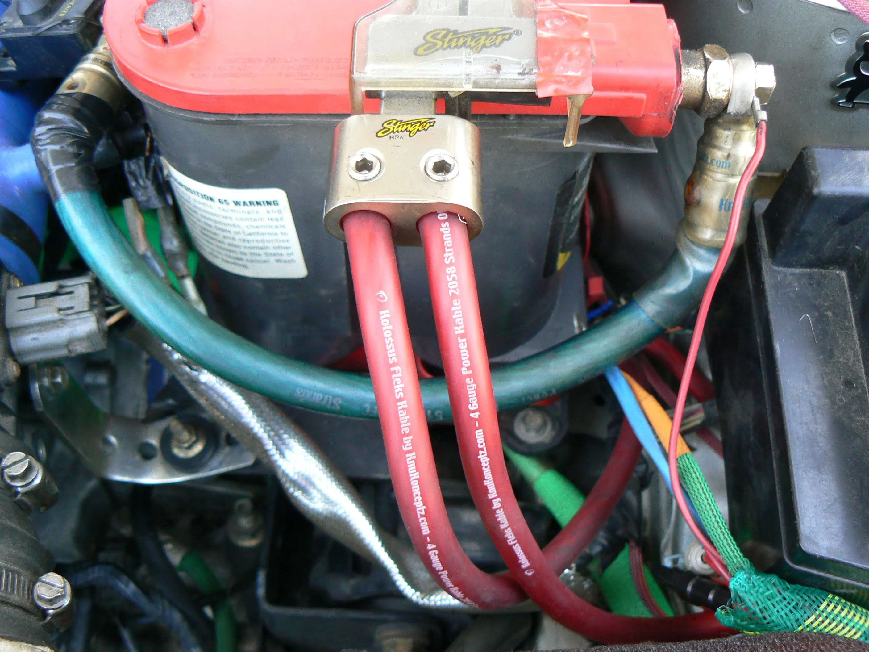

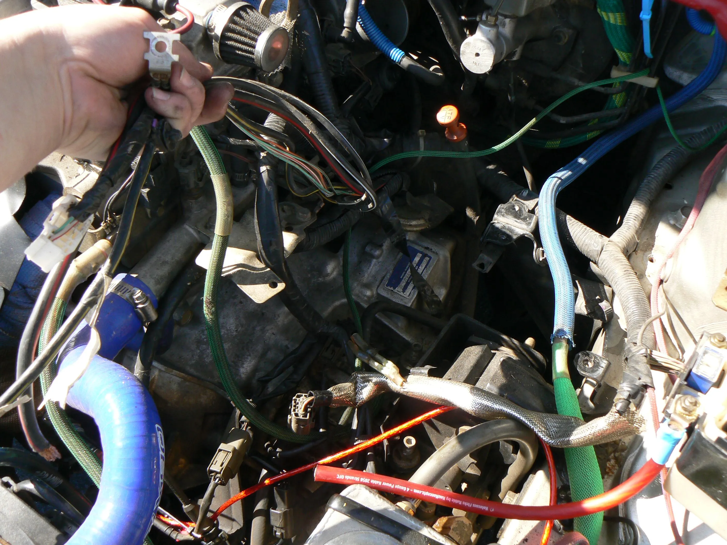

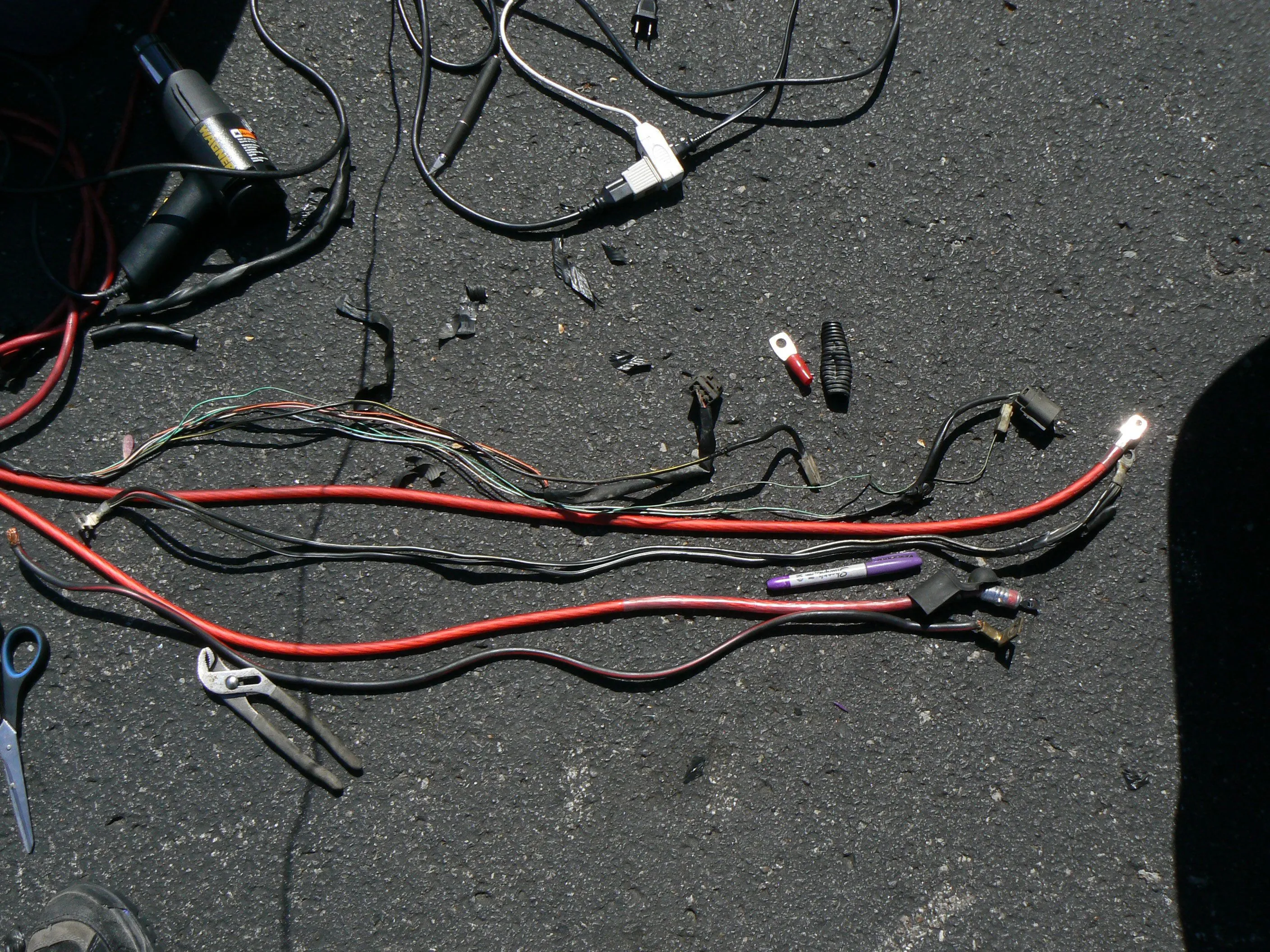

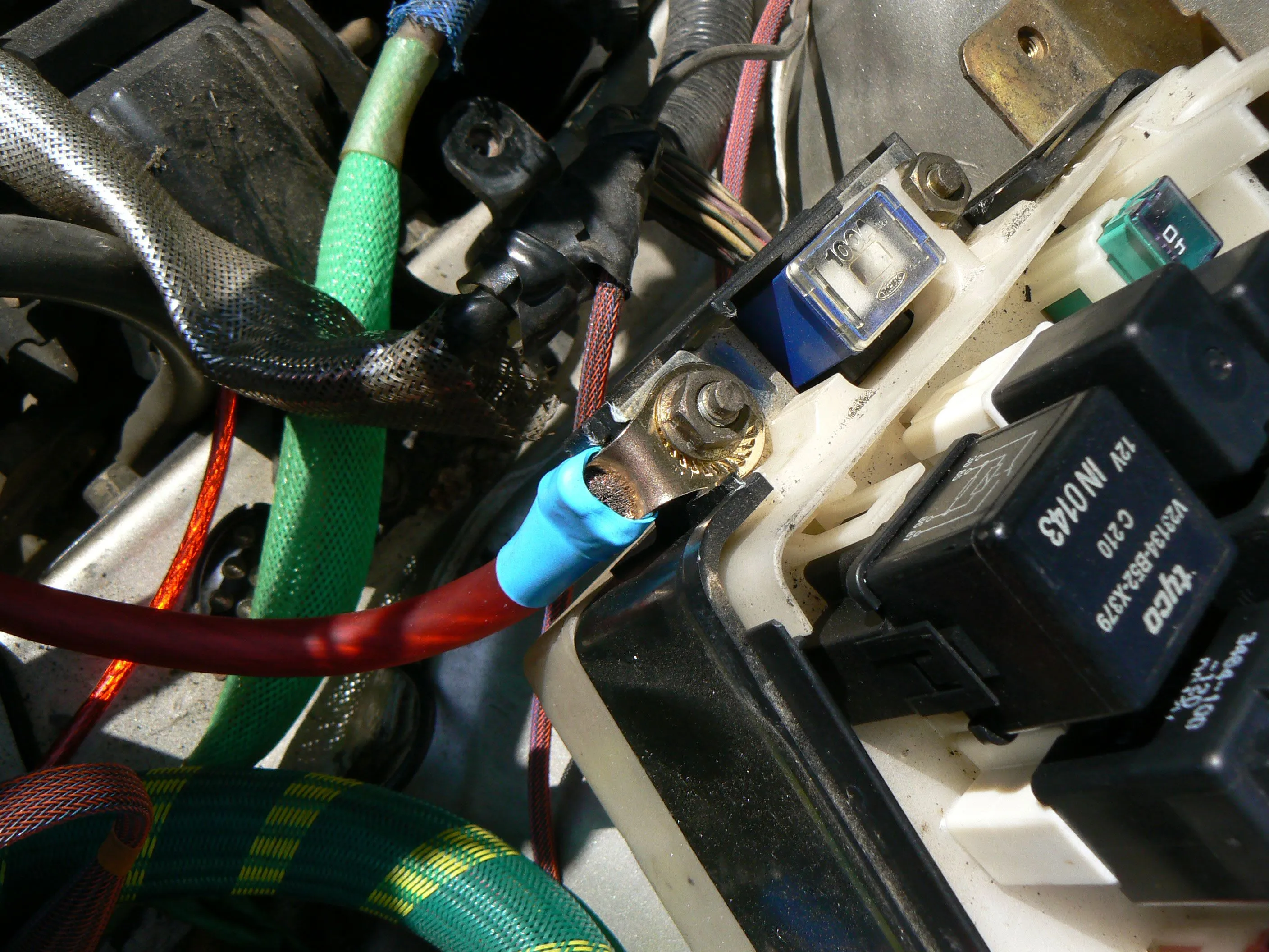

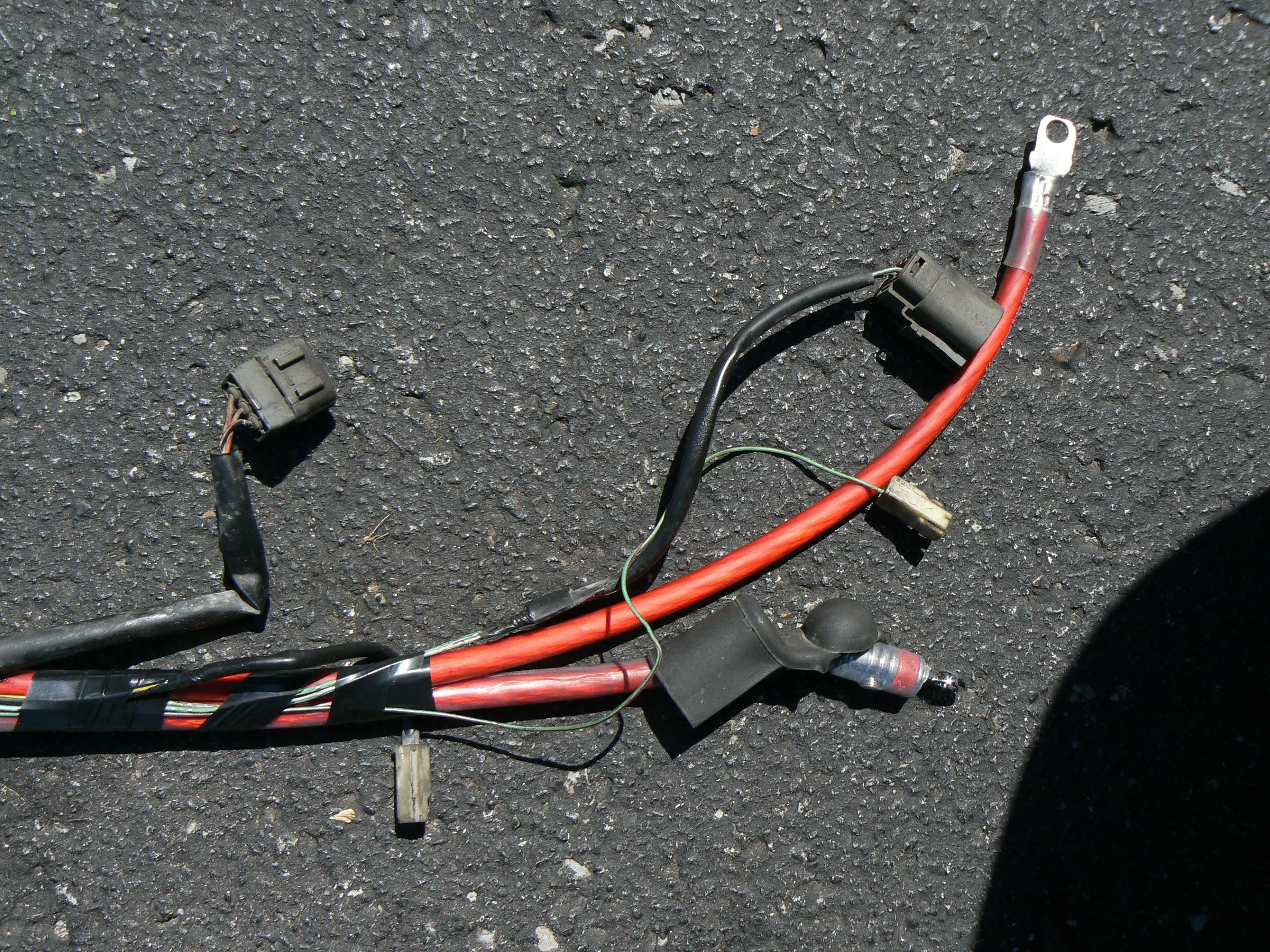

Replaced the last of my OEM engine wires. The Alternator Power Wire. The Transmission Ground Wire. The Starter Power Wire. Then re-wrapped them with the other ground and signal wires and ran them back thru the engine bay.
Today I used Knukonceptz 4ga Flex wire, Red for power and trans-Black for ground. Also used Stinger 4ga wire terminals. Wrapped the trans ground in wirecare techFlex and shrinkwrap, Wrapped the Alternator/Starter wires in electTape, wire loom then TechFlex. Lots of fun! Looks Clean. See before and after pics.
Pic#1 is the wires to be replaced
Pic#2 alternator power side, stinger terminal, before
Pic#3 the starter, before install
Pic#4 wire comparison new vs. OEM
Pic#5 Trans ground, after, installed

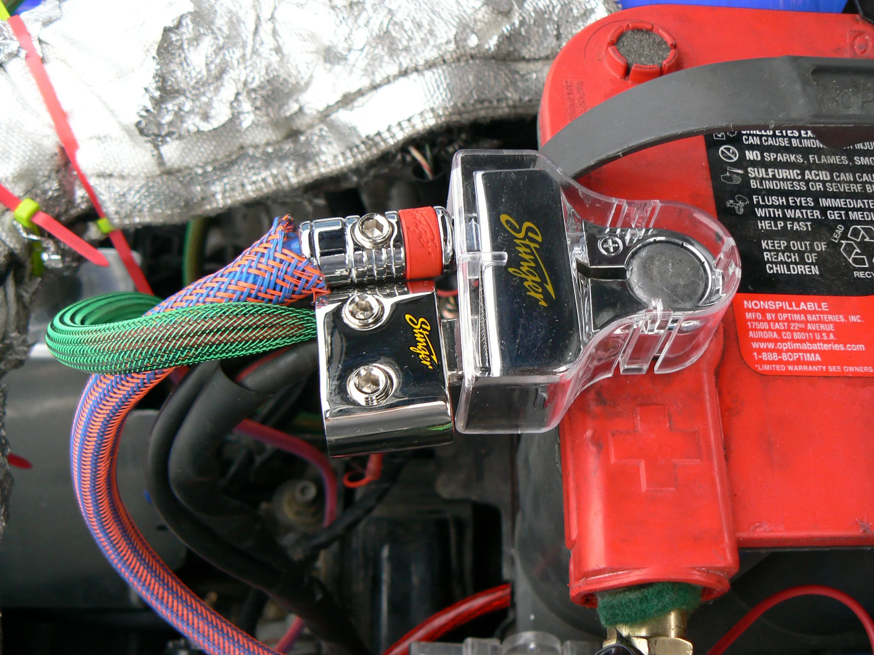

cont..
Pic#1 Up-close of New Trans ground
Pic#2 New wires wrapped
Pic#3 Alternator wire installed
Pic#4 Alternator from fuse box to Batt. installed
Pic#5 New wires fully wrapped & installed

ry, replacing wires is cool indeed, but why did you take this step?
I washed my whole engine bay in 55 degree weather so it never completely dried before i took off and my starter wire corroded, also I have large system and acc. and it would be nice to have all the juice I can pump to my batt that I can w/o doing any serious upgrades, see my sig.
