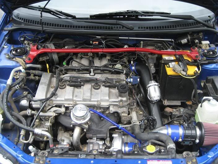

k, just got done installing the turbo and came across two brackets that I have no idea where I took it off from. If anyone is able to post some pictures on where they go......me, luv you long time (rockon). Here are the pictures of the bracket and my car. Yes, I know I need to clean my engine bay.
siiiiiccccckkkk
the one on the right in the pic you dont need, it attached the precat to the block
the one on the left goes where your external wastegate is so u dont need that either
how was the fitment on the hiboost mani? mine didnt really fit but i didnt really force it in there
EDIT: actually that bracket on the right attaches to the stock j pipe, dont really need it on there, its just for bracing
I know the one on the left is for the engine hoist. It's where you hook up the lift when you take the engine outta the car. Not sure what the other is though.
