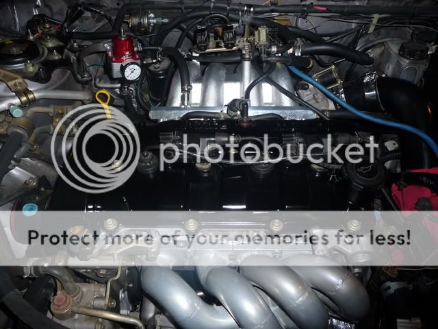

-repainted the 626 manifold
-replaced valve cover with nonmsp one (i like the lettering on there better)
-painted valve cover gloss black (i will eventually paint the letters red)

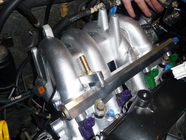

-installed perrin fuel rail
-replaced fuel rail inlet barb with a 3/8 inch barb
-installed MBXmotorsports fuel rail adapter with a 3/8 inch barb

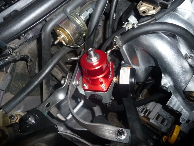

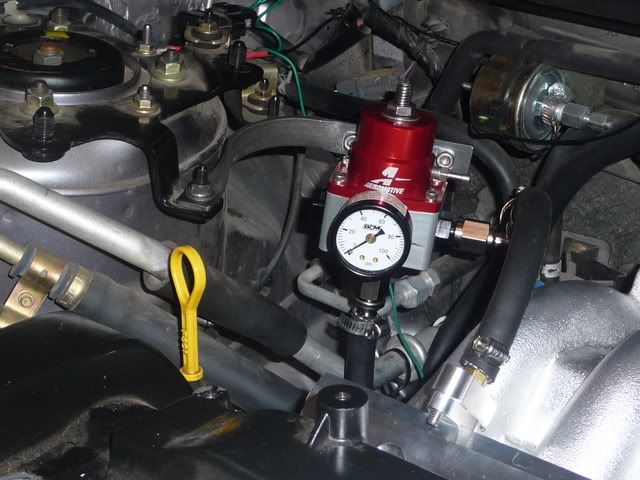

-installed the aeromotive A1000-6 rising rate fuel pressure regulator

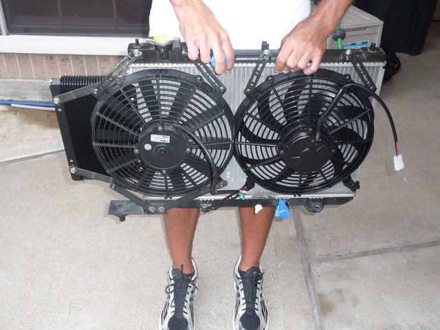

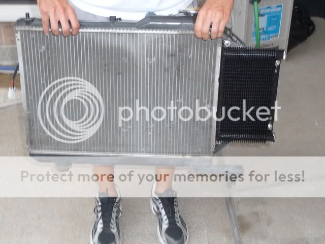

-mounted 1 high performance curved blade spal fan and 1 medium profile straight blade spal fan to the radiator
-mounted the NSN transmission cooler to the radiator assembly

^^^ The fuel rail is a tight fit with the 626 IM isn't it? I see you also did away with the braided steel line on the fuel rail as well. Might be something I'll do it mine turns out to be leaking from the crimp connection. Why the RRPFR though?
On another note I'm actually considering selling my MAM manifold and just waiting for terbow's...
What's the benefit of the RRPFR? I mean, I didn't think these cars had any problem keeping AFRs rich even with the stock FPR. I'd love to replace mine with something nice looking like that Aeromotive but I justy feel it'd be kind of unecessary and it'd make my car run even more rich.
for bolt-on msp, i dont think there is any point of a fpr upgrade.
however, i have so much invested in my msp, i think making sure i have full control of the fuel system is a must.
i upgraded the pump, lines, and rail, so why not have control of the regulator as well.
also, im pretty sure the stock fpr is rising rate as well (1:1).
nice fuel setup. i love aeromotive stuff.
thanks! one thing i dont like is that aeromotive (unlike many other companies) uses AN with oring fittings (not flare fittings) to screw directly into the regulator. it was hard finding the correct fittings and it did not help the wallet.
I think it would be if the PRC valve is bypassed but if it's still in place the PRC valve will vent excess boost pressure. Then again, I've never actually looked at my fuel pressure gauge while in boost (it's under the hood!) so I'm not positive. I was just curious as the Aeromotive certainly looks nice :)
EDIT: BTW, your injectors are backwards. Not that it probably matters but I'm fairly certain the FSM says the green injectors go over cylinders 1 and 2 :p
i really dont feel like searching, but i was pretty sure under boost it does rise. maybe someone else can chime in that also has a fp gauge.
haha, i didnt remember which went were. however, it doesnt matter at all. im limping the car around and staying way out of boost. i am running off a N/A protege ecu since i removed the hiboost kit with my extra injectors.
has anyone figured out why the stock injectors are 2 different colors/part numbers. they flow the same amount (im assuming) so i dont see why it would matter where they sit.
just curious...
