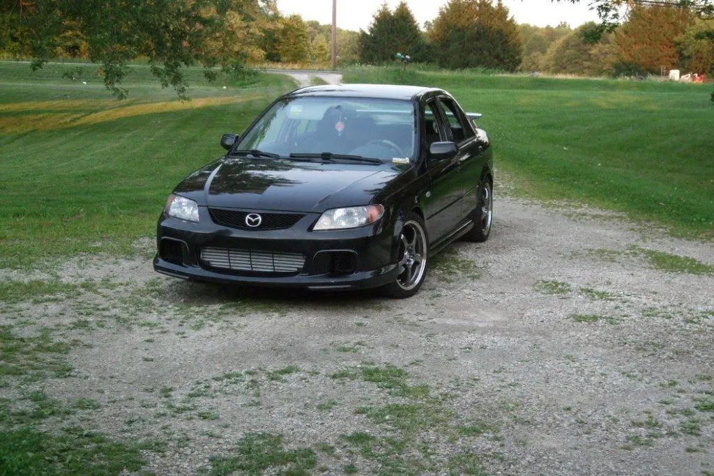

Not what I did today but over the weekend
