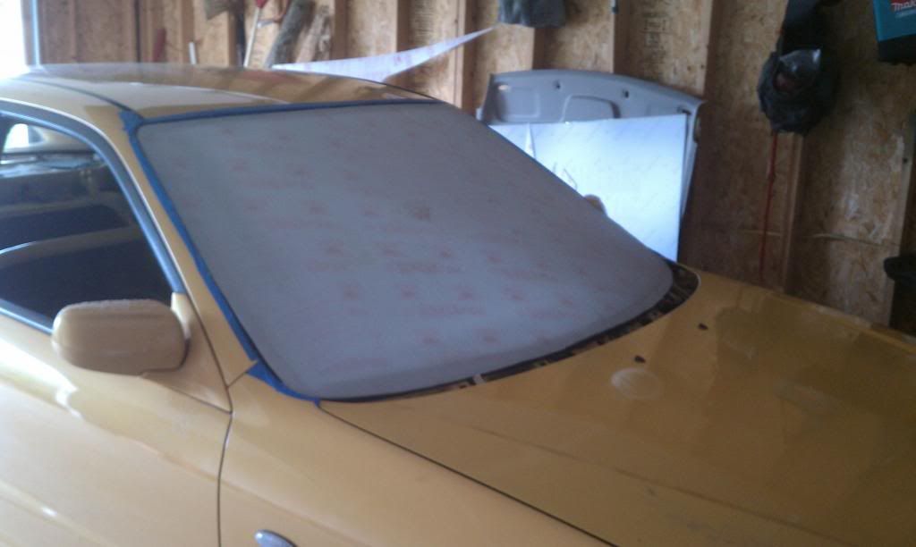

Cut out the front glass and made a polycarb window to shed weight. Took a lot of time and patience.

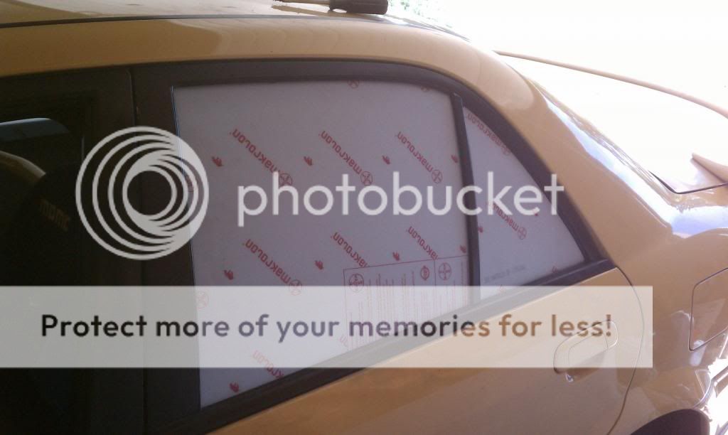

Also, removed the side glass and made polycarb replacements
