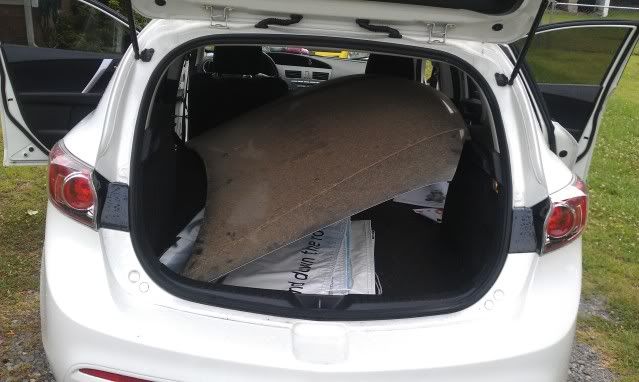

Found that a Oem hood will indeed fit in a 2010 mz3 so will probably be bringing ot to Ohio to pick up the hood....
it looks like we can slide the trunk in on the right side in a backwards L shape
That is what I was thinking. And I will be bringing towels for the edges I think and a blanket for protection as well.
