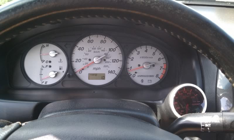

new cluster surround got off 323. love it!
