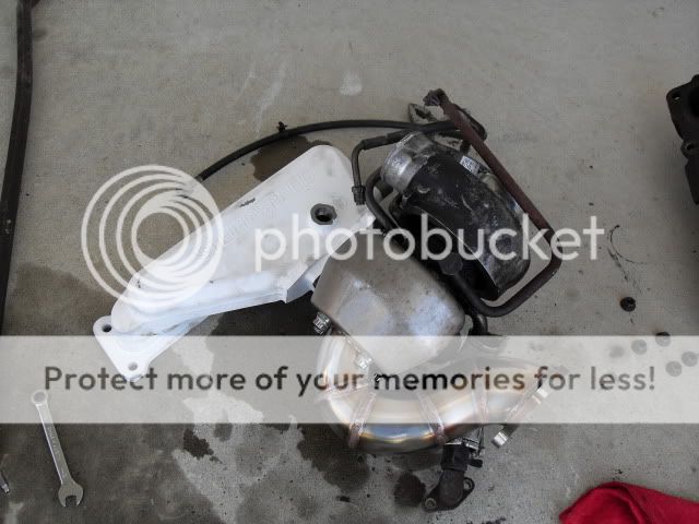

exhaust mani, turbo and dp out
everything apart
steedspeed, turbo and corksport s pipe
the ceramic paint start chipping off right away, little disapointed by that. On the the j pipe and reinstalling everything
Did you just disconnect the hoses from the block and remove eveeything together? That the easiest way to pull turbo/ mani?
