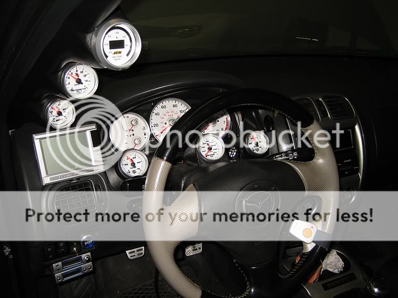

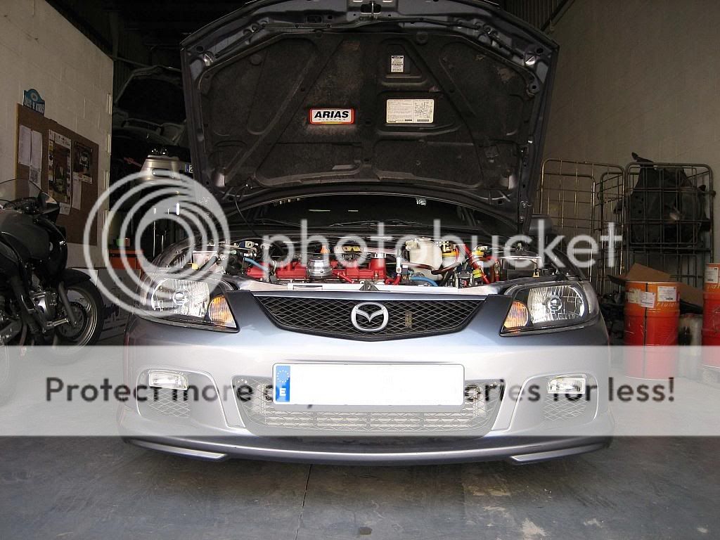

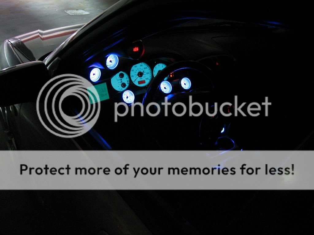

picture.php
picture.php
picture.php
Car Did on last dyno 474.8whp and 396.6wtq @ 25psiI on Meth... last year 2009.. This Year 2010 we are heading to the 600whp+ and 35 Psi of boost..
