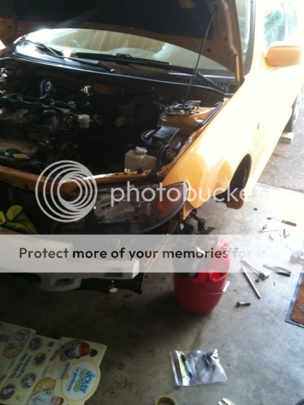

spent half the day pulling her appart to access the tranny.

took you half a day to pull apart everything to access the trans? Damn that just let me know i work on protege's wayyyyyyy to much ahaha

I was thinking the same thing. I can have the engine out and back in with trans in about 5-6

Pulling the engine bay stuff didnt take long really, but i spent some extra time on on the wheel assembly so i didnt **** it up. i have never done anything like this before on a car.
I mean, its not rocket science, but no need to rush and **** somthing up.
of course, i did get the bumper off in like 5 minutes. done that enough times heh. should have left it off when i did my hid ballast relocation and wiring though cause its still kind of a pia.

i hear you man i meant know disrespect. it just gave me a good laugh thinking about how many times I've worked on protege's and how fast I've gotten at breaking them down and putting them back together. s*** i dont even bother separating bolts anymore since i pretty much can tell where a bolt goes by looking at it haha.

Yes no disrespect at all Valk. We all crawled before we walked. It ins not really something to brag on my part having to swap it out soo much. LOL. Just have more time under the hood.

question.... the bolts to drain and fill the tranny fluid are... both.. on the bottom? so i guess i have to refill this thing when the tranny is out? =(
