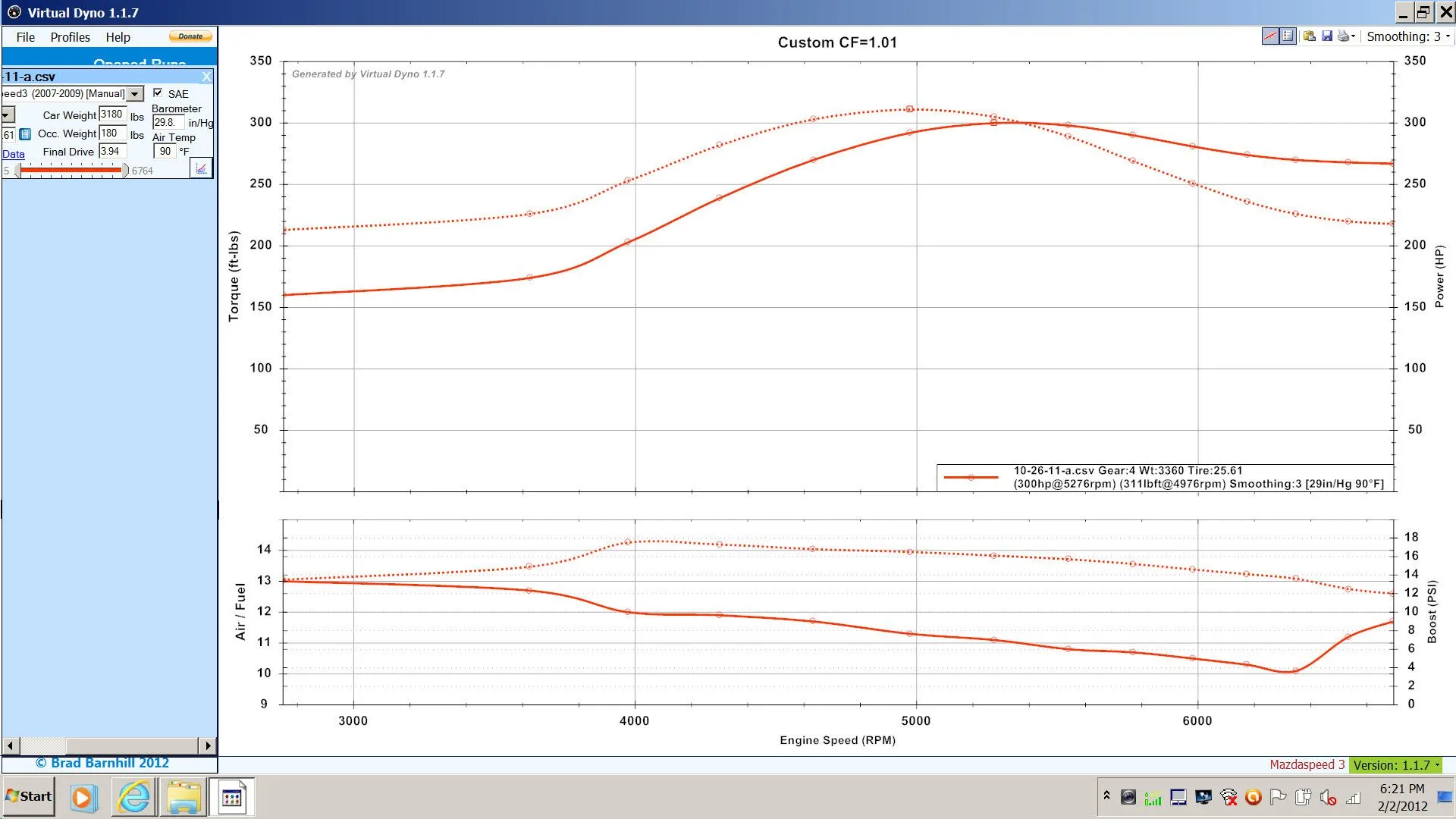

My first ever virtual dyno. Two runs done on the flattest road I could find going opposite way on 2nd run. Smoothing 3, correction factor 1.01.
Very nice numbers. And no, I disagree with the poster who suggests you need MAF cal or AP. HT has very accurate MAF cal with proper intake choice. Those of us who data log and run HT know that. We also know that AP is not likely to get a similarly modded car over 300 whp.
Here below is one of my VD charts made with HT and mods below. Note that this is also 1.01 correction factor which is way more conservative than DynoJet correction. I think Fishdonotbounce's performance and mine are quite similar and would put them up against any "MAF corrected" AP tune with similar mods and fuel.

i was adding timing between runs, at 18 degrees i started seeing some KR and backed it down a degree
Thanks, fish. You've got that car running very well. I think I have more mods (dp/rp) but once you reach a certain point in the tune, the K04 is just not going to make more power on pump gas by slapping on more mods or trying to "improve" the tune. I think I'm probably there and have no plans to go "big turbo."

Nice! Very cool weather, though. Almost 40 degrees cooler than I'm used to. Stock K04? Chassis dyno, too! Do your VD charts correlate closely? I'm impressed.
stock k04 (my 3rd)
during the summer months i throw in a gallon of e85 to keep the knock at bay
havent done a vdyno in ages
I actually have a full DP, catless. I'm going to do some more logs and run the virtual dyno to see how repeatable my numbers are. I think my first numbers are in the ball park and they might be right on the money, but I will not be convinced until I do more runs and do a side by side comparison.
