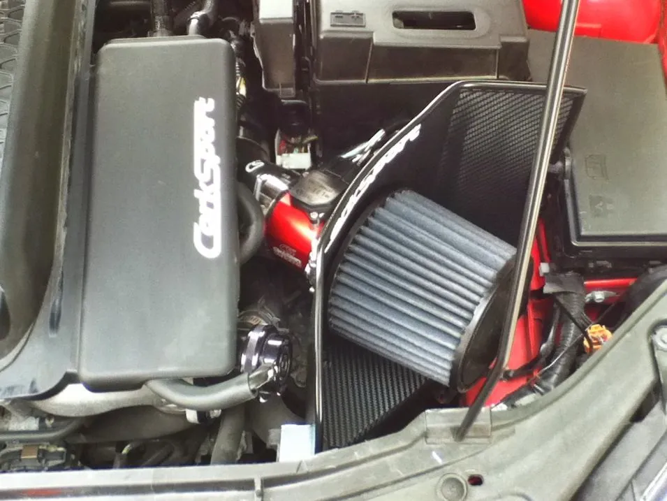

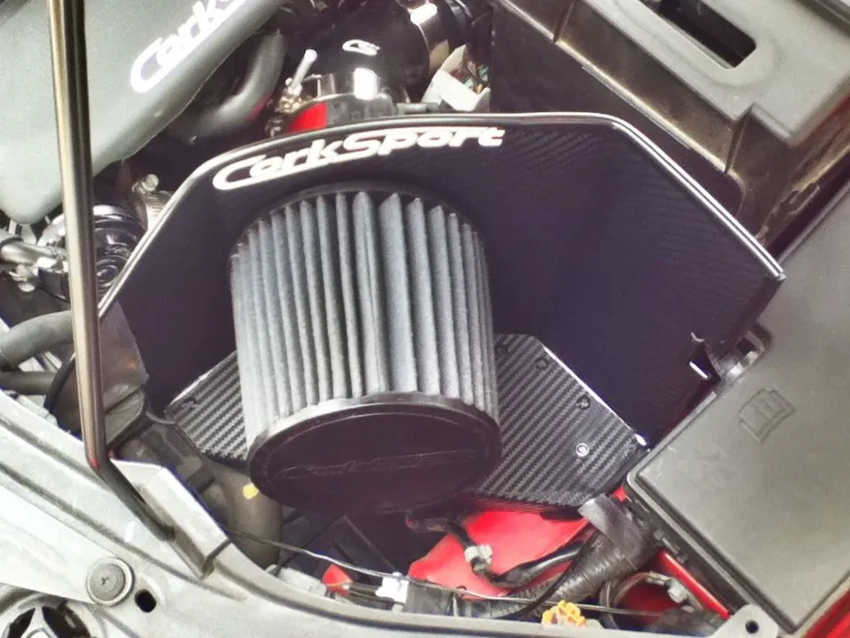

So i thought i would try my hand at making a SRI heat shield. so i did a rough fit with some card board once i got the fit right i transfered it onto the sheat metal i had laying around and cut it out, formed the angles, drilled and riveted the bottom piece on. pictures show it installed. i wrapped the metal with some 3m Di-Noc and wrapped all the sharp edge with some door saver molding, i think it came out pretty good. best part is that ive noticed about a 6-8 degree cooler reading with my dashhawk on the intake temp. all from stuff i had laying around the garage.

^^ nice work on the heat shield. gains or no gains it looks really good.

^^ yeah thanks guys, the work probably took about 2-3 hours and it really was not that hard, anybody could do it i think, and it makes for a nice DIY project with good results.
i actually also have plans to maybe put a high cfm fan in the bottom of the intake shield to draw air in from the bottom, i have a few fans off of some computers laying around that will fit great............. ill have it switched inside the cabin. just an idea right now though, not sure its really worth doing but it could be cool.
I think you'd be better off trying to fabricate the ductwork than putting in a fan. The fan would probably only be worth it when your sitting at a light, and who needs power at a standstill?
The intake is probably making wayyyy more vacuum inside that box than any computer fan could ever equal out
^^ YEAH, thats kinda what i was thinking, the vacuum on the intake is more than any fan i could come up with. ill take a look into fabing the duct work instead...... thats a better idea.
Doing a quick poke through on the internet I found that you need to flow around 1.5CFM to give your engine 1hp (this is vague and can vary widely). You would need around 400CFM to keep your engine breathing right. I would definitely go with ducting if I was going to do anything at all. No way a computer fan is even close to what you need.
^^^um...are you talking about providing the engine with air or just the intake filter? Zoomzoom was talking about providing air outside the heat shield he made, but you sound like you thought the fan was meant to go in the intake plumbing
for sure guys, i was only looking to help direct air towards the air intake filter not put a fan in the plumbing works of the intake.
I was just pointing out that you'd need a fan that could flow a significant portion of the 400cfm of cold air to make an appreciable difference in hp. I know he didn't intend to have it plumbed into the actual intake.
