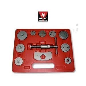

I've used this one, works well and is about $40. This one pushes as you turn.

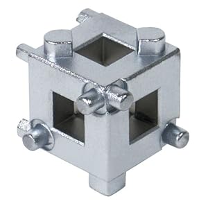

You can also try one like this. It should be less than $10 at any auto parts store. This one requires you to push as you turn. Scale of the pic is that those holes are 3/8" for your socket driver.
