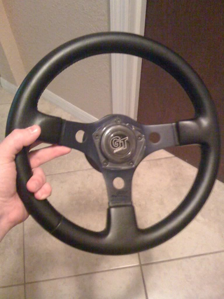

Now just gotta figure how to disable the airbag since i'm going to an aluminum 3 spoke w/o an airbag.
Kansei says don't install it, but, my current wheel looks like crap and i really am not worried about a Nardi or Momo wheel
Thoughts on this? It was free so i can't complain
